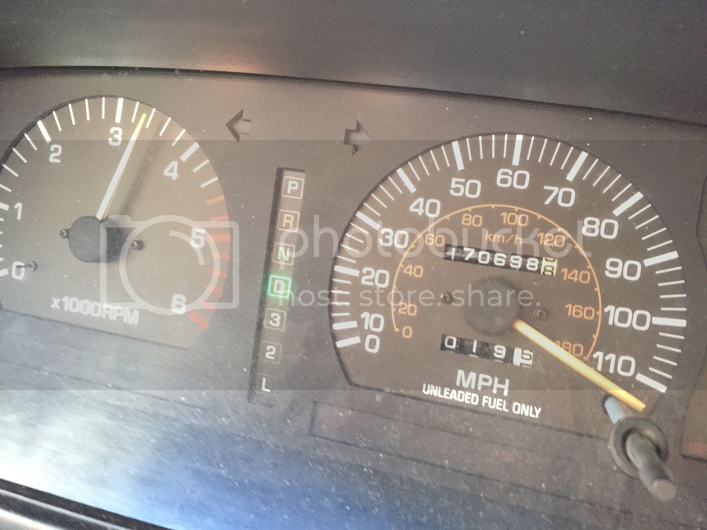

My truck has been running like crap lately and I knew that one of the cats was plugged up. The exhaust gasket in between the cats blew out and so I knew at least the rear one was done for. I took off the rear section of the exhaust and punched it out. Drove it to work this morning and it feels like a whole new vehicle! I was cruising effortlessly at 95 during a long stretch which it has never been able to do. Normally anything above 75-80 feels like it's having to work too hard to keep up that kind of speed. I figured it was because of the lift, 37s, armor, and roof rack weighing it down and/or causing so much drag.
So if your truck is feeling sluggish and you have original cats with 260k miles you should try punching them out or if you live where they're required then get them replaced. Took me all of an hour from start to finish.

Or the speedo cable broke, one of the two.
I was gonna say, I hope the passenger is taking that photo, and how did you mount the rocket to your roof?
You can get an 80 going 110.
It just has to be driven off a cliff first.
