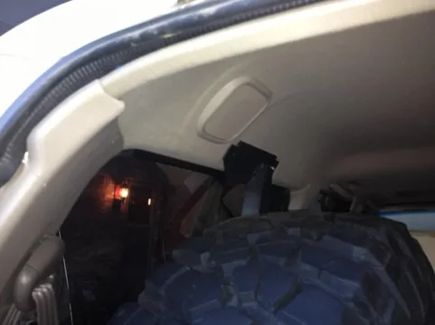

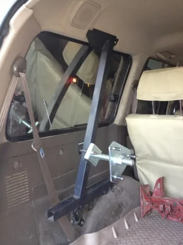

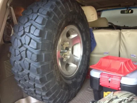

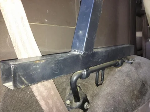

I did this:
"Spindle" is from Slee. Tire is a 315 BFG.

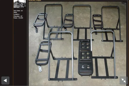

Thanks to all for the info on the spare tire relocation. Little Rock 80 came through with I would call a modular mount that looks to accommodate waters and fuel can that i think would make a good HAM radio mount.
If anyone knows who the manufacture of the Racks Little Rock 80 showed it'd be appreciated.
Follow the link in post #5 of this thread and you will find ToolsRUs is the man. John
