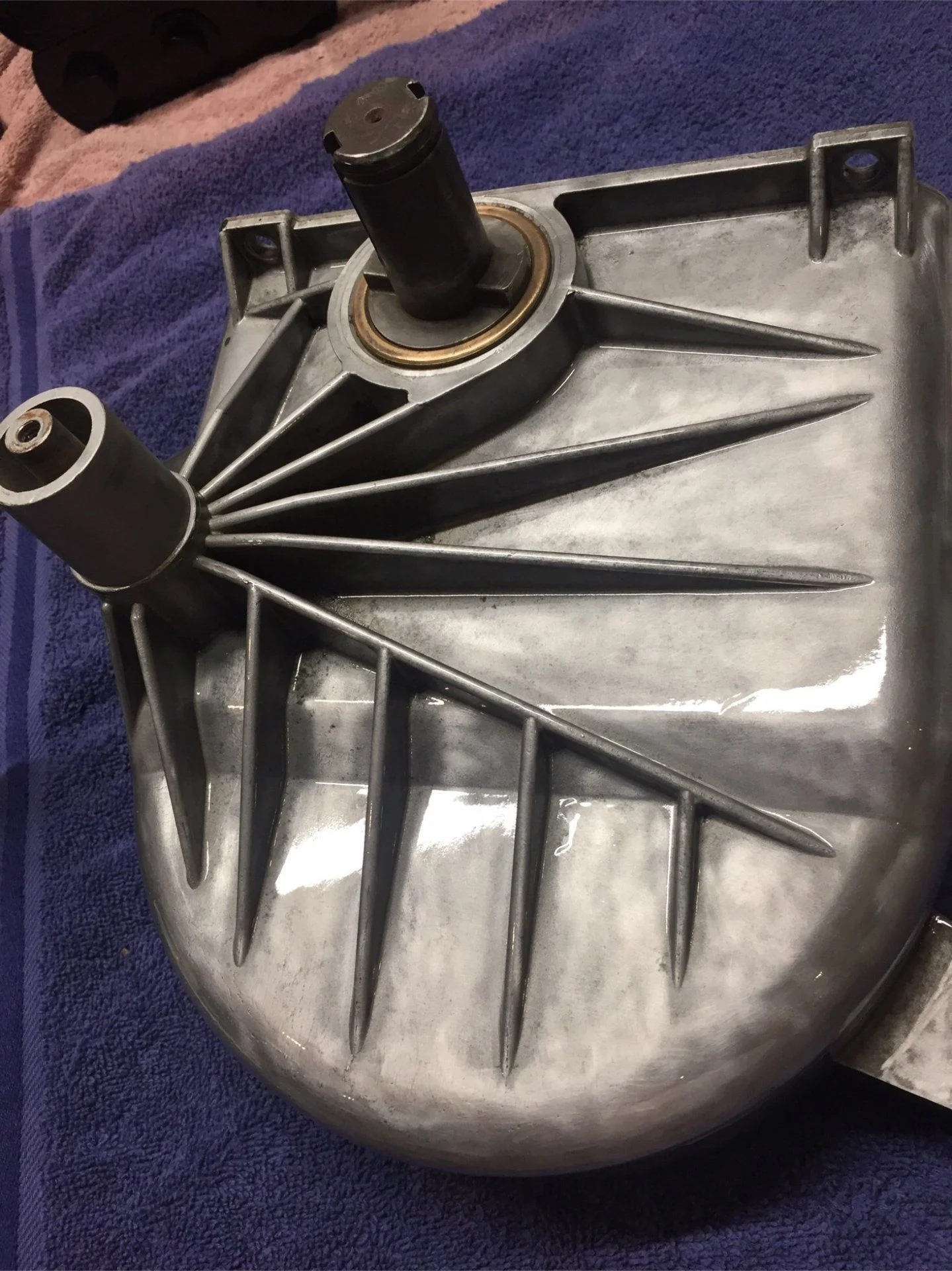

The other option would be to remove the primer and wetsand the aluminum until it looks nice. I like the aluminum look but realize it's not for everyone. Then coat the aluminum with clear 2k epoxy. I've been using the rattle can 2 part epoxy from spraymax. It is tough stuff and easy to apply. They state it has a very high gasoline and chemical restance, I haven't heat tested it yet though.
Here's an aluminum part I just coated. I was in a hurry so I didn't wetsand it though. Just used dremel ez-lock polishing buffs to get some of the dings out.

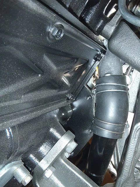

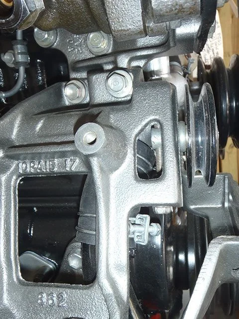

Here are some photos of the 3FE going in my '86 FJ60 project vehicle. Disregard the first photo, the exhaust manifolds were actually finished using EZ-Slide graphite paint, and the heat shields were simply cleaned and polished.

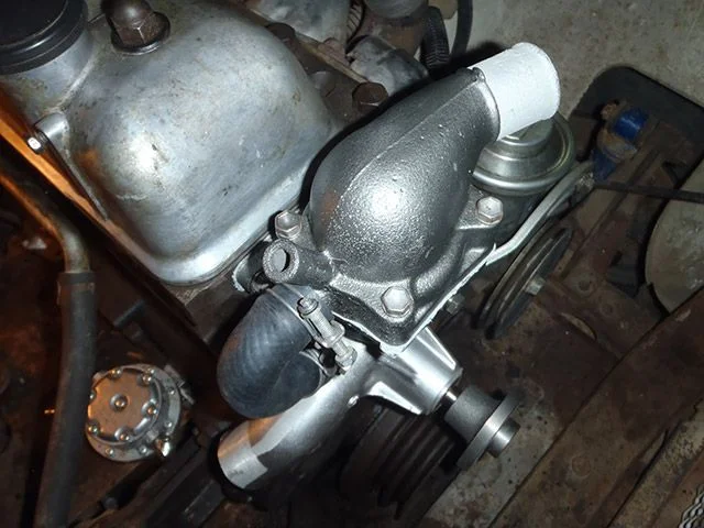

Here's a photo of my '76 FJ40 after installation of the water pump and thermostat housings I swapped out for my oil cooler installation. The thermostat housings were painted in VHT cast iron.
