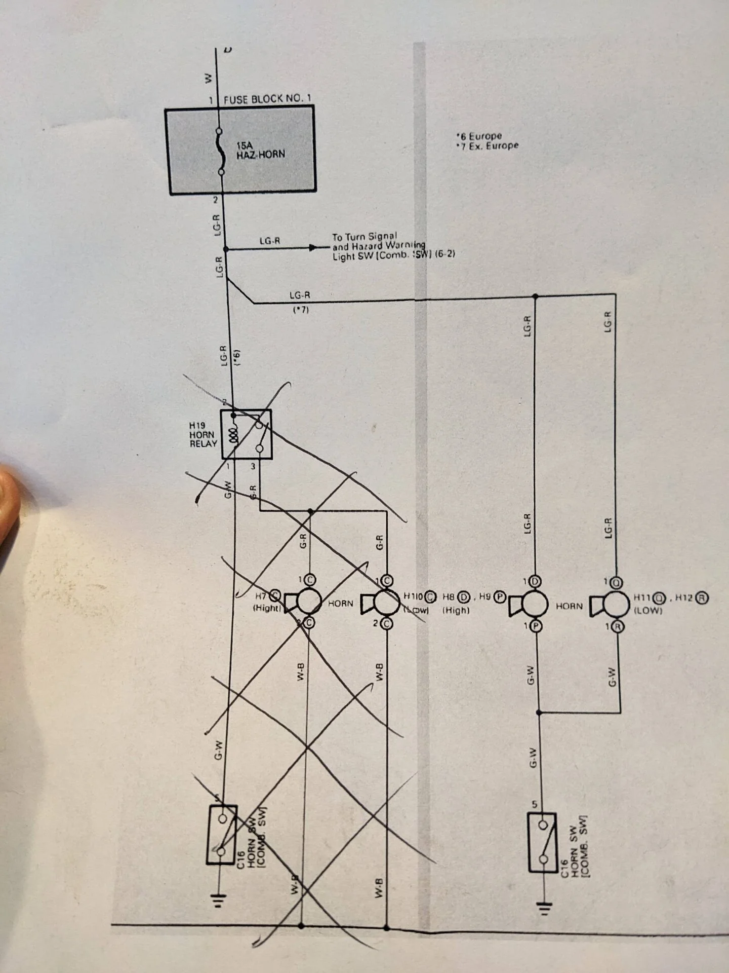

So... my horn issue has been resolved (DOH) but I learned a lot along the way.
1. In the end it appears that the issue was that one of the horns was "bad". Early on I had tested one to make sure it "beeped" but I didn't test the other one. Apparently the bad one was somehow causing both to fail... maybe it was shorting out the circuit (no fuses blew)... I dunno.

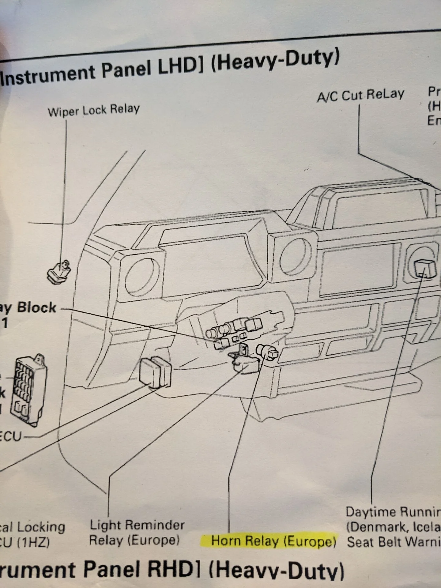

2. The EWD that I was using that said the (*7) series doesn't use a relay was incorrect for my particular truck. (I had XXX it out before I found this new info.)
3. I found another diagram that shows a "Horn Relay (Europe)". I DO have a horn relay!

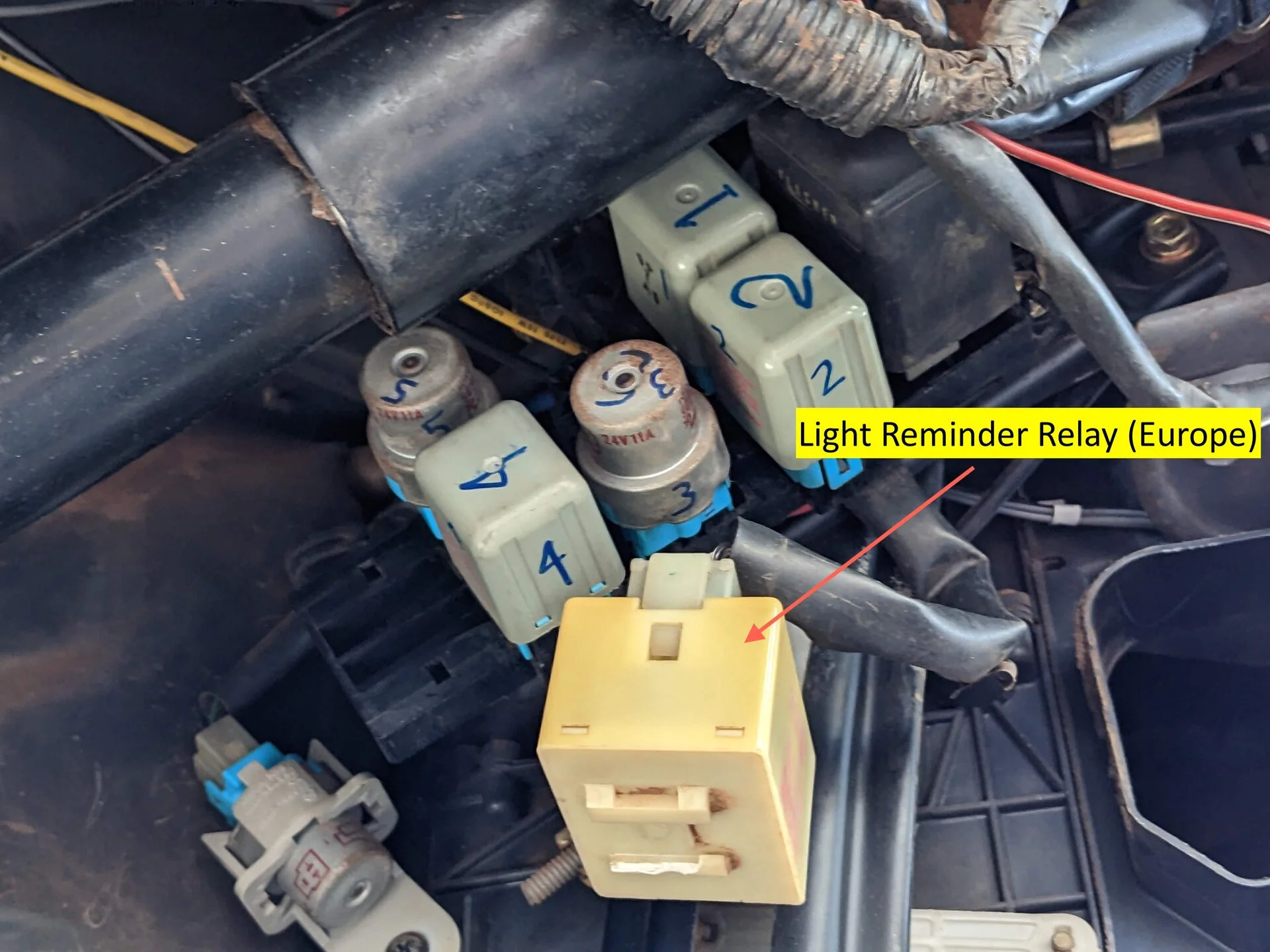

6. This gave me the opportunity to check and document the relays in Relay Block #1
7. I was reminded (pun intended) to figure out the "Light Reminder Relay"... to see what need to happen to make it work!
Regarding the horn relay: in the process of tracing the wiring to verify the horn button worked and that I have continuity out to he horn connector(s) I verified that the horn relay is in fact a horn relay. And I tested it to verify it is working properly.
