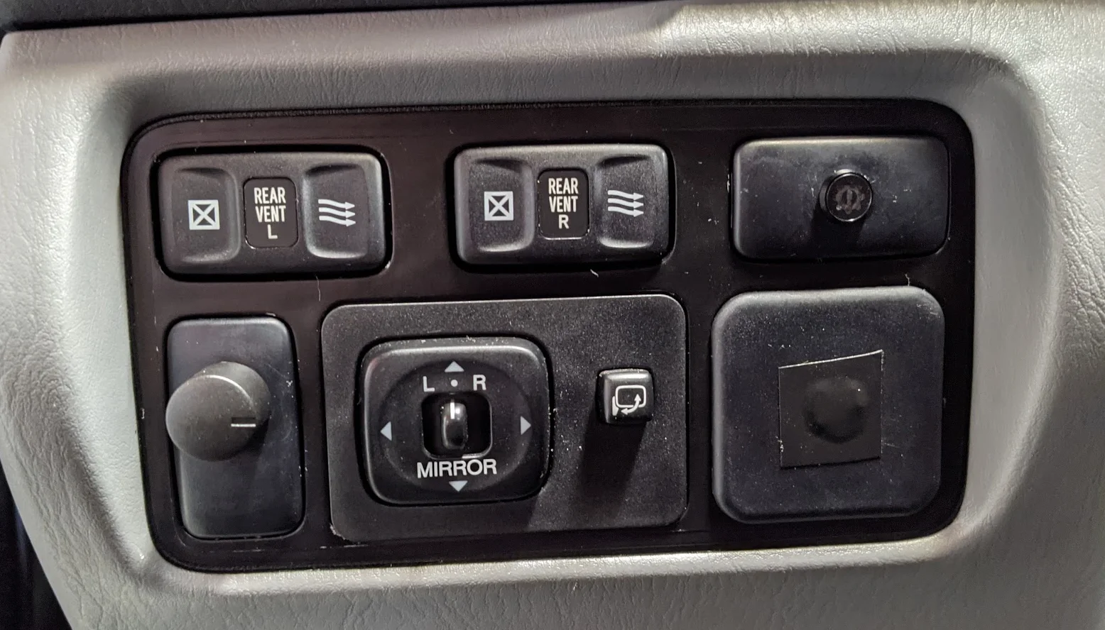

Just booked my install for this July. I have more questions about locker indicator lights. I don't have a rear locker indicator on my 01 LX cluster like the 98-99 LX's. I want to add a light on top of the 80's knob in the blank switch plate. I originally wanted 2 lights. One light for RR and a second light for FR-RR but @hoser had a good point, only one light is needed since the 80's switch doesn't let you control the front locker independently. Here are some lights that i've found that could be a good locker on indicator light.
LED Light only (no icon to keep it simple)
Amazon product ASIN B01AF5THFS
Gearbox Failure Light (it looks like a big gear)
Amazon product ASIN B082H29MLW
A Key Light (to show it's locked?)
Amazon.com: uxcell Pilot Dashboard Light DC 12V 8mm Red LED Signal Indicator Light Aluminum Shell with Symbol (Key): Industrial & Scientific - https://www.amazon.com/gp/product/B082H2RTXT
What do you guys think?

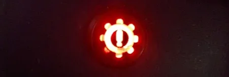

Decided on the Gearbox Failure light for my locker indicator. It just came in and I installed it. Also moved my subwoofer knob from where the 80's switch will go into the vertical blank spot on the left side. I originally wanted 2 indicator lights for the front/rear but thanks to @hoser recommending 1 is enough since the rear will be on either way, to just have one light wired to the rear.
Here's what it looks like when the locker(s) are activated.

@trdcorolla FYI, I have my compressor switch (and light) in that location and I can barely see it glow.
@flintknapper I've thought long and hard about that one but came to the conclusion the rotary locker switch is great. Easy to use and detect what position you are in, even when you are leaning over and feel like you are going to flop.

The indicator light isn't for me, it's for other people who'll drive the 100. It's easy to say don't touch these buttons/switches (center diff/locker knob) and make sure there are no lights here (pointing to the lower cluster) and make sure this light is OFF (pointing to the red light on top of the rotary knob).
