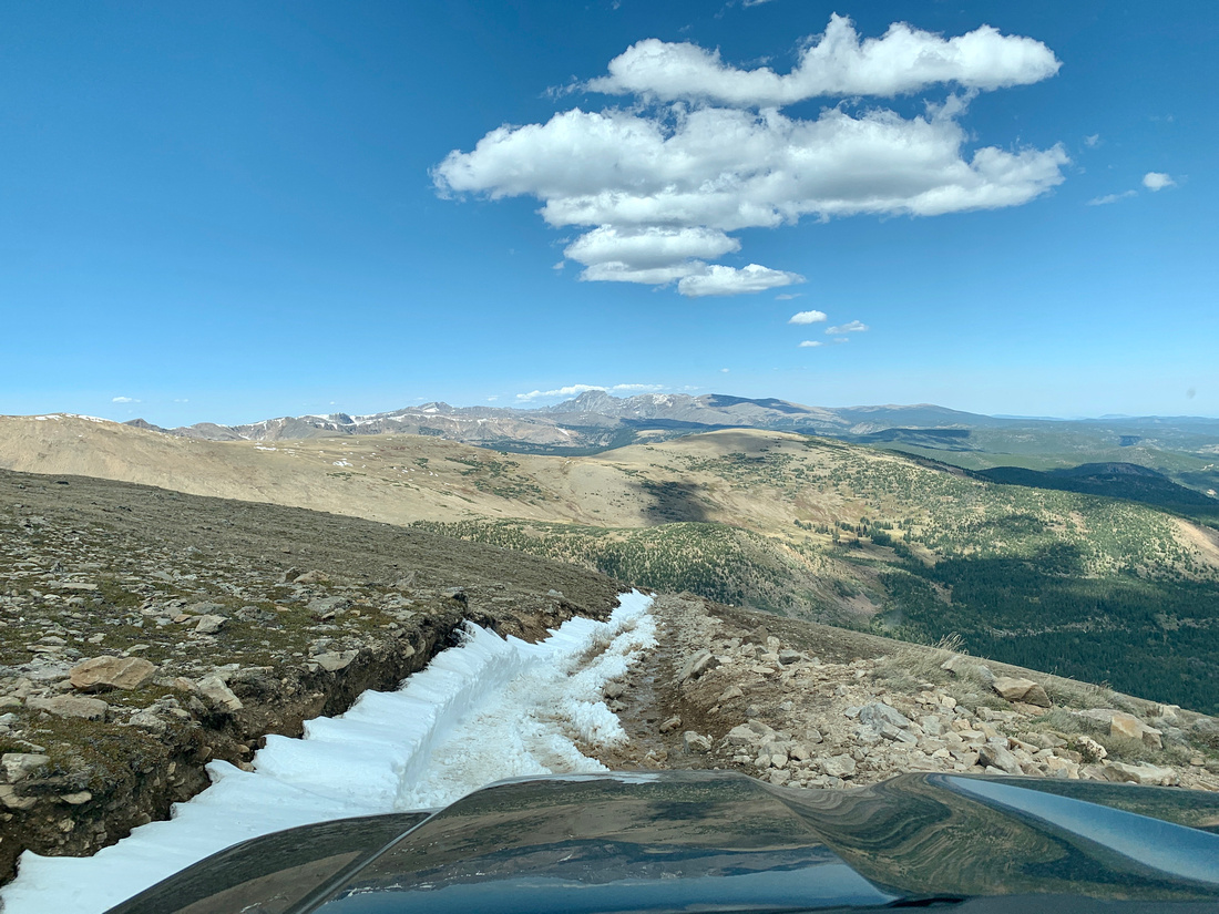

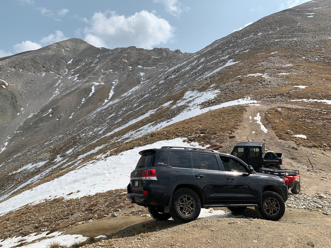

Still 3 weeks away from lockers but in the meantime, I've hit a couple of moderately harder trails such as Kingston Peak near Idaho Springs, Mount Antero near Buena Vista, and Saints John near Keystone. This has given me an opportunity to evaluate the vehicle's capabilities prior to getting lockers.
Mt Antero: Did not experience any traction issues until I reached the switchbacks where some snow from September 8th was still present. I was able to go through a few switchbacks but then got stuck in a precarious position with MTS trying to work but not being successful. I thought the combination of Nitto Exo grapplers tires (supposedly good in snow) and MTS would be enough but not so. Had to reverse back about 50 yards and that was not fun. Lockers would have definitely helped there. Without snow there I would not have experienced any issues going all the way to 13800ft.
Kingston Peak: I did this from the direction of Alice to Black Hawk and I did not experience any traction problems. However, there was still some snow there, and had I been driving in the opposite direction, I would most certainly experience tracking issues in this section. I think lockers would be very helpful here even without snow. Some sections before and after this point were very steep with gnarly deep ruts and snow made it worse.
Saints John: On this trail, I experienced the most amount of wheel slippage and MTS was working. It got me up without drama but it was working a lot. It's not only steep and rocky but also loose dirt. I did not have the guts to go to Radical Hill. I took a break at this spot. It does not represent the trail at all :) I was glad there was no snow left on this trail, otherwise it would've been a beast and I seriously doubt MTS would take me through it.
So the vehicle is very very capable even without lockers but I am looking forward to getting lockers.

Nice! Looks like a good time. What were you aired down on the various trails? It's hard to tell from the angles, but it doesn't seem like your sidewalls are bulging out very much. Were you using CRAWL or just MTS and driving through?
