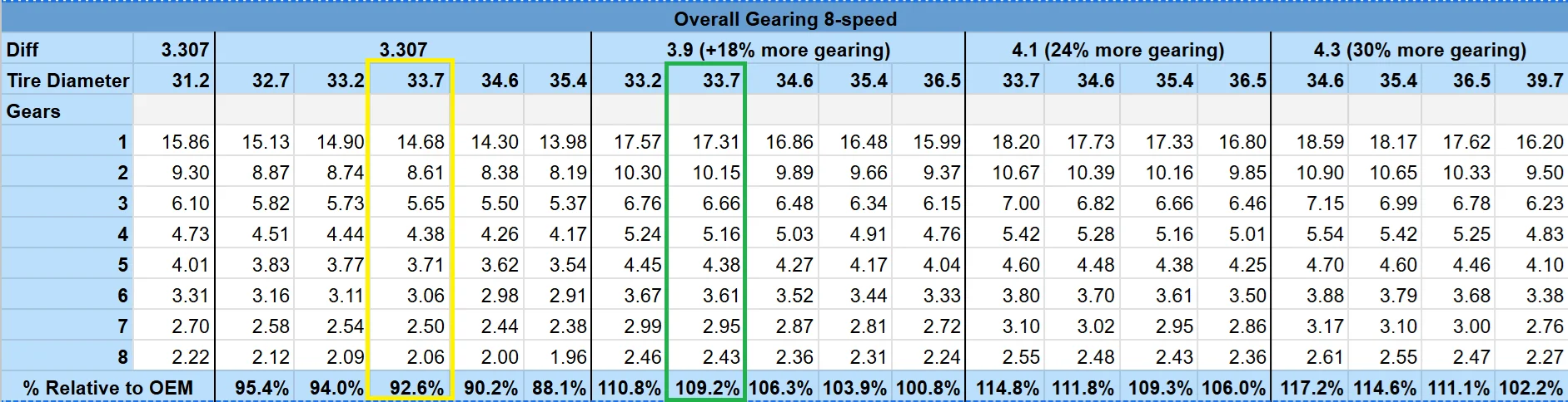

Using the above data and tables here to answer your questions. Short answer is you want 3.9s. It'll be a world of difference between your current setup (yellow) versus 3.9 gears (green) as an 18% overall gearing improvement. You currently have 7% worse gearing than stock baseline which accounts for a lot of the symptoms, whereas you'll have a 9% gearing advantage over stock baseline after regear. The bottom row of the table is key to understand how gearing is relative to OEM. Being as close to OEM as possibly will bring the best balance even for really big tires. 4.1 or 4.3s belong in the realm of rigs aiming for 37s and larger.
1. The power hole will all but disappear as you'll have about 800rpm/40hp more at that same point.
2. With more gearing and torque to the wheels while using the upper gears, it'll have a better chance to lock the converter
3. At 75mph and 6th gear or about 2500rpm, the 5.7L makes less than 140hp. After regear at the same speed will put the engine at 2950rpm with better potential around 175hp, where it's much more likely you can stay in 6th.
4. Yes, much better braking which I almost find more important for heavy towing!
It'll do everything you do now, better. In addition to the power and gearing improvements, shift logic should be appreciably better.

Thanks for the detailed write up and spreadsheet. The numbers are plain as day and don’t lie.
I think it’s time, Santa is coming early this year.

Great chart! Now...is there a general consensus on what = too MUCH gearing? 32.7s aren't on the part for 3.9s, but it's easy enough to extrapolate. Negating tire/wheel weight and such (just way too many variables), when is it too much? I suppose one's use case would factor into it (e.g. primarily long slogs on interstates vs. slow dirt), but paralysis by analysis is real...at least for me. :hmm:
I think use case is big deciding factor here.
The one thing that bothered me with bigger tires at highway cruise was the constant shifting.
I'd agree there are factors that will drive gearing. But desirable overall gearing will generally be closer to stock than dramatic changes. For example, the Tundra tow package changed factory gearing from 4.1s to 4.3s, or only a 6% change. F150s change from 3.55s to 3.73s, a 5% change.
Obviously, one should correct for tire size. And potentially for factors like installed weight, aero loads with armor and roof racks, elevation, and more specific use cases.
When going from factory 3.307 to 3.9s, it's a huge 18% change. That's enough to take care of most mainstream tire sizes with plenty of additional margin.
