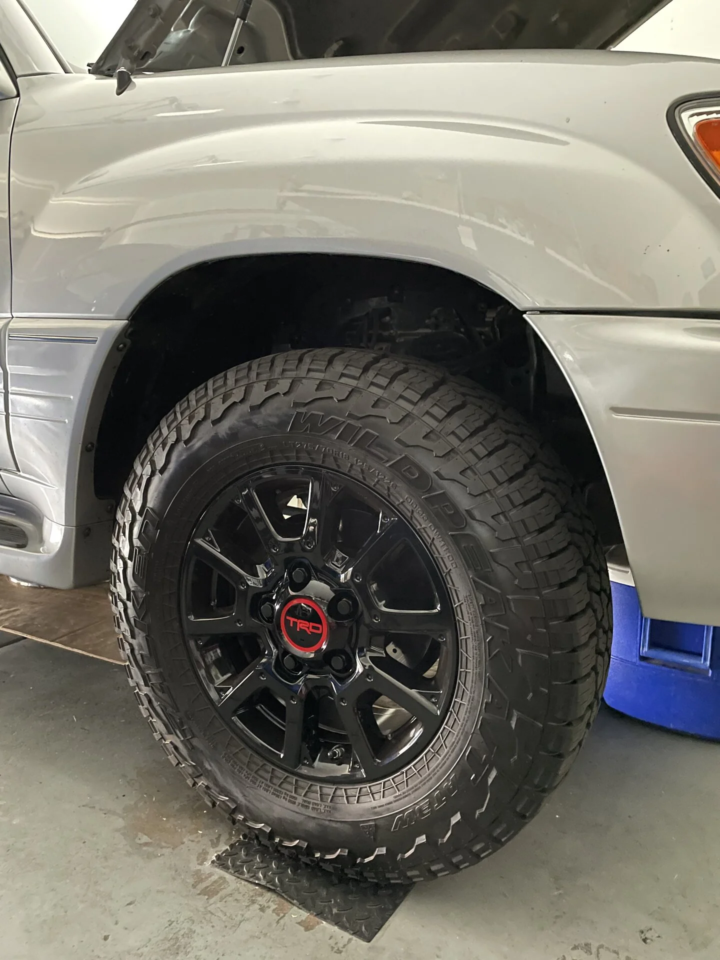

I used a powder coating facility that was recommended by my tire shop. Very please with the results but the cost was $150/wheel (I did all 5 wheels) so not a cheap option.
@KMac100 very nice, exactly what I want to do with mine! For $150 did you leave your LX with them or did you have to remove them from the car and the tires? Curious what their process was - did they strip them down to the metal first? What color/finish did you get? Looks like it's a perfect match for the center caps.
Dropped the truck off at the tire shop in the morning. Wheels were removed & sent to Powder Coat shop. Wheels sent back to tire shop the following morning where new tires where installed. Picked up truck 36 hours after I dropped it off with everything handled by the guys at Tirelink.
They were sandblasted to bare metal. The center caps were not original (chrome) so they painted those as well.
