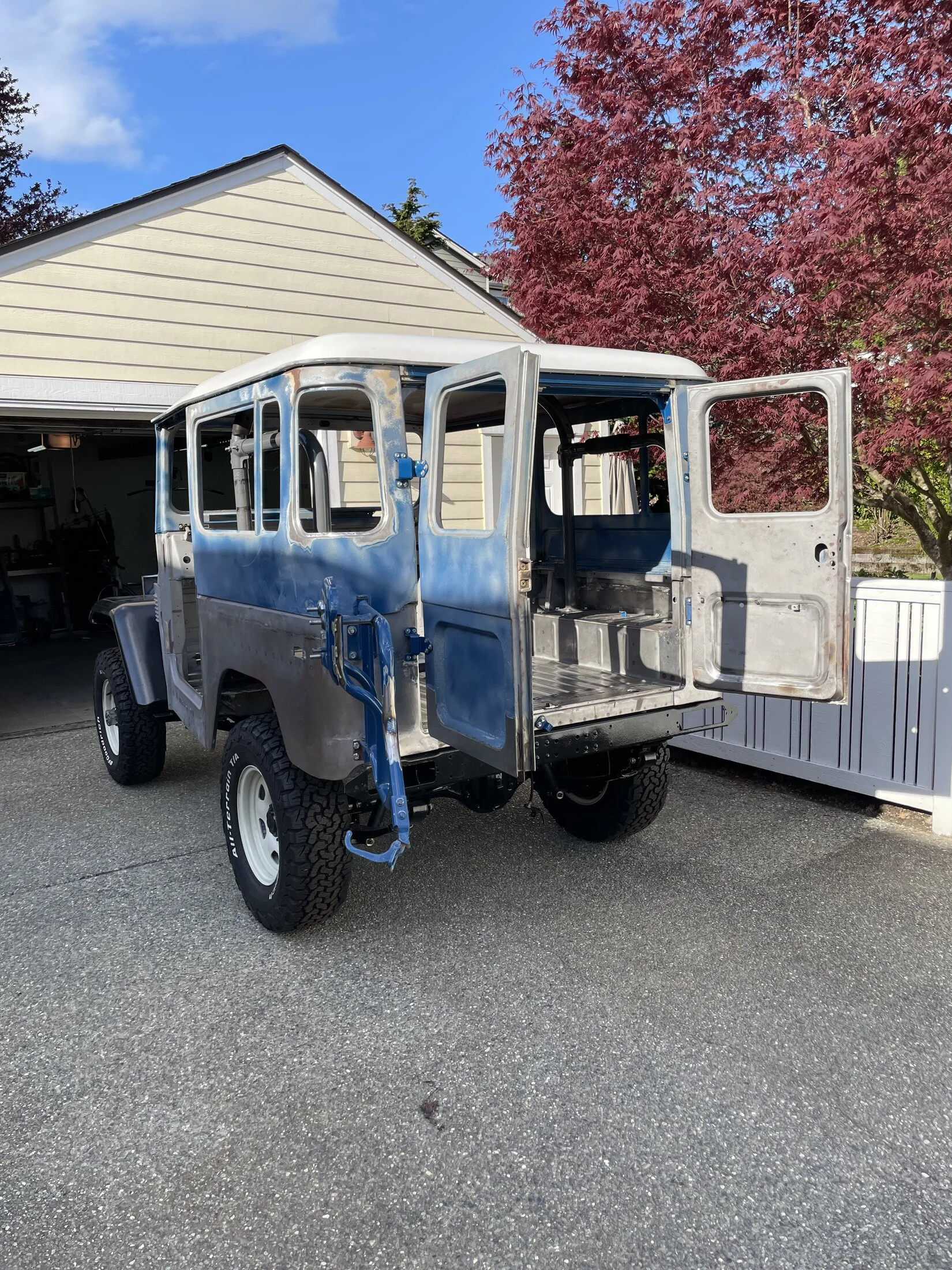

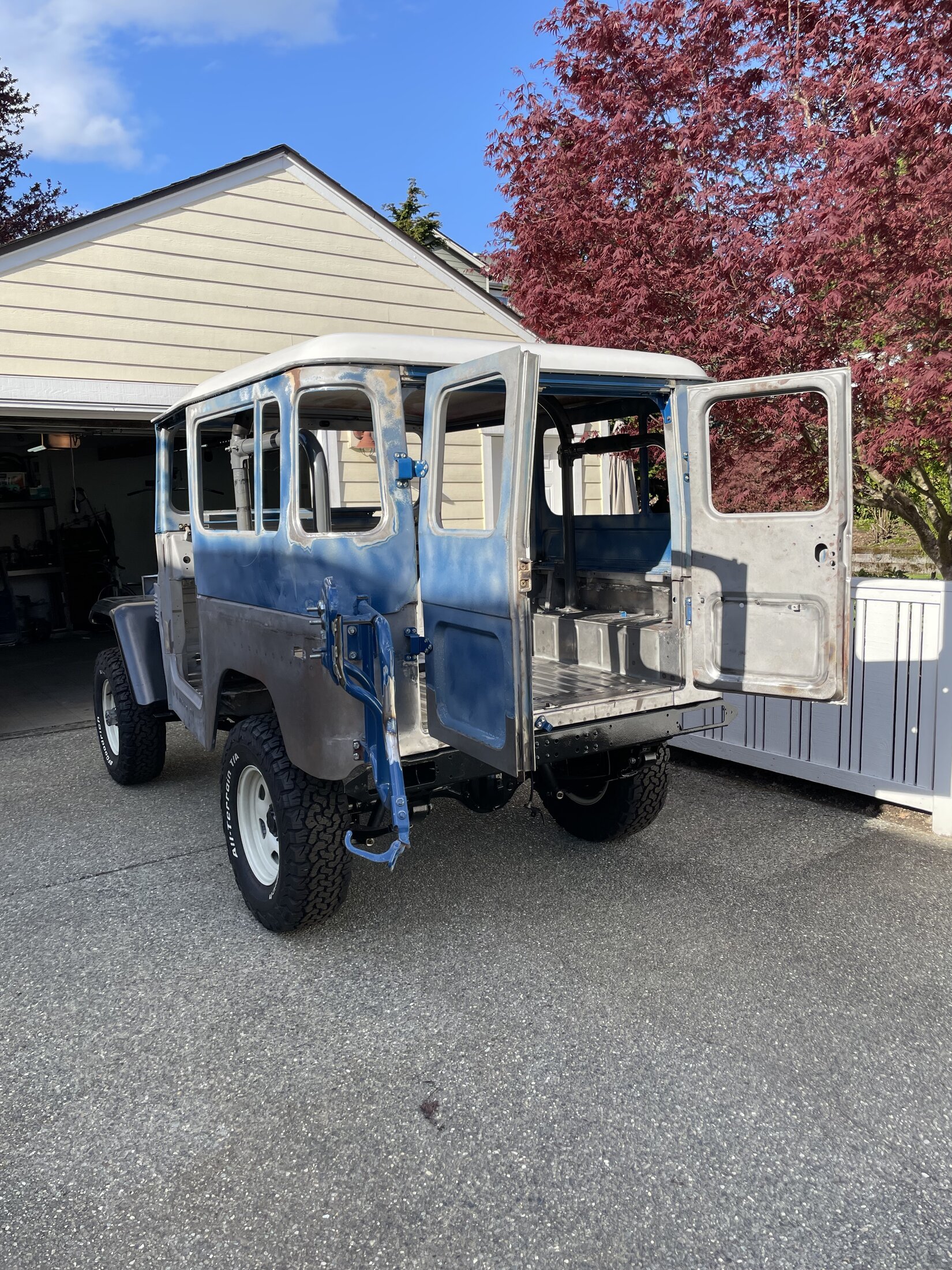

I can absolutely do the tear down. It’s all test fit assembled now. This place won’t allow me to do the prep. It’s all or nothing with them because they want to control the process. I don’t fault them for that. I’d do the same thing if I were them, they should want to do their own prep and primer. As for negotiating. Not gonna happen. They are booked way way out and are turning work away so there’s no way they will drop their price for me. Thanks for the reply!
Here are some picsView attachment 3896709View attachment 3896710

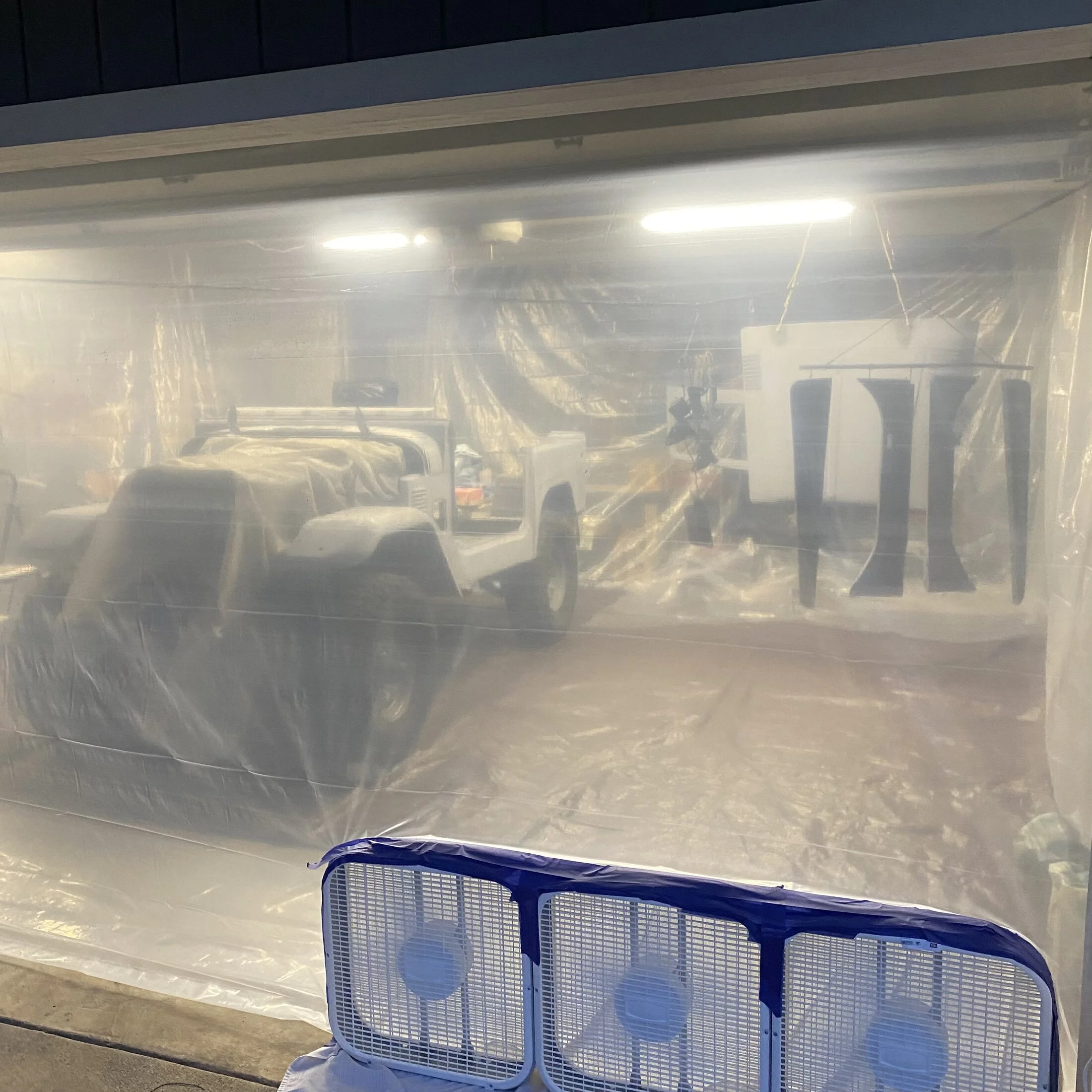

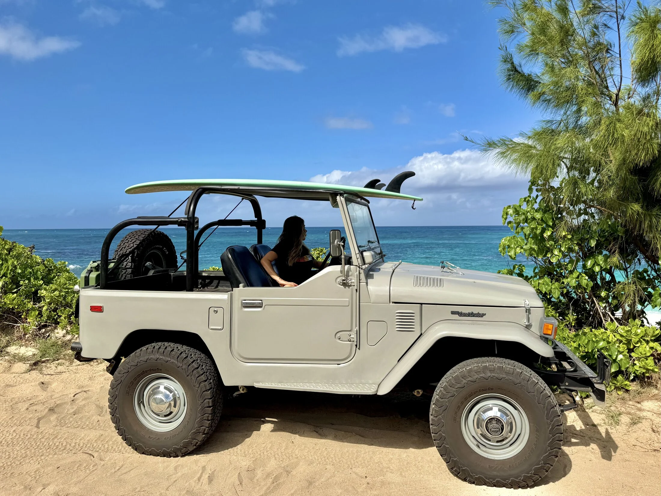

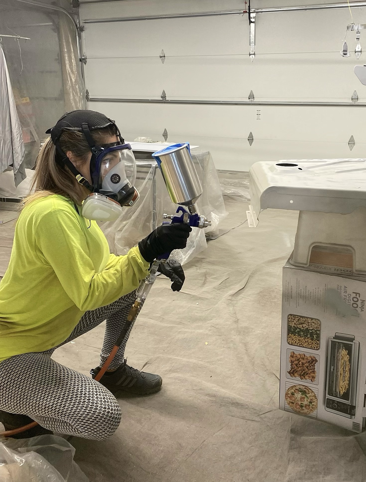

We painted our ‘75 fj40 in our garage. 3 fans from Walmart to exhaust the garage and a bedsheet on the back door to draw in air from. Bought a medium sized compressor from Home Depot, gun and matériels from Amazon and went for it. Turned out great for a fun beach cruiser around my little town here in the north shore of Oahu. I want to say we spent less the $900 dollars on everything, and we have all the tools to paint our other 40 someday soon. Ours is also Dune beige as well! I say go for it.
We even wet sanded (endless wet sanding) in our driveway then cut/buffed it. It’s not going to win any paint competitions, but I got to have a go at a new skill for the first time and have a huge sense of accomplishment with it now.
Did I just get called out by Jen?!?! Yup, now I’m on the hook to do it myself.
Thanks for the recommendation and your 40 looks amazing! Great job. How many hours would you say to took?
Yea +1 spray it yourself, it is a Land Cruiser not a Ferrari. Some 2x4 and clear plastic, a box fan or two with furnace filters primed with Endust its paint booth. Don't skimp on PPE. Get some cheap paint, and practice spraying on scrap stuff to get a feel for your gun.

So easy a girl can do it! Just kidding, Its a lot of work and I only helped with it…only about 10% of the metal work/rust repair and bodywork, and about 20% of the prep and final paint. So not much, but it was a good learning experience. You need to prepare yourself for a lot of work, especially in the body work and prep stage, but it’s doable. Hard to say how much time we had into it, as we work pretty slow and are watching YouTube tutorials during the process on everything since we are amateurs, but we probably had 40-50 hours in to it spread out over a few weekends. I think it’s worth trying yourself, $150 an hour for a shop to do is insane, plus it’s way more fun to suffer a little and put your own paint signature on it!
And, reassembling after paint is the funnest part, so satisfying seeing it all come together.
Just remember wipe down everything before final paint color(obsessively) as it saves you work in the end, turn off gas or disconnect power from water heater if doing it in your garage while painting…it gets pretty fumey in your homemade paint booth and you don’t want any sparks to cause any dangerous situations.
