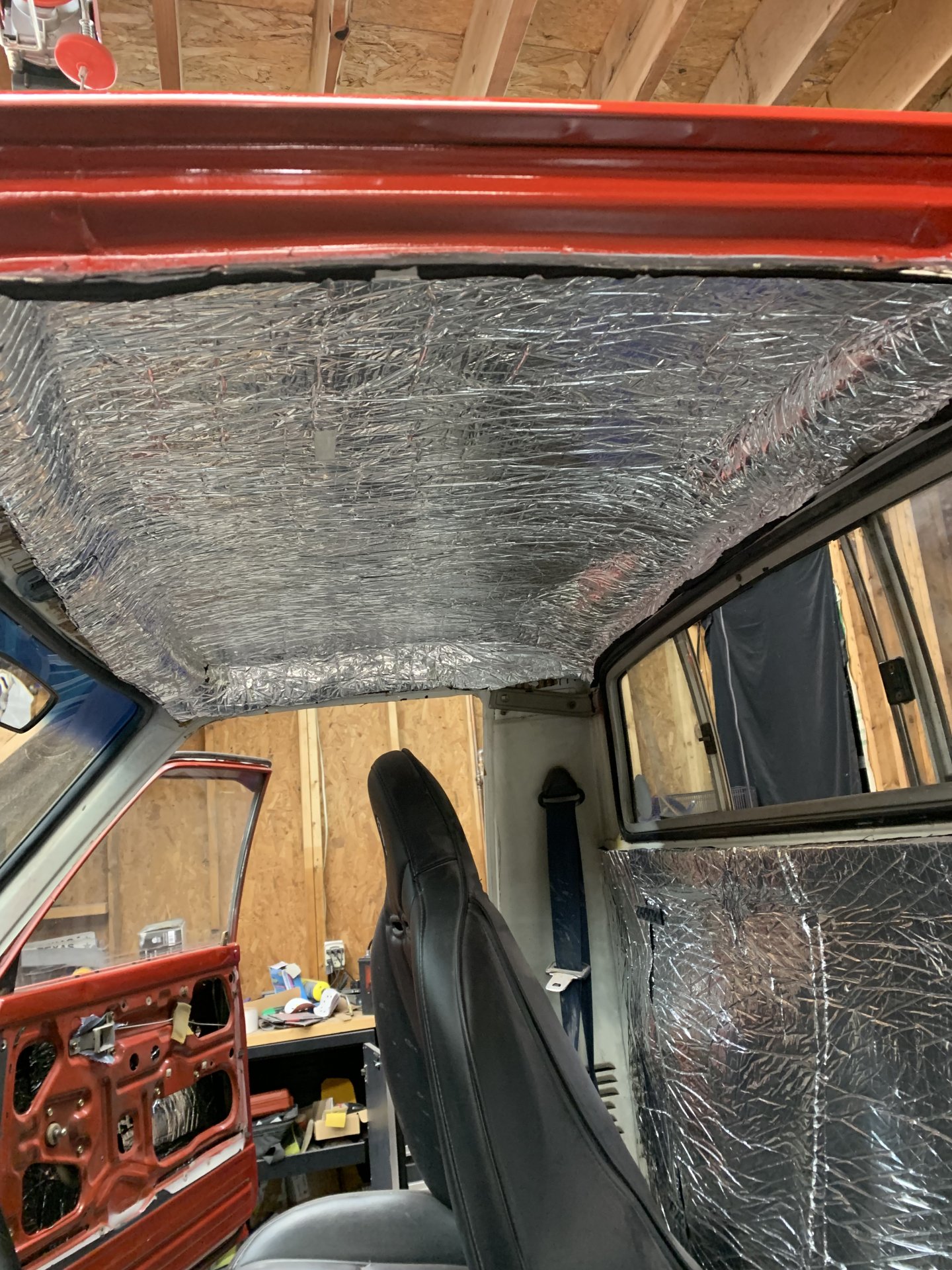

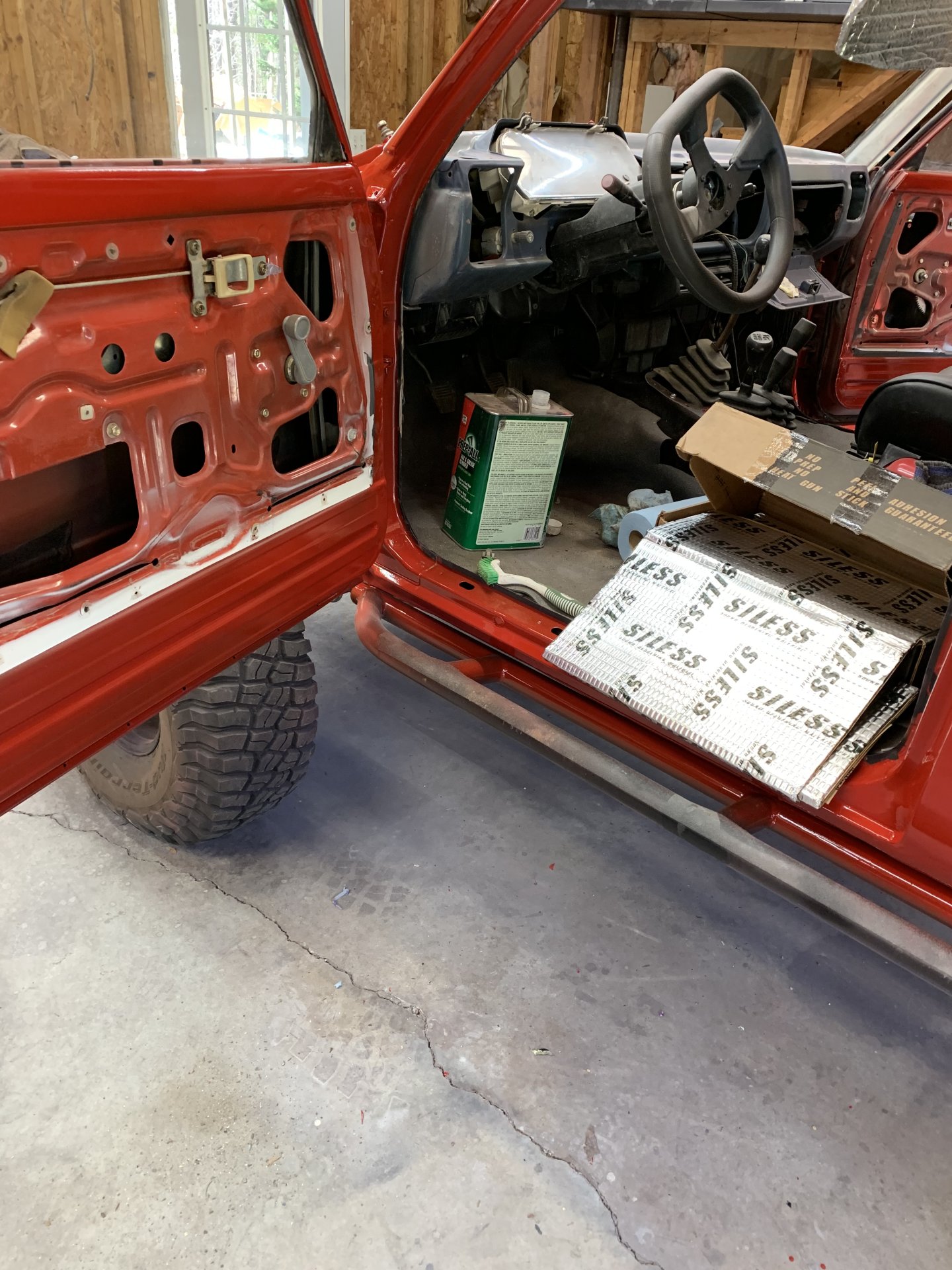

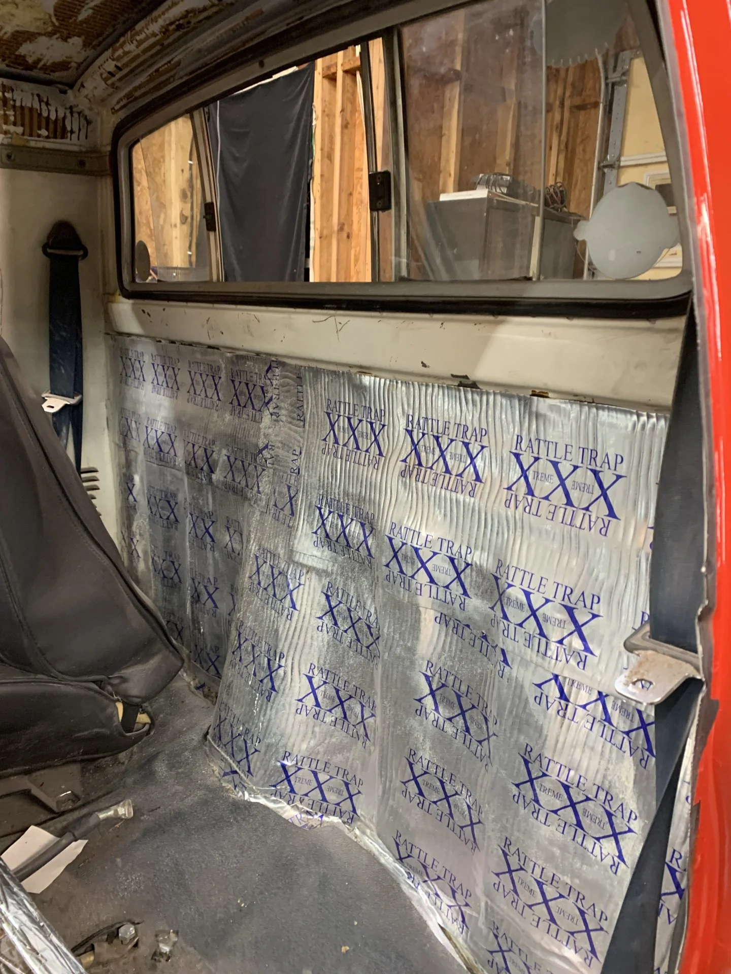

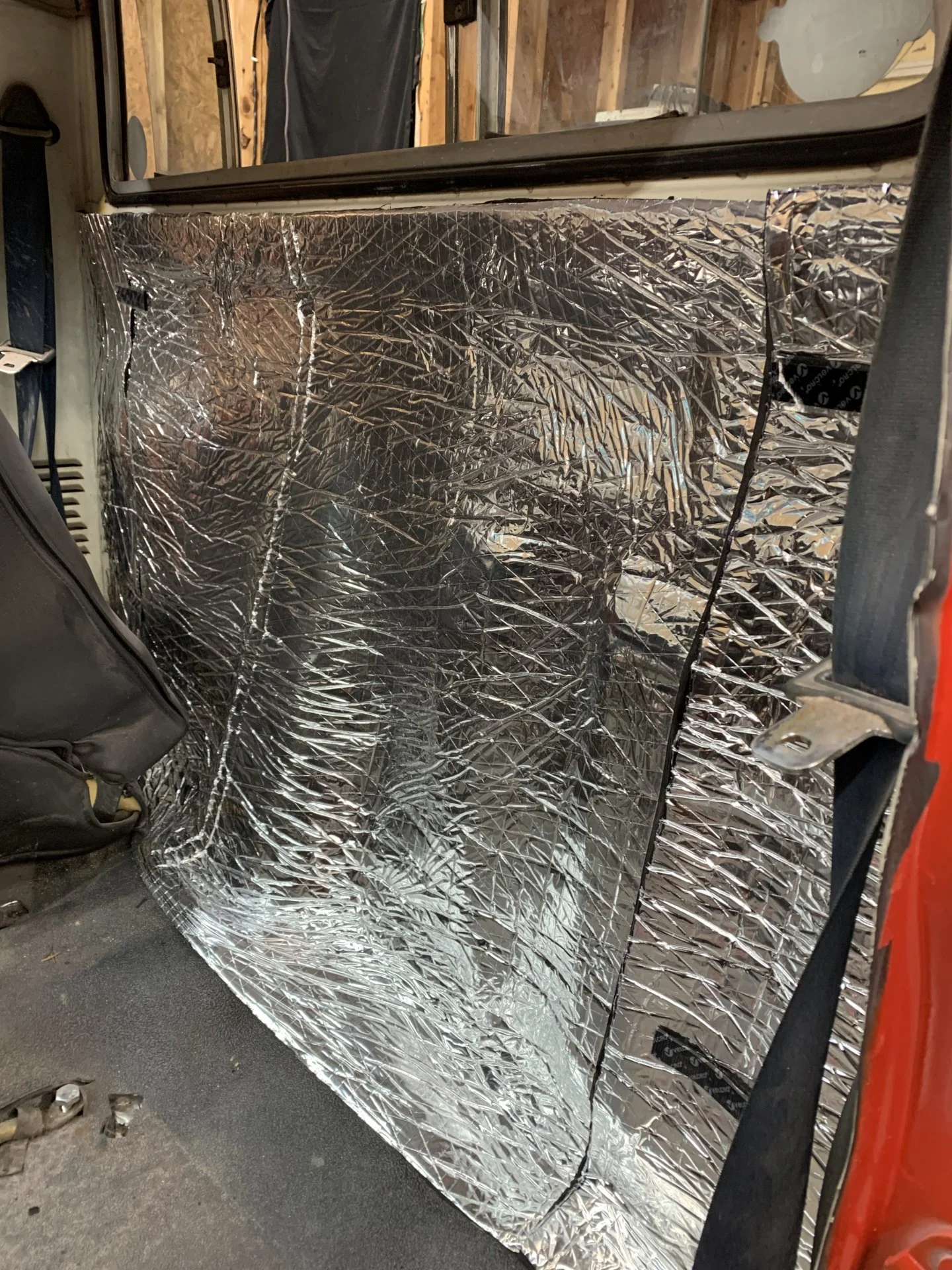

This is what I used and it works awesome. Especially since I haven’t finished the whole cab and it is already super quiet in the cab.
The butile stuff 100% coverage except the roof. It’s too heavy. This takes care of the rattling
The foam stuff is magic. Closed cell foam that sticks and is super light. This takes care of the ambient noise. 100% coverage.
With the vinyl floor cover over it. It makes the truck super quiet. And mine is an 83.

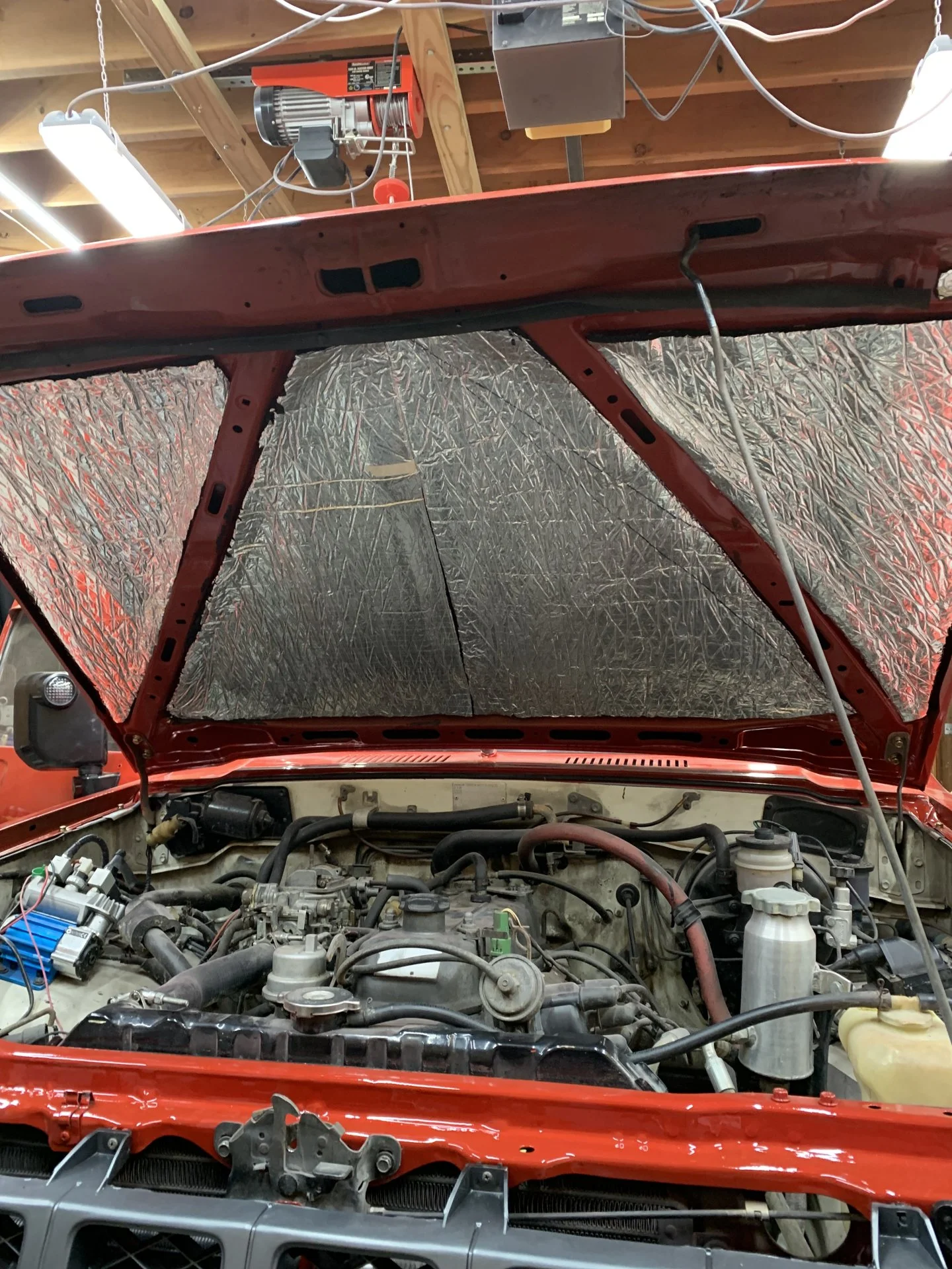

I also added it to the bottom side of the hood.

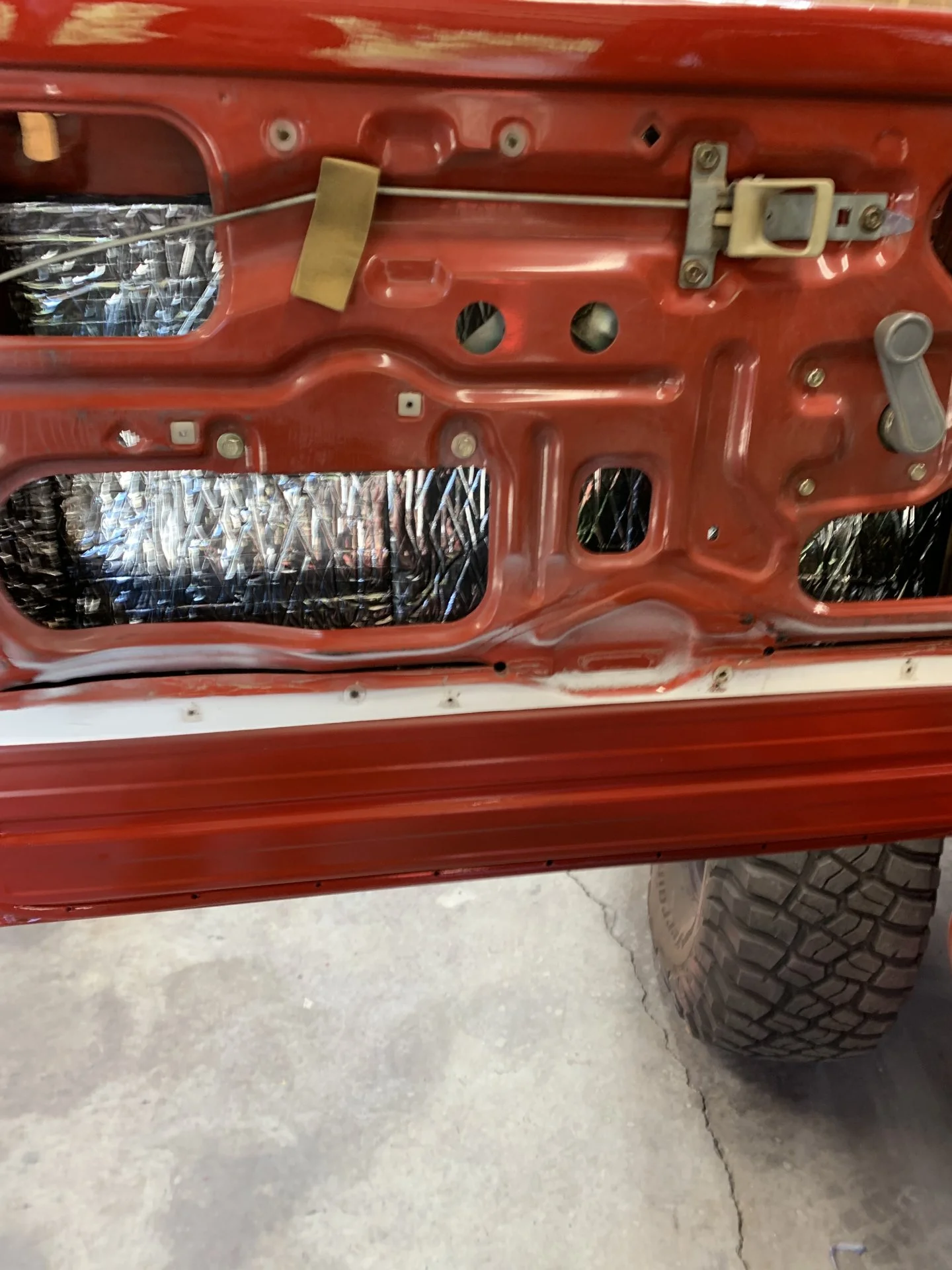

Inside of my doors is done but I still need to do the outside. Will do that when I replace my door covers.
The back of the dash will consist of plugging all unused holes.
Replace stock heat panels with a sandwich of the foam and special noise canceling hard plastic that I found online - normally used for noise cancelling rooms.

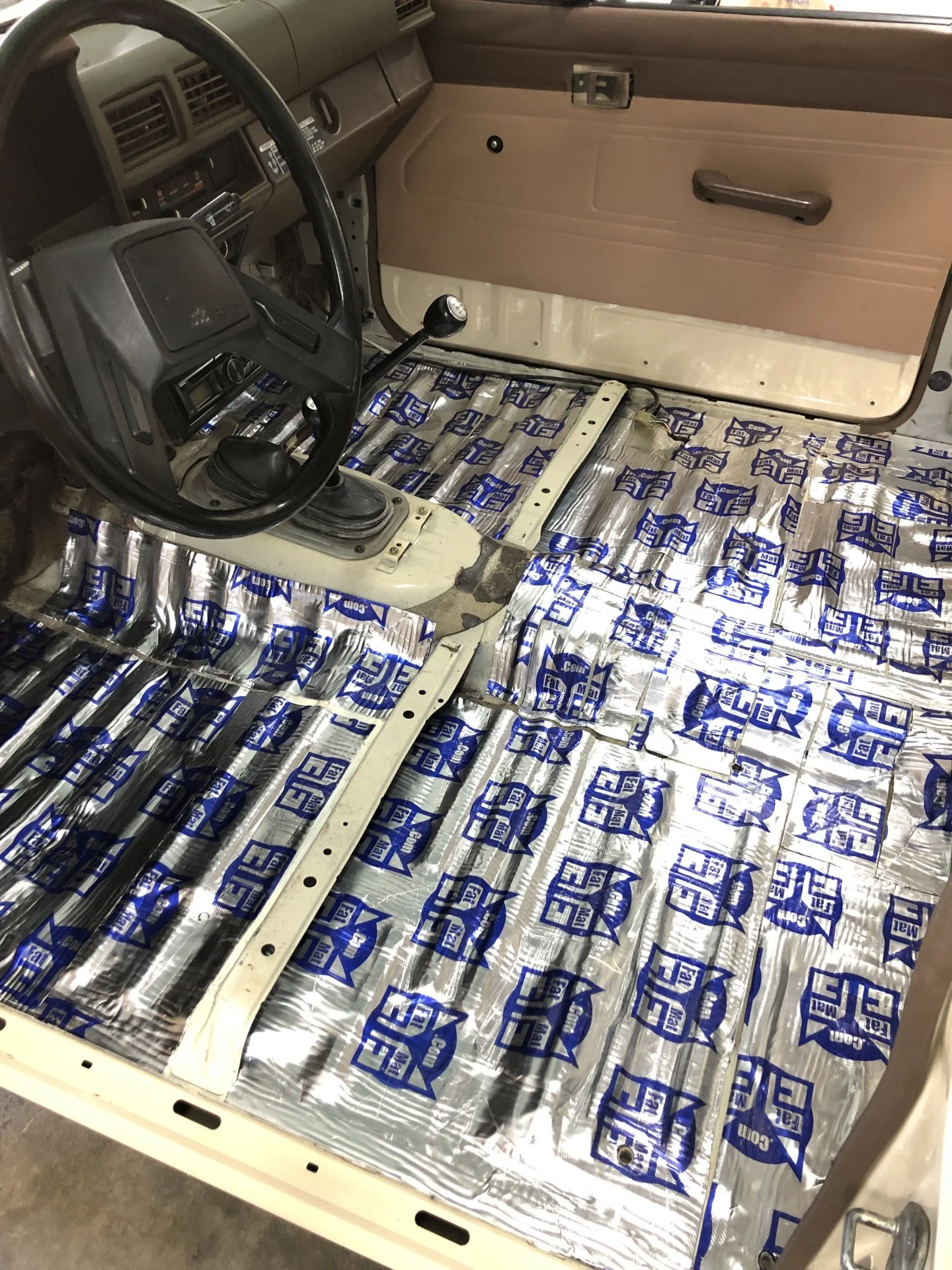

On the floors, doors, etc. and you're right - it made a massive improvement.
My next challenge is everything between the pedals and the windshield - it's just a cachophony of buzzing, rattling... I need to find the same foil/butyl material in like 1/4 scale ;-)

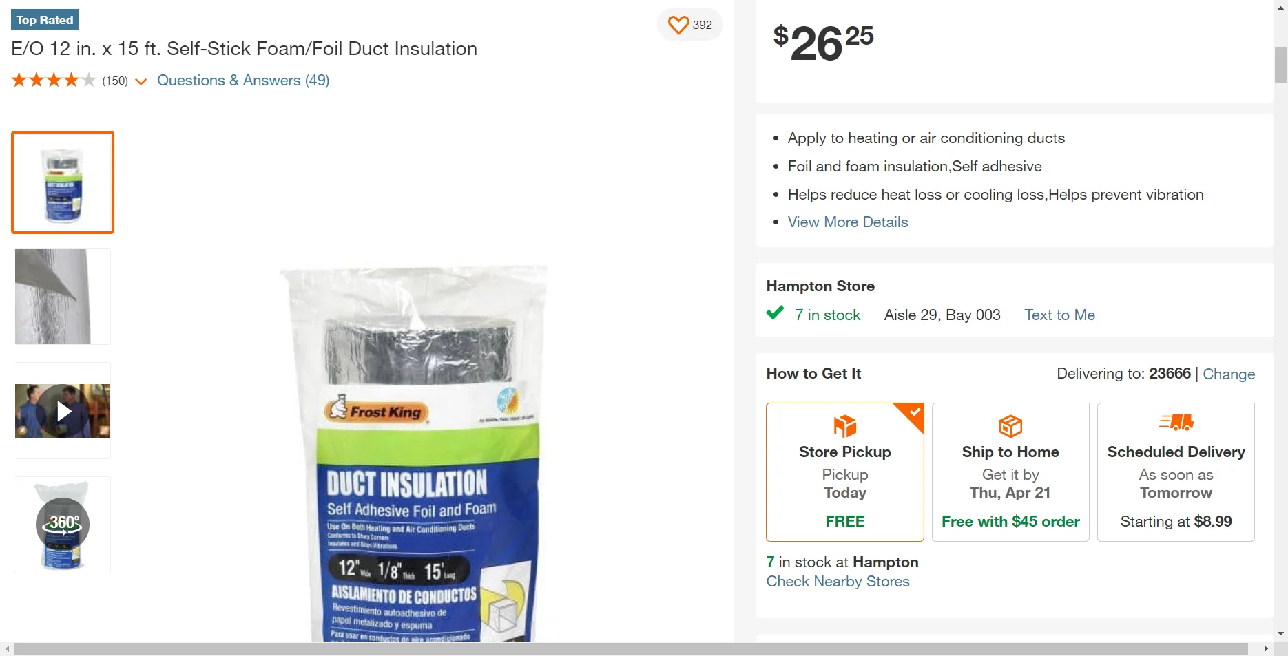

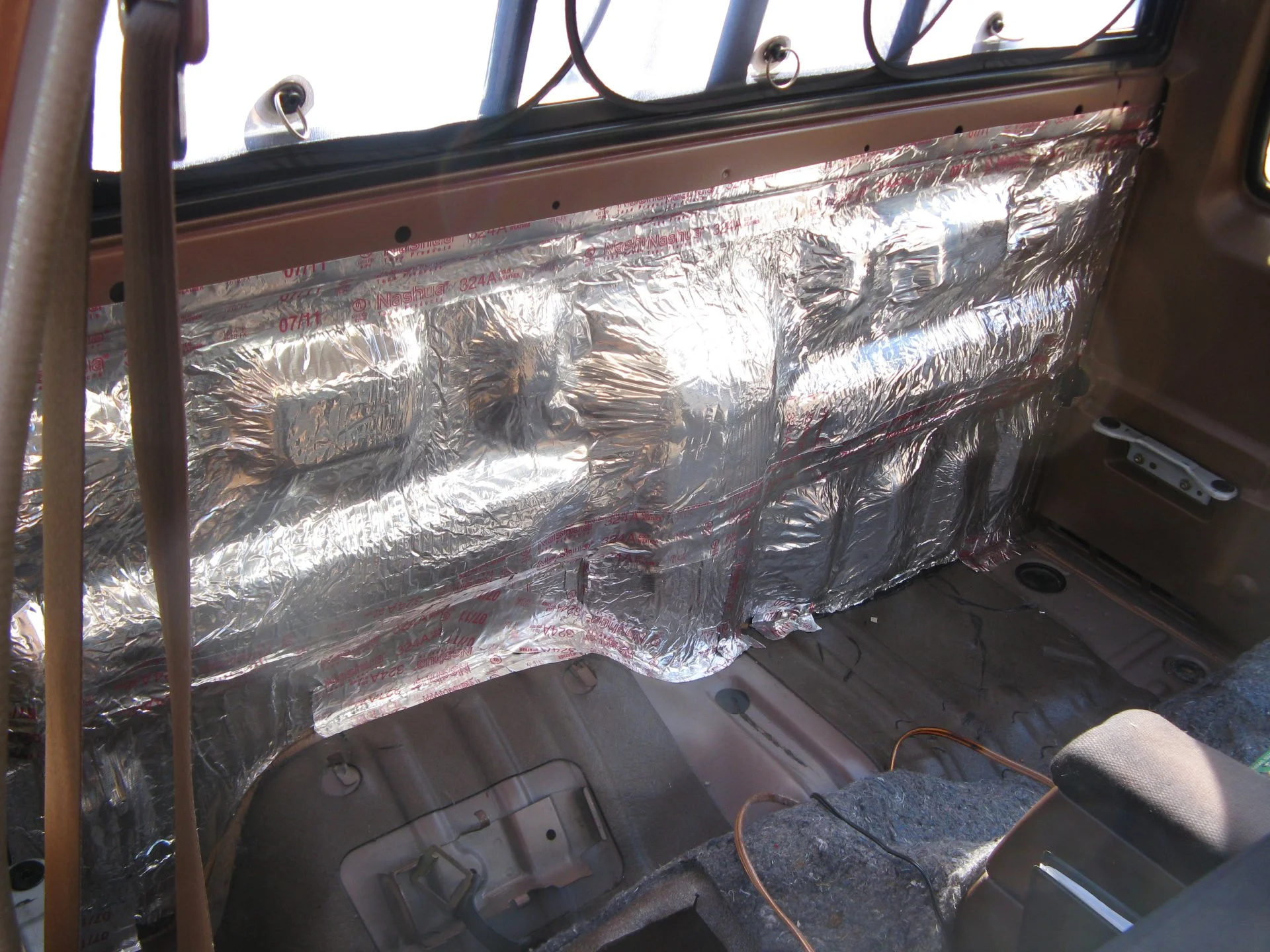

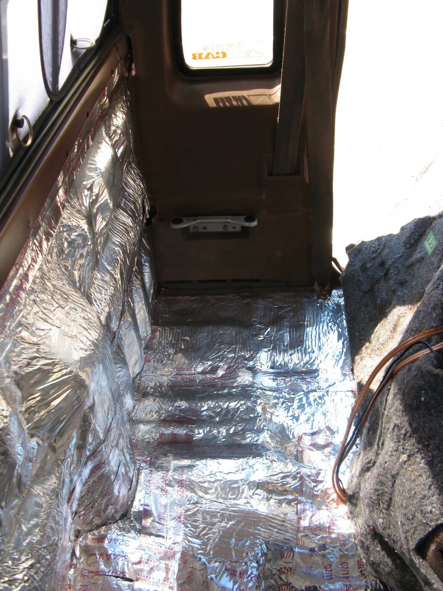

I used Frost King (Home Depot) aluminized closed cell self adhesive HVAC insulation treatment as a poor man's dynamat. It came in 1 foot by 15 feet rolls for under $20 about 5 years ago. Cheapo Sticks very well to the steel structure.

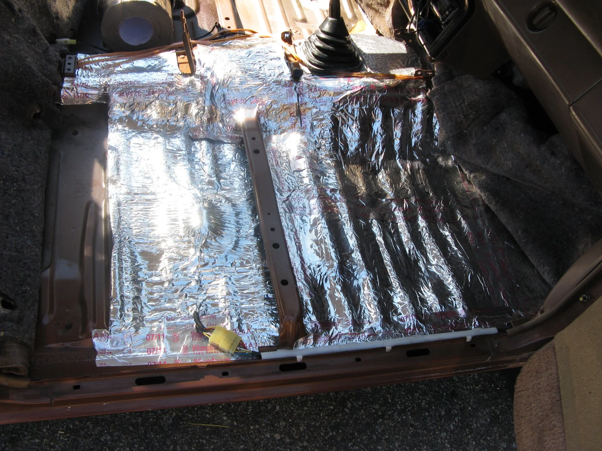

I installed in on the interior firewall as high up as I could go. On the transmission tunnel- 2 layers. A lot of sound comes up from the shifter hole so I covered it as much as possible. The flooring, back wall, and on the door panel half way up (to the crank lever). Makes a huge difference in quietness. Made my radio sound more full.
I installed it under the hood as well to cut down on noise. The last mechanic who test drove the truck kept saying how quiet it was in disbelief.
I used cheap aluminum duct tape (with red marking) and stuck half-ass. Use the quality non-labeled tape.

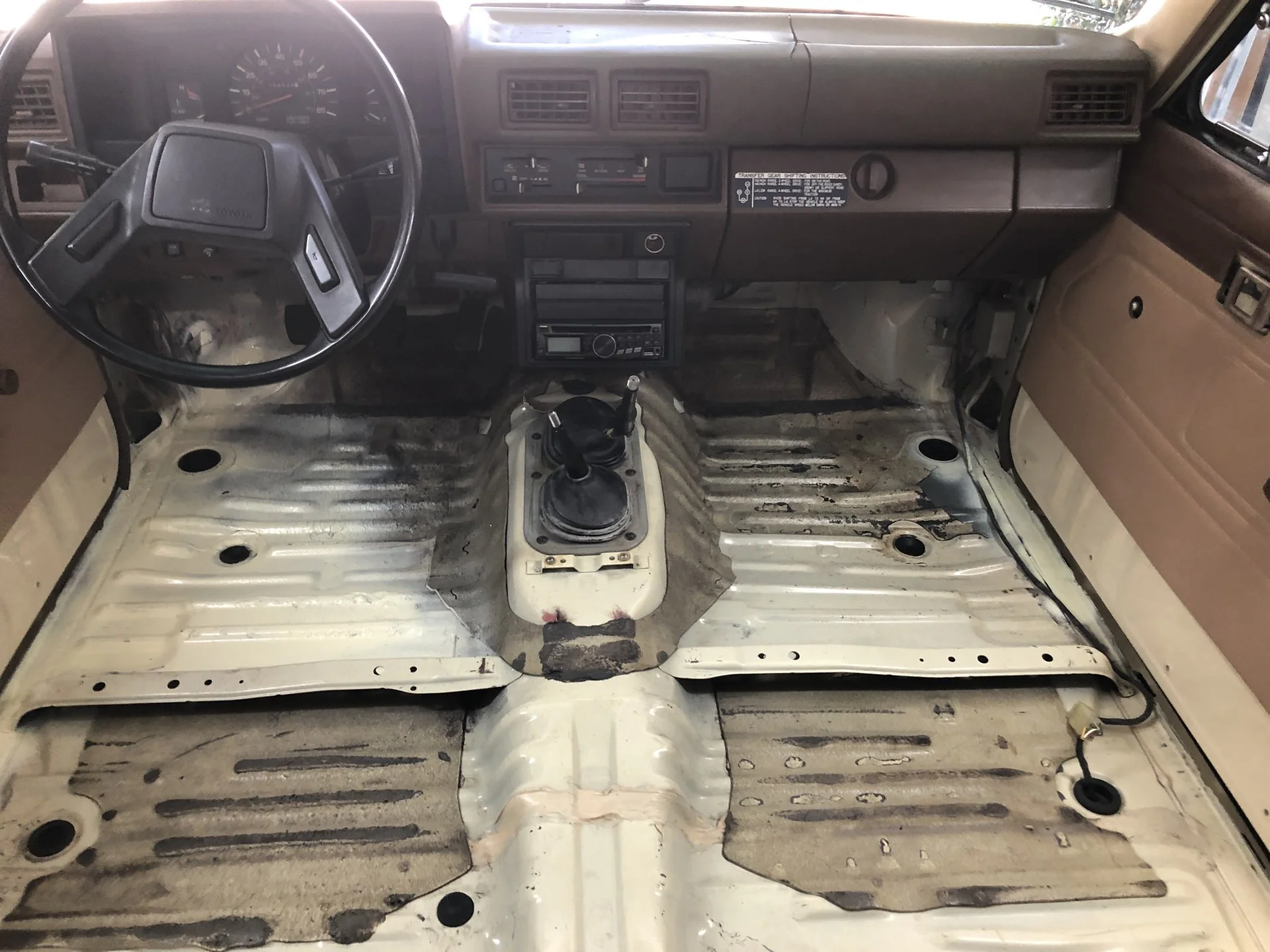

You guys that have added your own recipe of deadeners....Did you rip out 100% of the factory stuff, down to bare steel, or something else?
Lots of good input here.
The only downside to putting the sound deadening mat under the carpet and in the doors is that it made the other rattles more noticeable.

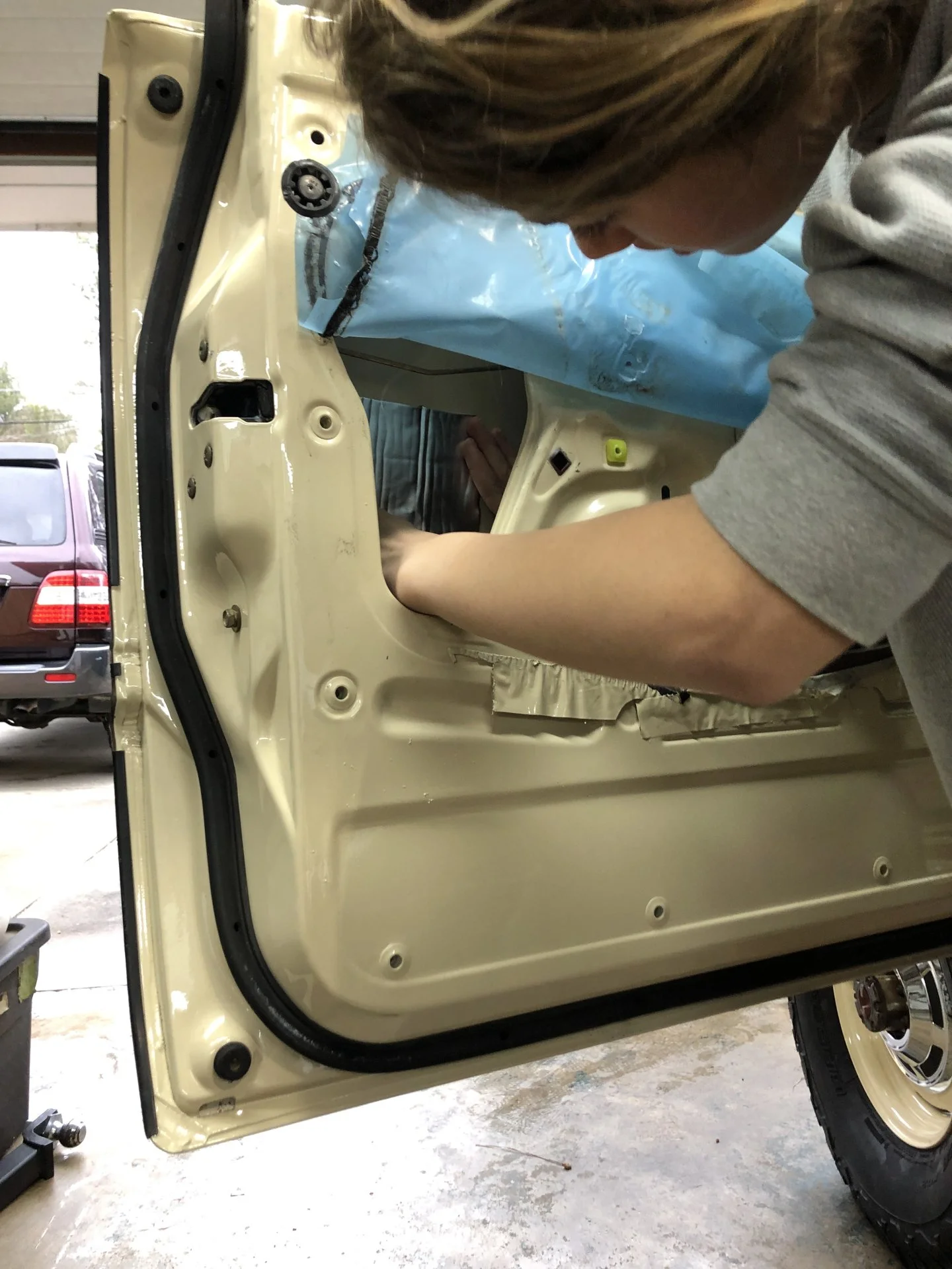

This. I used the 80mil foil/butyl stuff that others used. I did only the sides of the truck. Doors, quarters all the way back to the tailgate, plus the tailgate. I also used strips of it on the inside of the interior panels. It made a huge difference, but I will not say my truck it quiet. The most noticeable improvement was the way the door sounded when I shut it. It's now a nice thud, instead of a hollow, tinny sound. I still need to do the floor, and the rear cargo area.
One thing I will note is that an engineer buddy told me you don't need to surface 100%. You only need to cover around 25% of the surface. I did higher than that, but I didn't get carried away trying to get the stuff inside. When I do the floor I will do 100%, but I wasn't worried about the sides as much.
This is as far as I took it...
and pulled the side panels.
I read the same thing - that total coverage isn't needed. Sort of like putting your finger on the drum - the sound is dead. But, I did the total coverage on the floors and really got as much in the doors as I could. Some of that was for weight - that solid feel and sound. The doors aren't like my Land Cruiser, but man... night and day. Like you said - the tinny clink was replaced by a solid thud.
