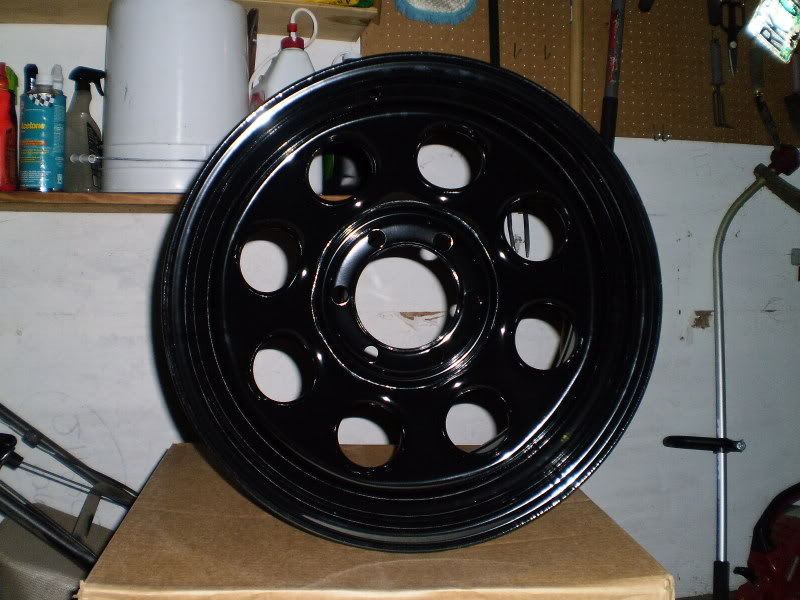

After I saw that, I knew that I had to have them! So I sold a few things and shuffled my budget a bit and ordered a set for my 17” wheels. If you don’t remember them, this is what they looked like when I bought them:

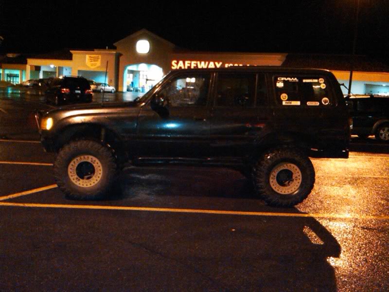

And how she looks on the 80:
This shot shows how much wider the tire looks with the extra inch of wheel. Because the tire is now bolted onto the face of the wheel, it makes the width more like 17x9 with the backspacing staying the same. I think it looks much meaner!
