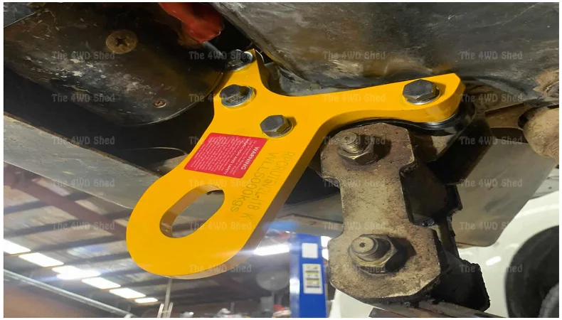

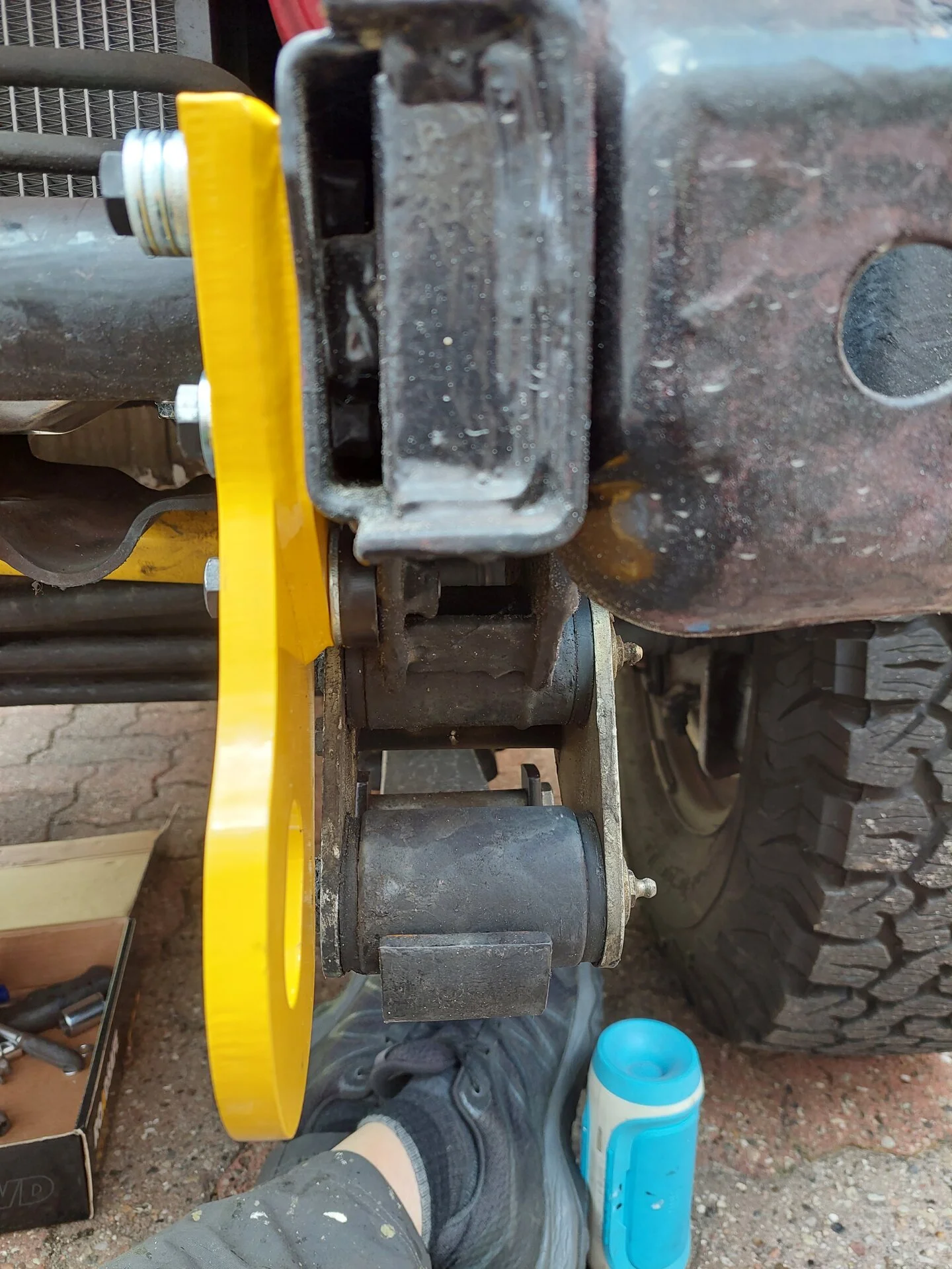

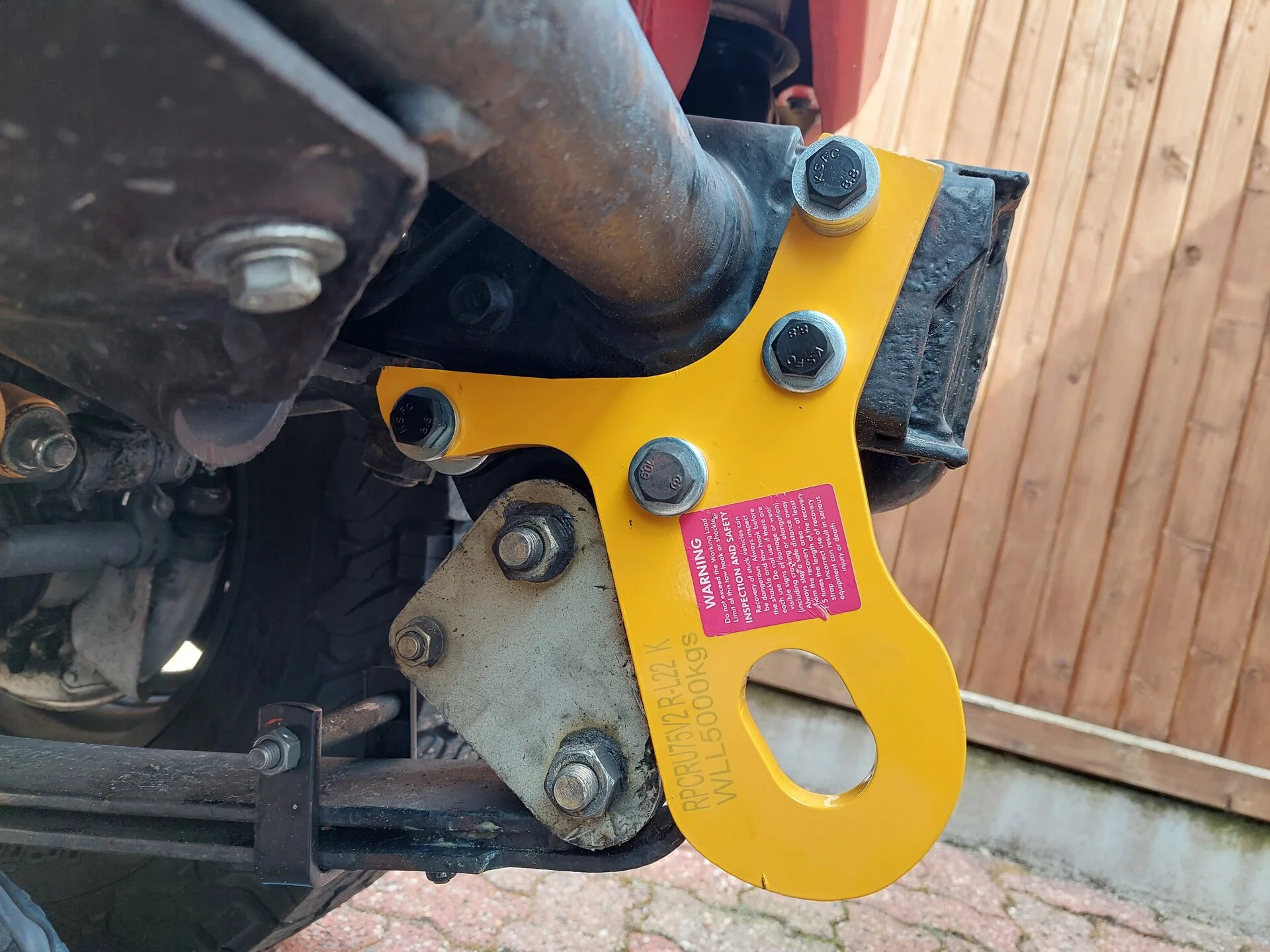

I just received a pair of Roadsafe tow points for the 75 series.
They do not fir since the parabolic leaf springs are apparently a bit longer than the oem springs..
This video is my description of my little issue.
This video shows the nut getting very close to the tow point. And that is just by rocking the truck manually.
Any ideas?
I suppose you could build out a spacer between the frame and the recovery point. I wonder how much extra leverage that would put on the bolts though. Seems like there needs to be more space there even for the factory shackles to articulate. That is disappointing to see though. I was looking at a very similar set of recovery points.
Hello,
It might be possible to fit a spacer to keep the tow points from hitting the shackles. Not a good idea, I think.
Another option is installing OEM tow points. They do provide more clearance; they are beefier than they look as well.
