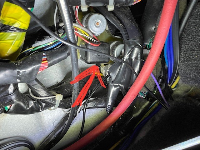

New relay is the black blob one in place of Toyota factory flasher.

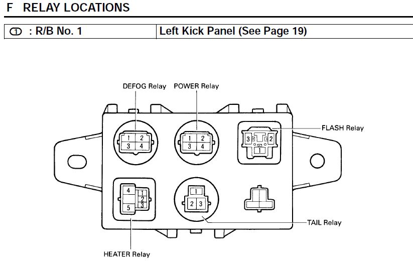

After reading a 100 threads I tried to replace the relay on my 97 LC this weekend. I had already converted all other lights to led but the signal lights. First the relay wasn't where most threads sent me so I'm posting pics to help those that might have issues finding it. It's under the panel to the left of the dead pedal. You have to remove the dead pedal and pull back the trim to access it. I finally tracked it listening to the ticking sound of the blinker. I was able to pull the original relay and replace it with the led I ordered on amazon as noted above. It did not work. Put the Sylvania leds in and still got hyper flashing so read more and decided I may have too many leds installed already and I can do without the signals being so bright.

Yes...I took it off to remove the relay, just a visual to show where it is.

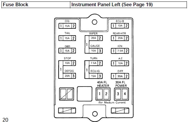

From the Toyota EWD which is available to download from the resources section.
It makes more sense to go to the information source rather than rely on some guy on the internet.
