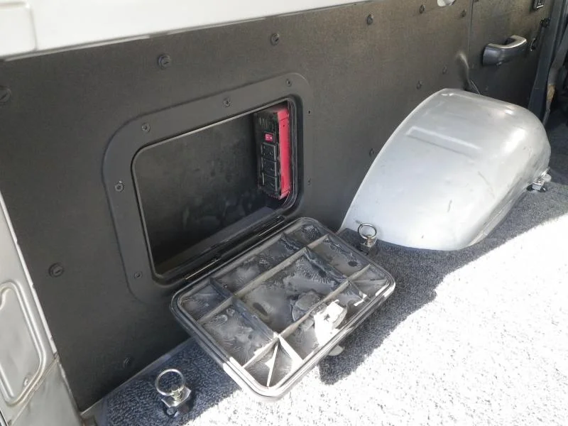

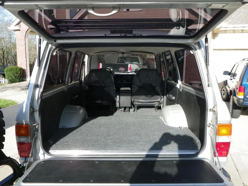

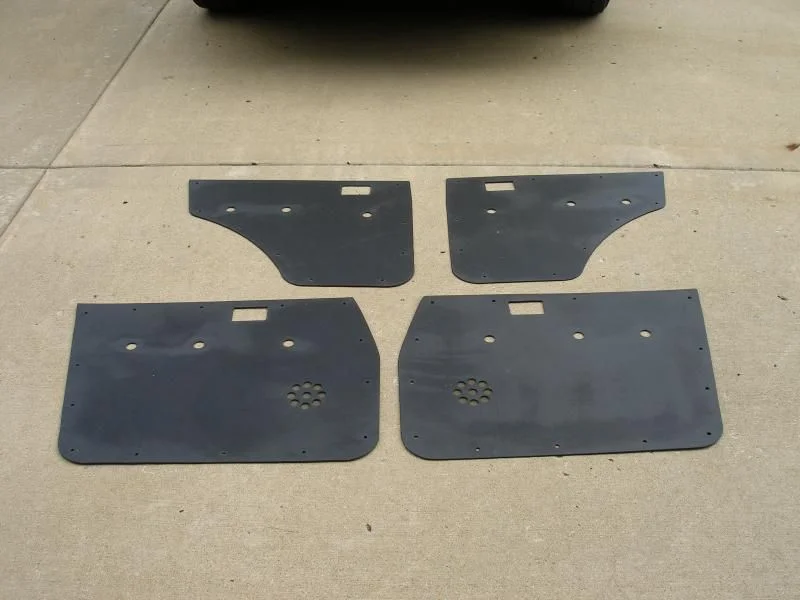

I stole the photos below from this thread
https://forum.ih8mud.com/60-series-wagons/538219-rear-panel-cargo-area.html
They are an ABS type plastic, others have used a marie type plastic as well. I think this would work better than the aluminum panels Quinton. THe metal will turn the empty space behind the panels into an echo chamber. You can also get the plastic in many different colors.
This is what I am planning for my 60
