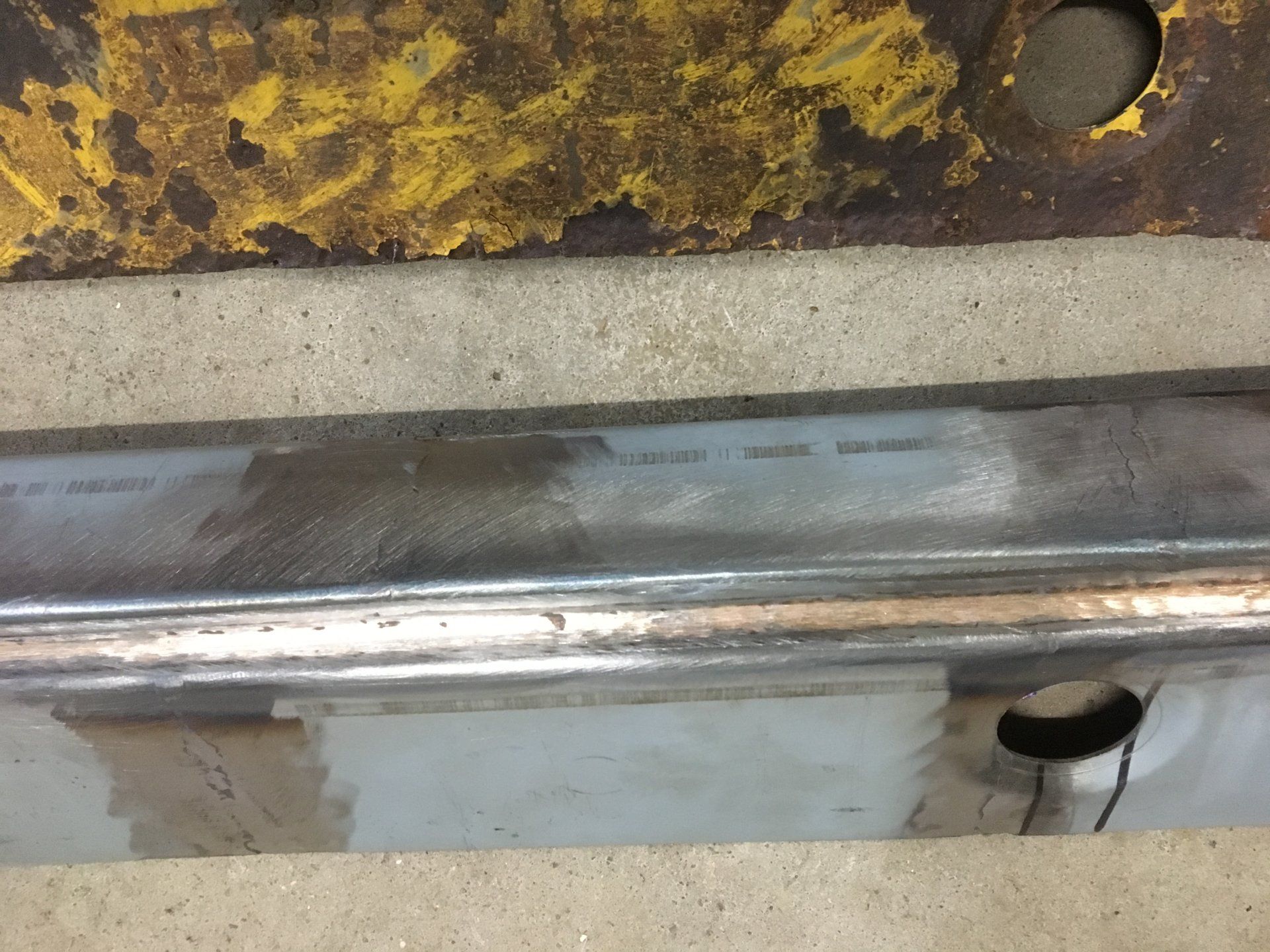

Some results of the aqua jet.
Finaly a few hours in the shop.

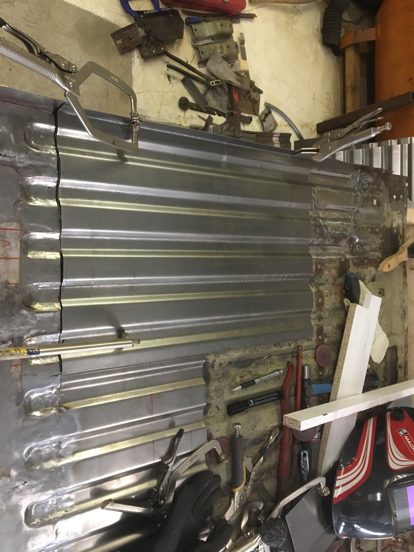

Spend some time with straitening out some patch work.
Ready for welding.
And after some grinding.

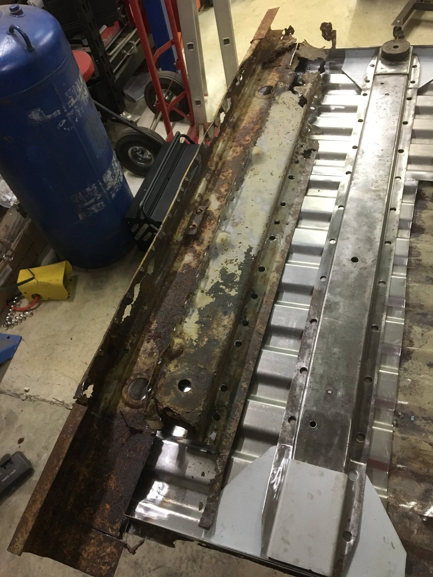

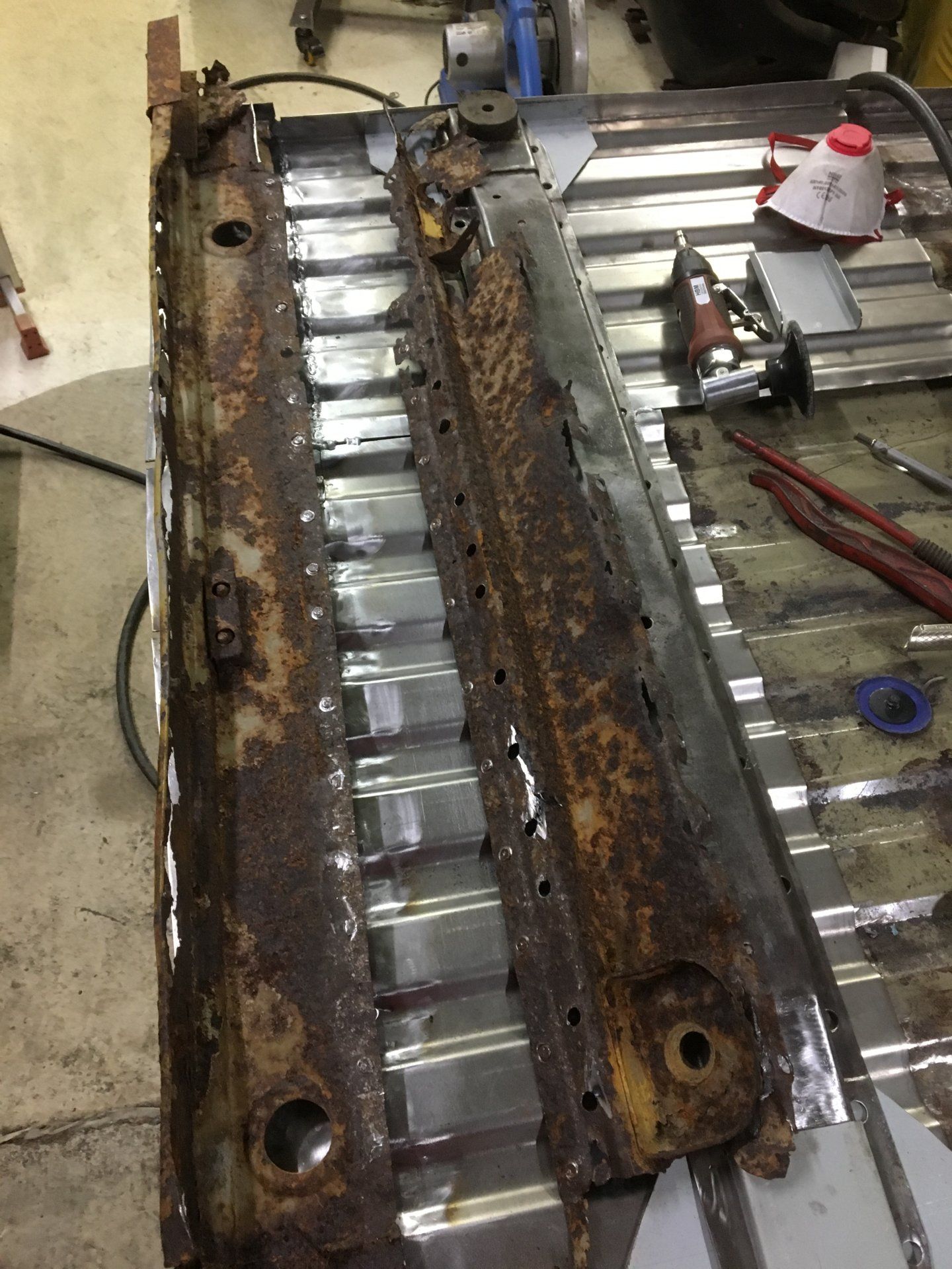

Started to disassemble the remains of the rear sill.
Started with the idea to patch the rear Sil.:hmm:
Made the first patch and decided to just create a new one from scratch.
