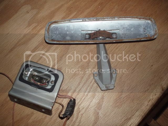

Mirror glass thats eazy ....The rear view mirror I bought with windshild frame did not have any glass was going to have one made anyway ...the broken part was the bracket, and the mirror head was a no show ! :crybaby:
I could weld some nut zerts into the frame ( Say No to sheet metal screws! )and use a two bolt from a 68 and later I have one of them..... I was tring to keep it looking 66 ish :cool: so far this has been on of the hardest part to come up with :confused: JC

The bracket on right is from three bolt type 1964 to 67 fj40/45 this is the one I need ...... The left two bolt type rear view mirror is a later 71-77 fj40 after market ...JC

I'v got an :idea: I have some 3/16 " x 2" steel plate cut a 3" piece drill and counter sink for pan had bolts to bolt up to the three bolt 66 windshild frame, and drill and tap the plate for a later two bolt RVM (RVM adapter plate) and not to screw up a near perfact windshild frame and not to hold up the painter,and when I git ahold of the right RVM I'll be good to GO ! what's you think ;p JC
I'll try pick up some pan head bolts to fab one one up this weekend I'll post :cool: up picts...JC

If you're gonna do that, might as well fab for the 78 and newer mirror with the day/night feature. That's what I did on my 64lwb. I like having a 'real' mirror more than having the 'right' mirror. It's a safety thing.;)
