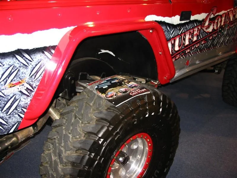

but here are 2 pics i saved also . 1 jeep .:doh:
i would love a set of tube /metal flares

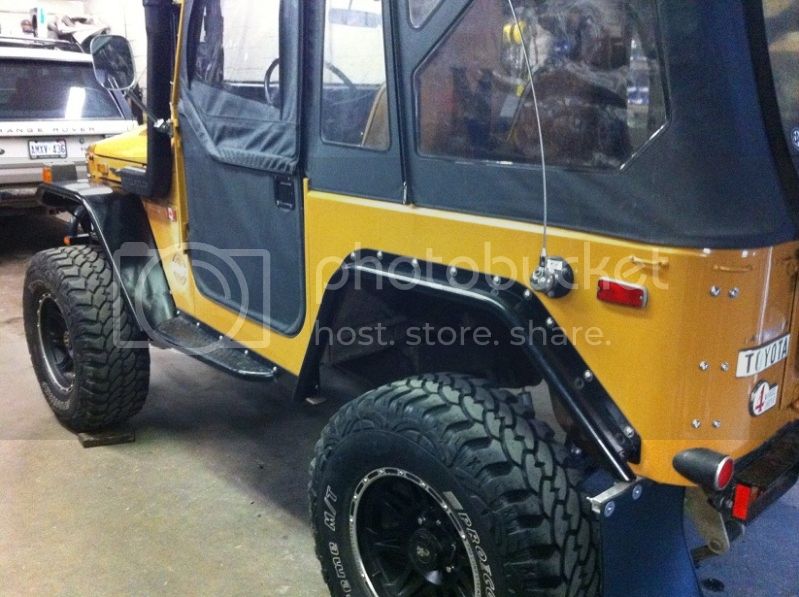

Here is the picture of the ones I built for my Cruiser:
Sorry this is the best picture I have right now. Not true flares because they are not attached to the body only the sliders and each side by the back tube which is attached at the rear body mounts.
The jeep flares are made to use with the 1/4 panel armor which is usually 3/16 thick other wise you'll just push the flare in when you rub it on some thing solid and smash your corner panel in.
