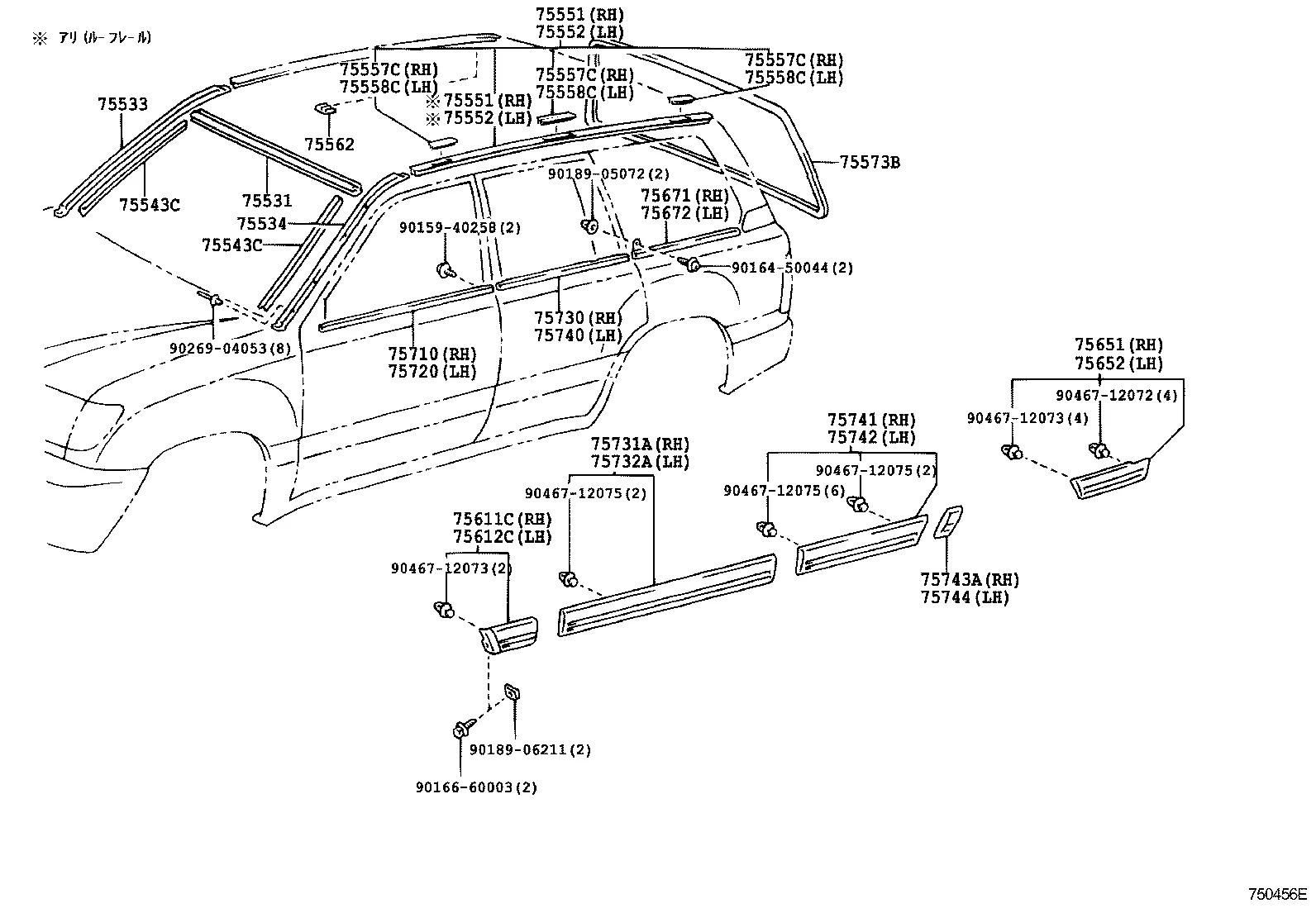

My new-to-me 1999 LC is missing a trim piece on the rear passenger side quarter panel (picture attached). I've found a Toyota parts schematic that shows this piece to be #75651 (right side/passenger side, also schematic attached).

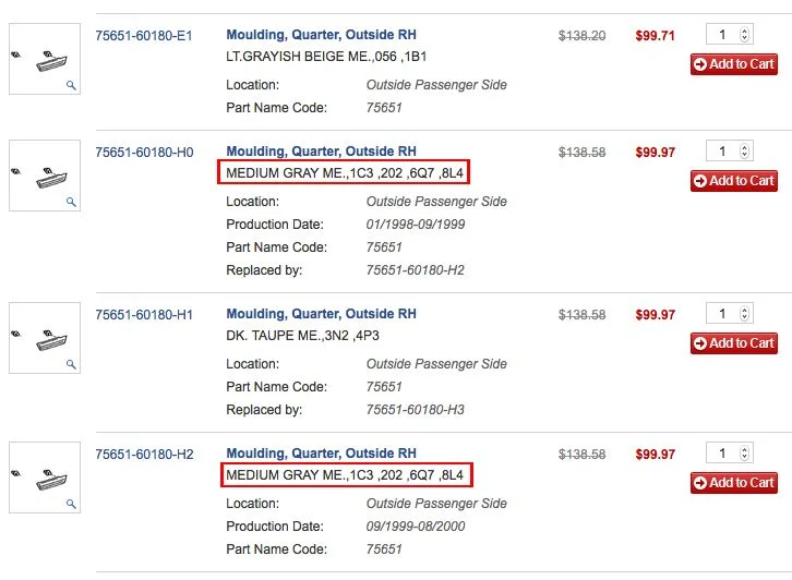

So finally I found my way to Toyota Parts Deals and pulled up a list of body moulding options:
Moulding for 1999 Toyota Land Cruiser | Toyota Parts Deal
and two of the options for #75651 have Medium Gray ME., 1C3 as part of their descriptor. I've attached a screenshot with red boxes around those two. The only discernible difference I can find is the manufacturing dates - the piece ending in H0 was manufactured between 1/1998-9/1999 and the piece ending in H2 appears to be the replacement piece manufactured between 9/1999 and 8/2000.

  1. Am I right in assuming these two options that include 1C3 in their descriptions and say "Medium Gray" are the right color for my Riverrock Green Mica(1C3) body color?
  2. Assuming that's the case - is there any difference between the H0 and H2 pieces? Should I buy the older one because my LC is a 1999?

2. I am guessing that no matter which you order, you will get the "H2" piece. H0 shows to be replaced by the H2 part in the screenshot above. It was the same way when I ordered the quarter trim piece for my '05 LX. Different color and part numbers, but it was something like B0 replaced by B2.
3. My quarter panel trim came with all of the hardware. I believe yours will too. In the picture above, it shows a bracket sort of encompassing the trim piece with two other part numbers and "(4)" beside them. It has been my experience that this means BOTH trim pieces (right and left) require a total of 8 fasteners. This seems to mesh with the picture of your rig...4 per side, 2 white and 2 red per side. The bracket indicates the fasteners are included.

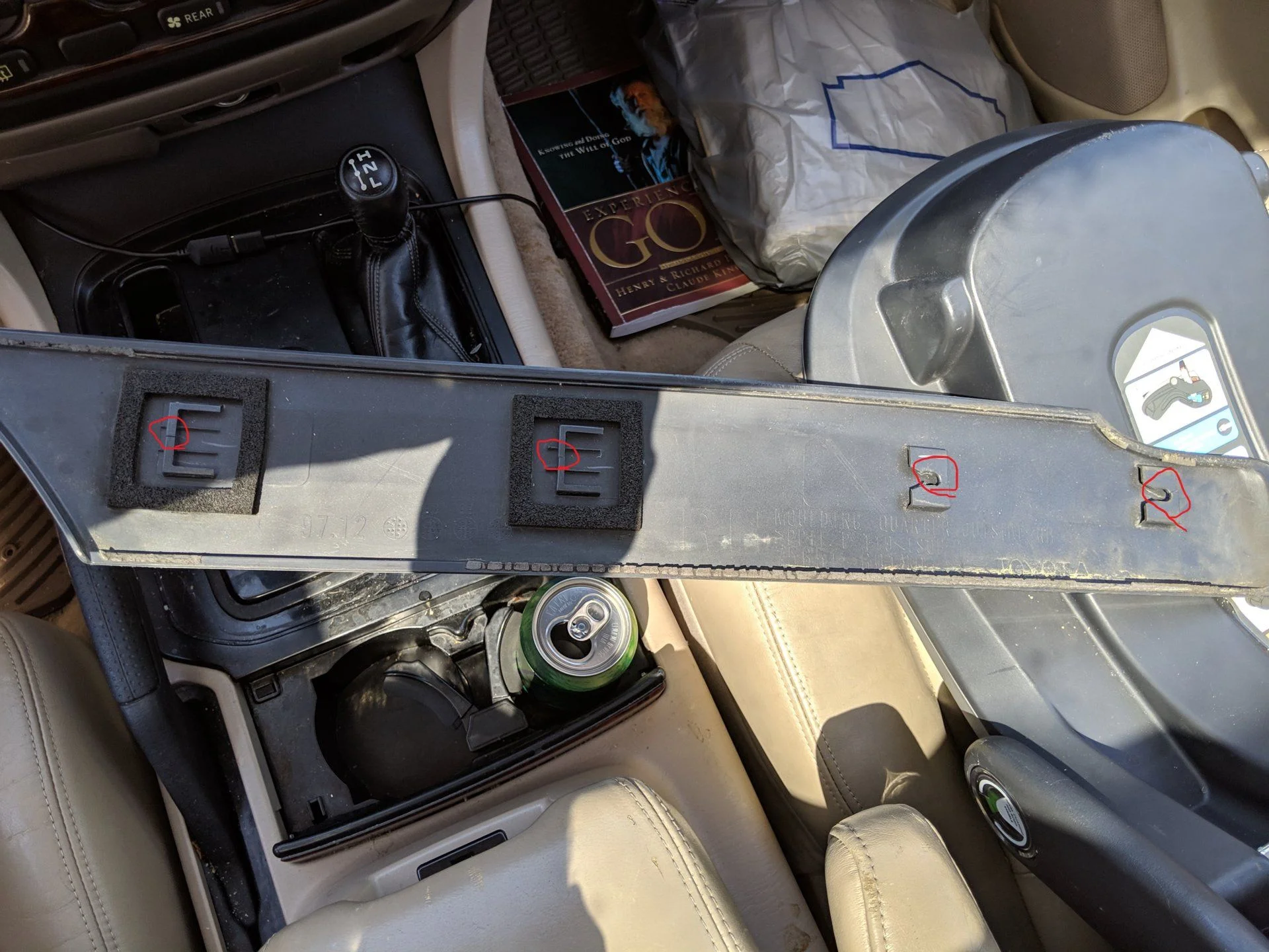

Coincidentally, the very same trim piece @TheMcCannon needs, came off of my LC100 in the car wash. Unfortunately, it appears as though each of the brackets on the trim piece have broken (I've attempted to highlight in red circles in the picture). Does anyone know if this piece is "re-attachable" or will I need to buy a new piece?
I had the exact same issue in a car wash on the 2000 LC and the pieces split exactly in those places on each side. Have you had any luck finding replacement parts or fixing these? Thanks
I ended up using trim tape to reattach the piece. So far it has worked pretty well - no issues and it appears to be on securely.
