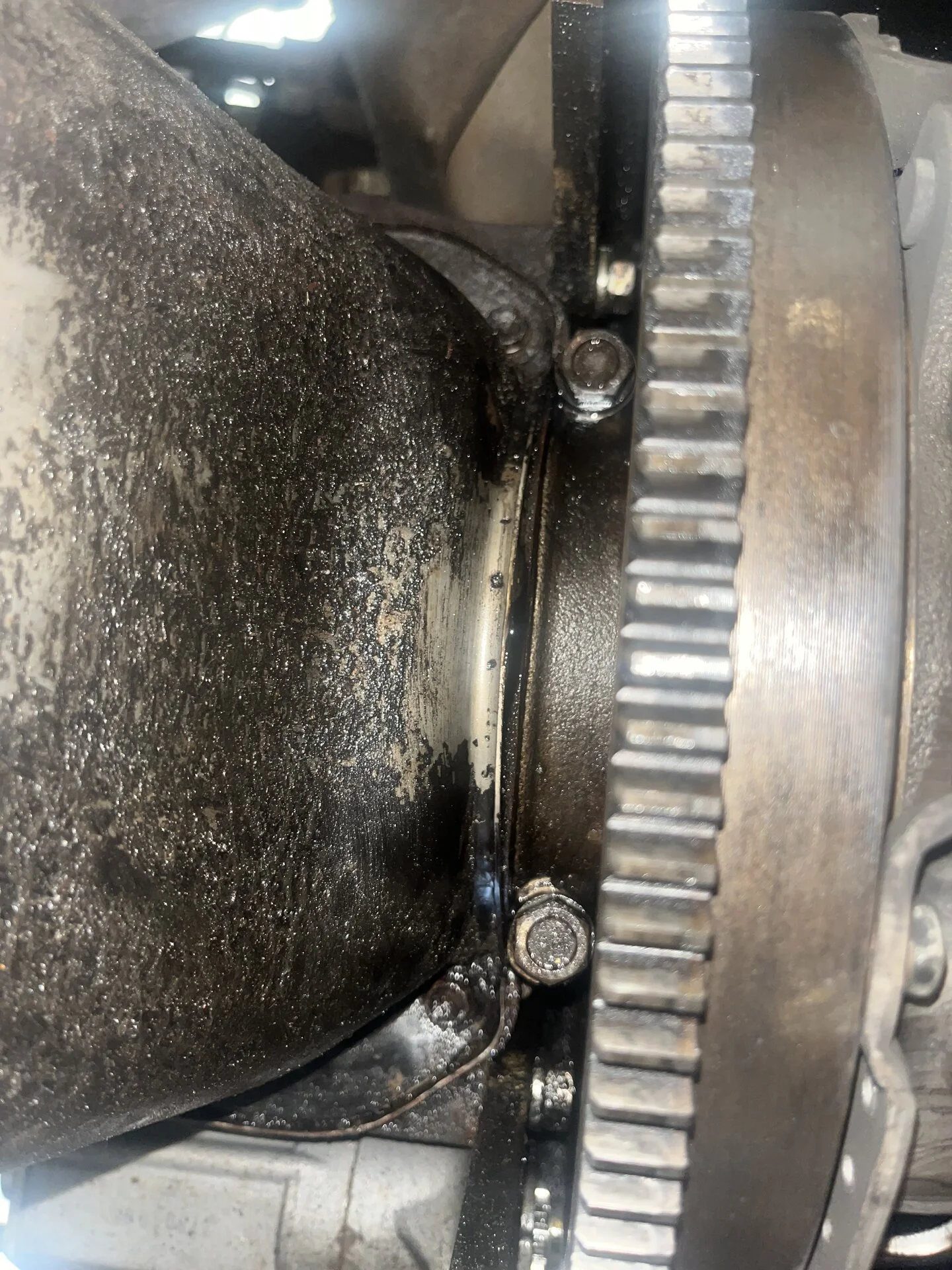

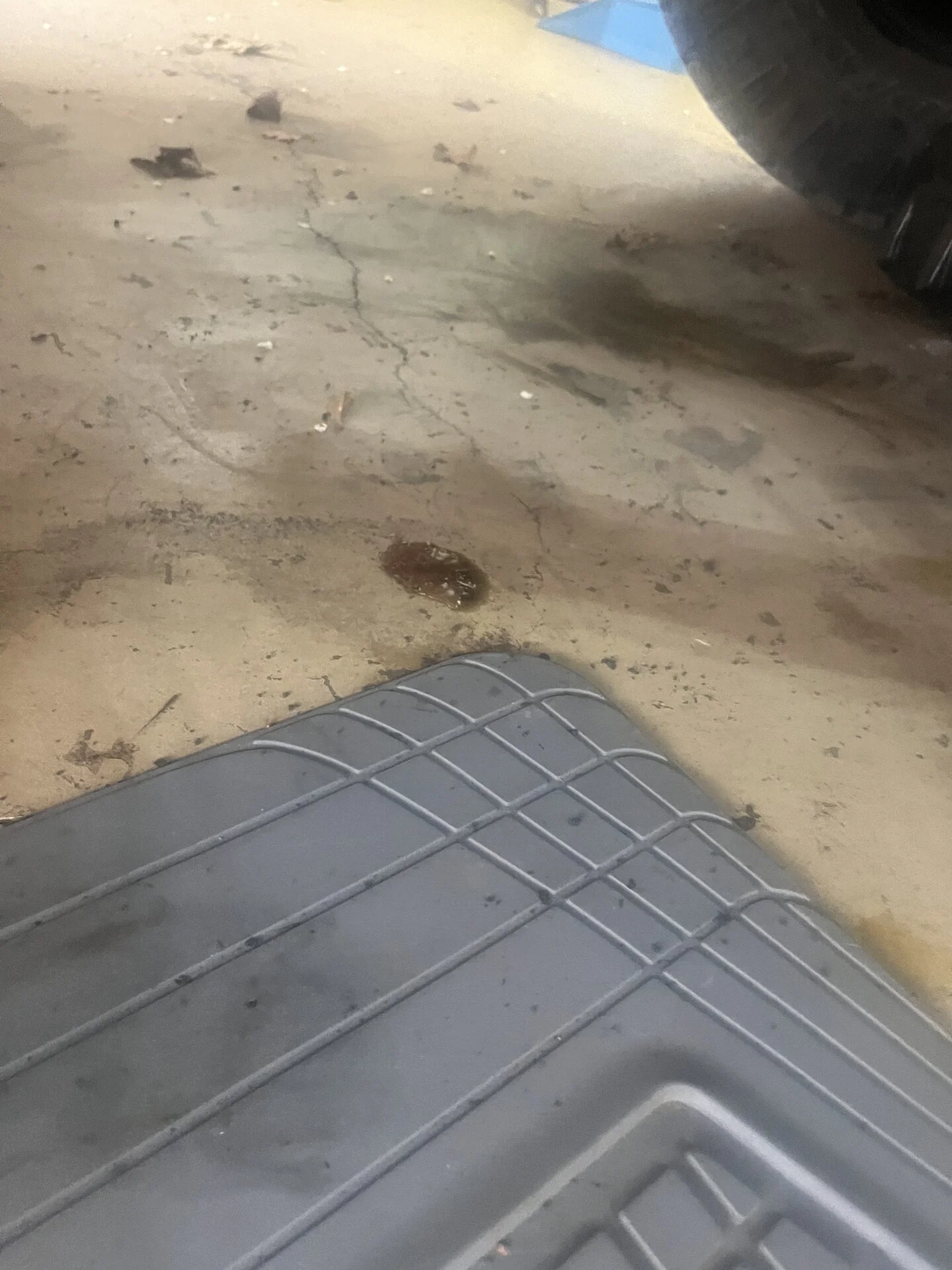

So I noticed a pretty good leak over the past several days… I pulled the clutch inspection cover earlier today just to see if I could pinpoint the source… I cleaned up all of the fresh oil I could see and let it sit… after about 2 hours I came back to a 2 inch puddle and what looks to be a leak around the rear of the oil pan or the rear main seal. See pics…
Is it worth it to try dropping the oil pan and replacing the gasket first? Or is there anything about this pic that says it’s definitely the RMS?
I have zero experience with dropping a trans, but if that’s what I need to do I’m willing to do the research and start planning for it. I may try to hold off until I’m ready to throw an H55F in though.

Replace the pan gasket first. 99% of trucks with the original gasket need it, and the job is so much easier than pulling the transmission. My FJ62 has 262K and still has the original, non-leaking rear main seal. If needed, you can heat the flange of the oil pan to remove the old gasket. I had no issues re-using the original oil pan.
Only, only, only use a Toyota OEM 1-piece oil pan gasket, and use super-small zip ties, dental floss, or some technology to secure the gasket to the pan as you bring it up (to keep the gasket from falling into the pan). Clip the ties or strings as you go. I used FIP lightly on both sides of the gasket. Check other threads here for more tips on oil pan gasket replacement.
I agree - start with the oil pan. I had the exact same symptoms as you, and since replacing the oil pan gasket, I have no oil leaks at all.

Thanks everyone for the tips. I ended up replacing the oil pan with the new OEM pan and gasket due to a hole in top of the pan. I figured I'd just replace it instead of trying to repair it and risk it continuing to leak. I didn't think the process of replacing the pan was too painful using some of the tips I ran across in the forum.
Happy to say... it's been several days since I finished the replacement and I have not seen a single leak since...
