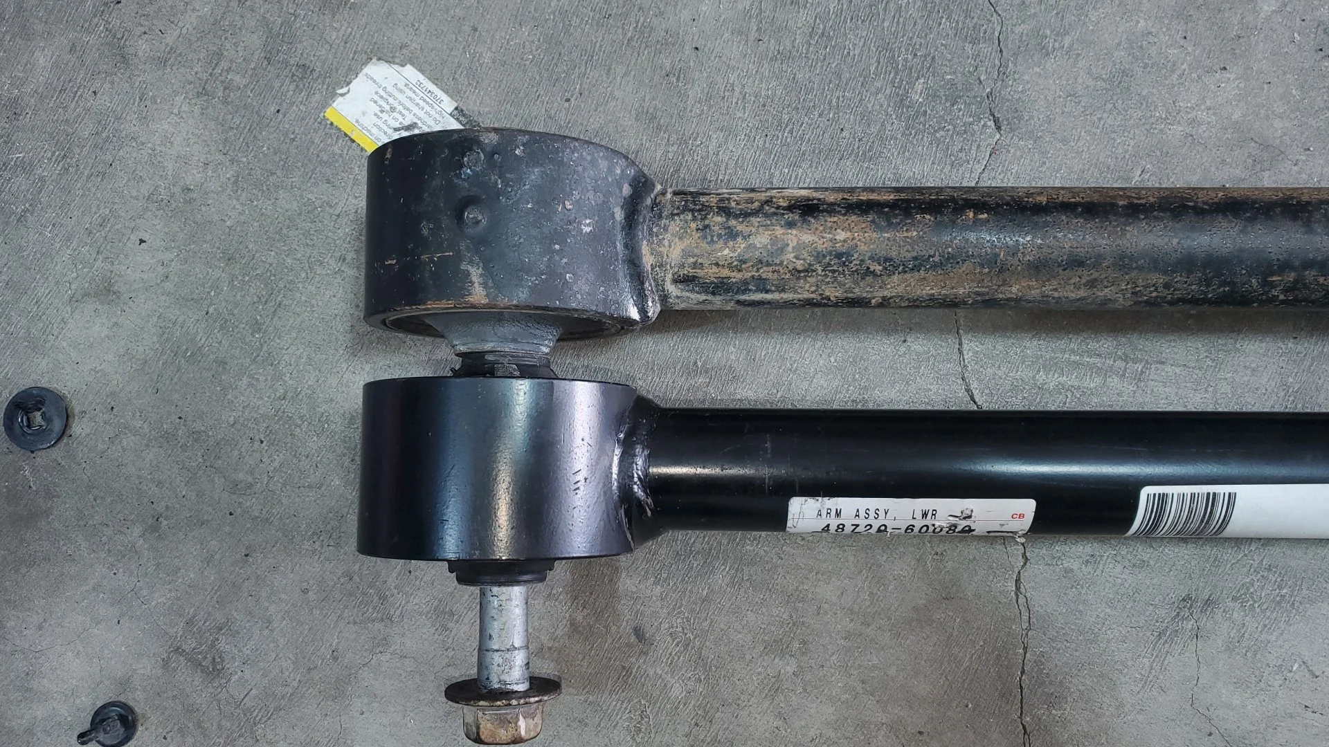

Comparison 200 vs 300
200 7.6lbs
300 6.6lbs
They are probably the same length, 200 bushings are probably stretched a little after 270k.

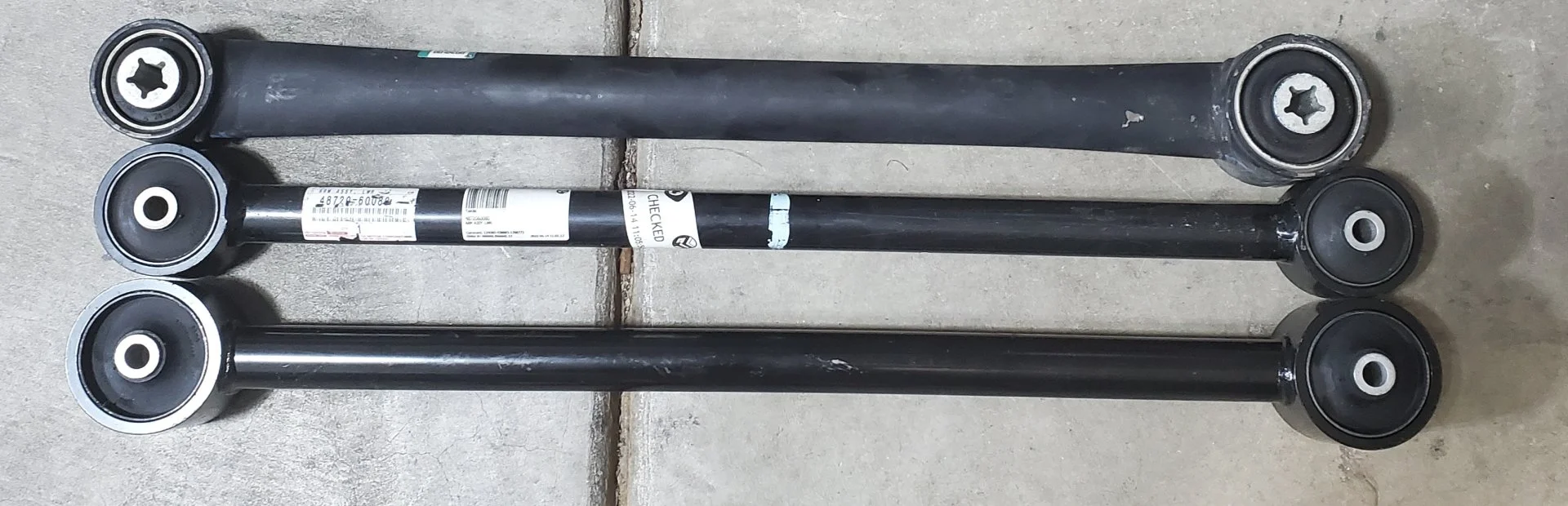

Another comparison
22+ Tundra
8.6 lbs, larger diameter main tube and bushings. Bushings 10mm wider.
Same length and bolt diameter.

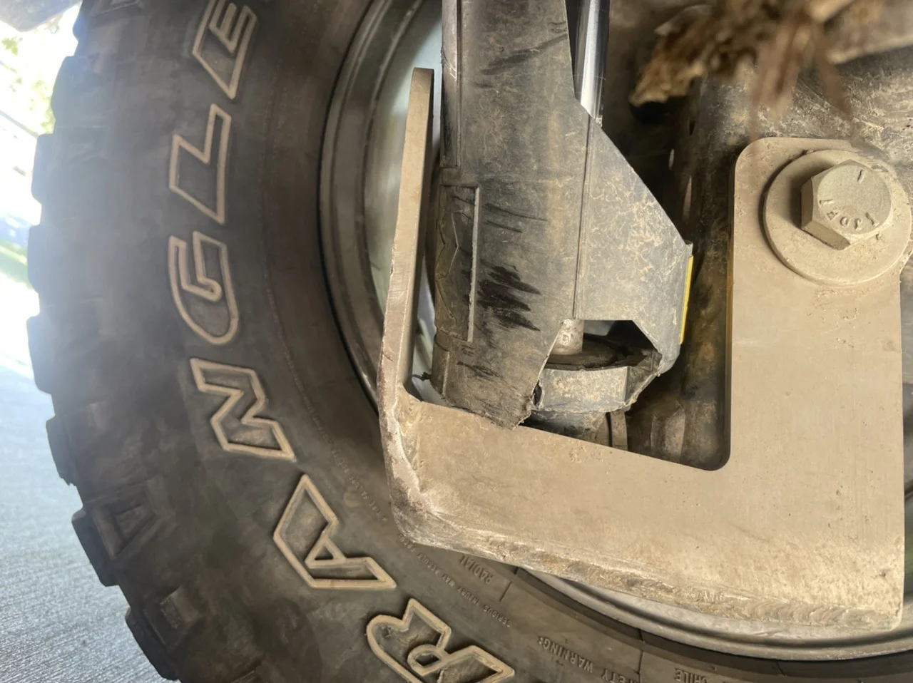

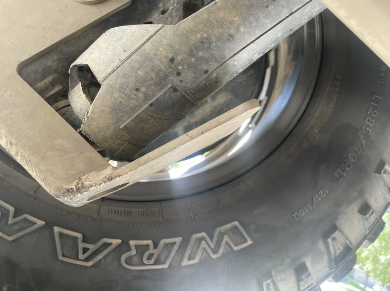

So no action photos but here is a pic of the BudBuilt lower shock mount guard which I managed to bend closer to the shock. Other pic shows driver side which was not bent for comparison. Not criticizing BB guards at all here. It did it’s job and is still functional. Just showing how hard I was bang on it and the control arm.
Passenger side (bent)
Driver side (not bent)

6th gen Bronco
7.4lbs
48.5mm diameter.
Main tube looks to be hydoformed, feels thin.

i kind of feel like that demonstrates that it is doing its job of protecting the lower mounts and the shock.
