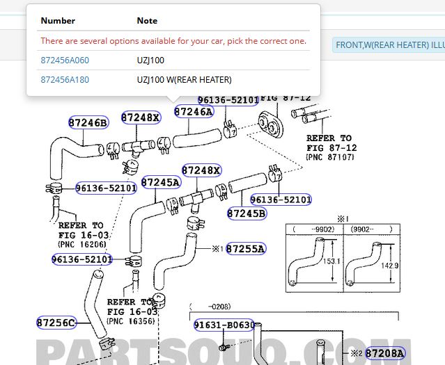

I would like to put metal heater T's on my 2000 LC. Which brand do you all recommend ?
Also do you have the part numbers for all the other heater hoses that go to the T's I'd like to replace all those as well.
Thanks
Check on partsouq.com. Enter the vin/chassis number and browse the parts diagram.
There's an OEM metal T from another LC series, think cruiserpatch sells them on his site. Seems like the other metal ones from hardware type places have fitment issues with the bands or sizes. I'd just go OEM plastic, they're affordable and have lasted 25 years.

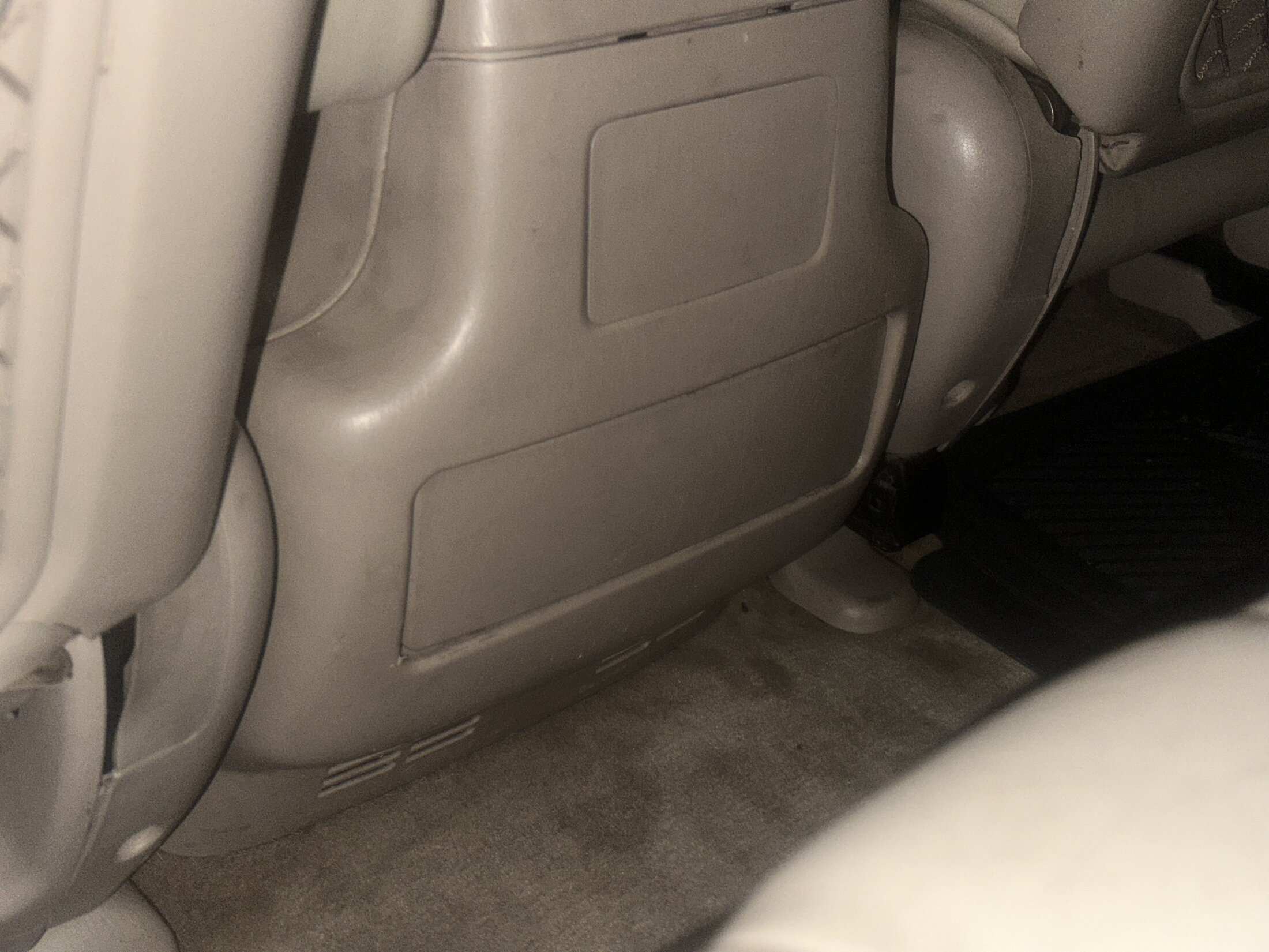

I see there are two different options heater hoses. one with rear heater?I See pic of my car below. Can someone confirm I do not have rear heater option ?
Best bet is to look at your actual hoses. You should be able to see the difference in sizes. Worst case, you buy the longer option and cut it to fit.
