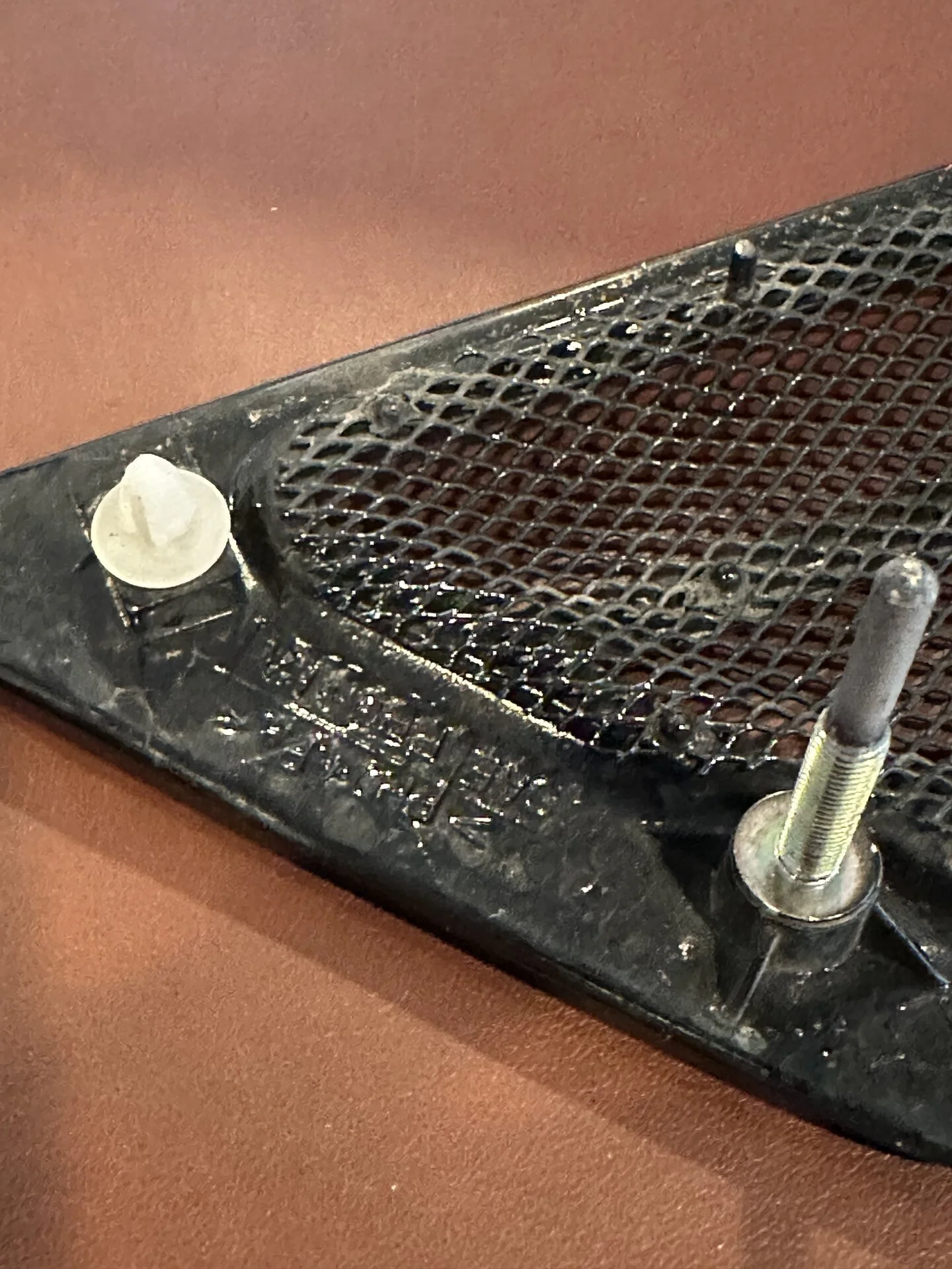

Looks like its just the rear upper plastic piece that needs to come off... here goes nothing!

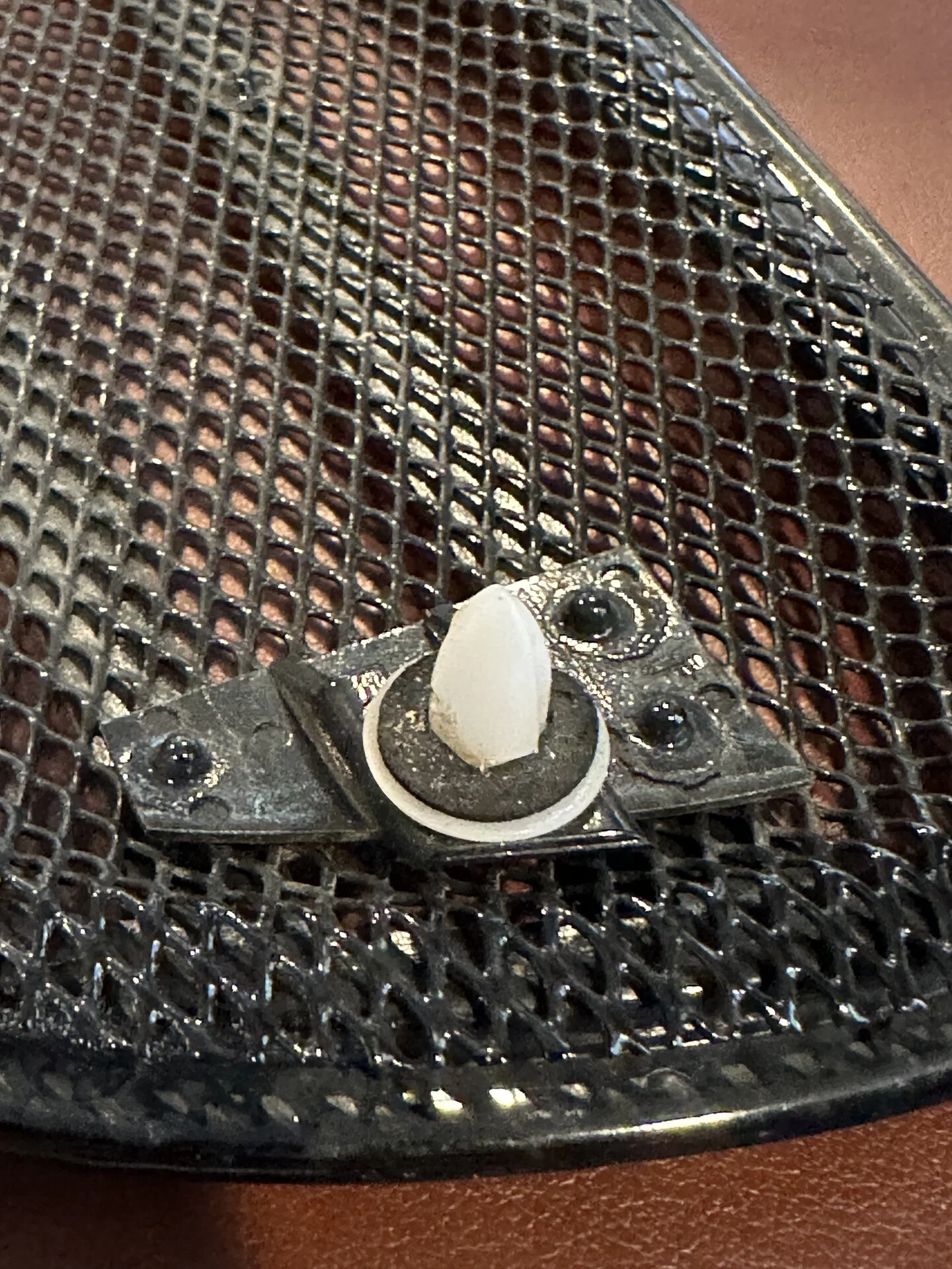

Now that ive got that info... can anyone help me source the tabs with the O-rings? Id rather use OEM before i look at alternatives.
AFIK They don’t exist separately- and the duct assy is NLA.

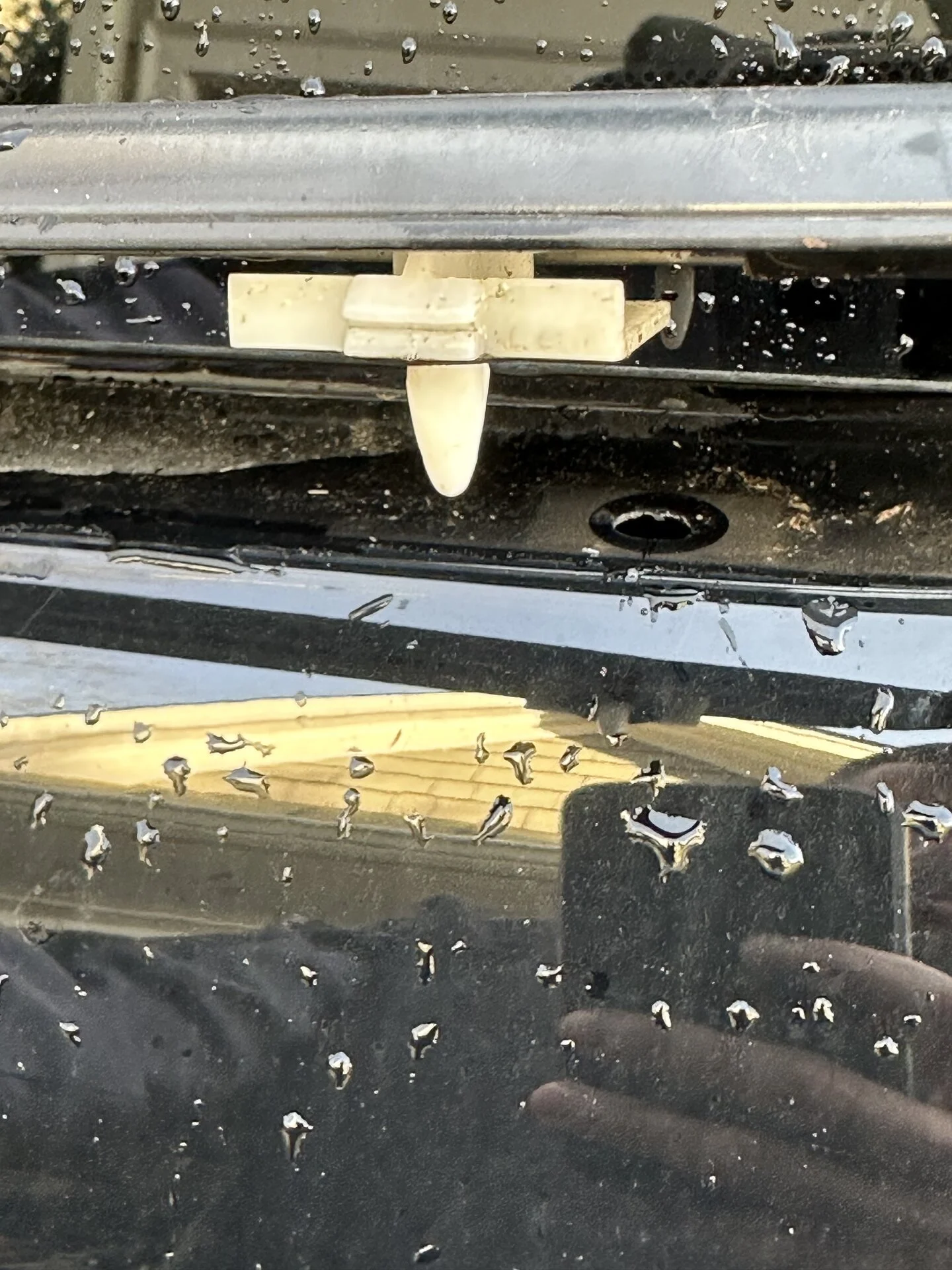

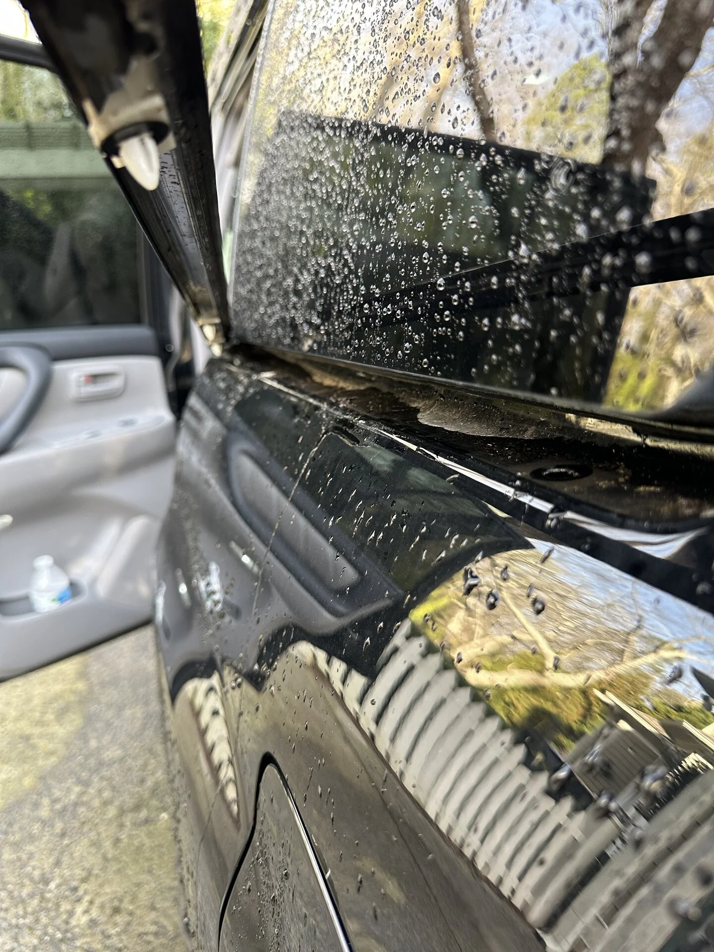

Checked all the usual suspects. The water was entering thru the rear vents and then draining down to the front pans… one side was missing two seals so off to the hardware store to source some new rubbers…
Wanted to update the thread. Finally found the leaky culprits. The lower exterior rear window trim… horrible design by Toyota. There are holes drilled directly into the sheet metal that the trim clips into using body panel tabs w neoprene washers. Well, those were shot so I made some new ones from Ace hardware. I decided to remove the rear windows for easier access and to clean things up a bit. Pressure washer tested and no leaks! I decided to do the other side too as a precaution since everything was already apart.
