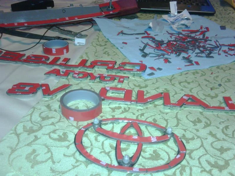

This pic shows the pins behind the sombrero and application of the 3M tape.
Hope this helps.
