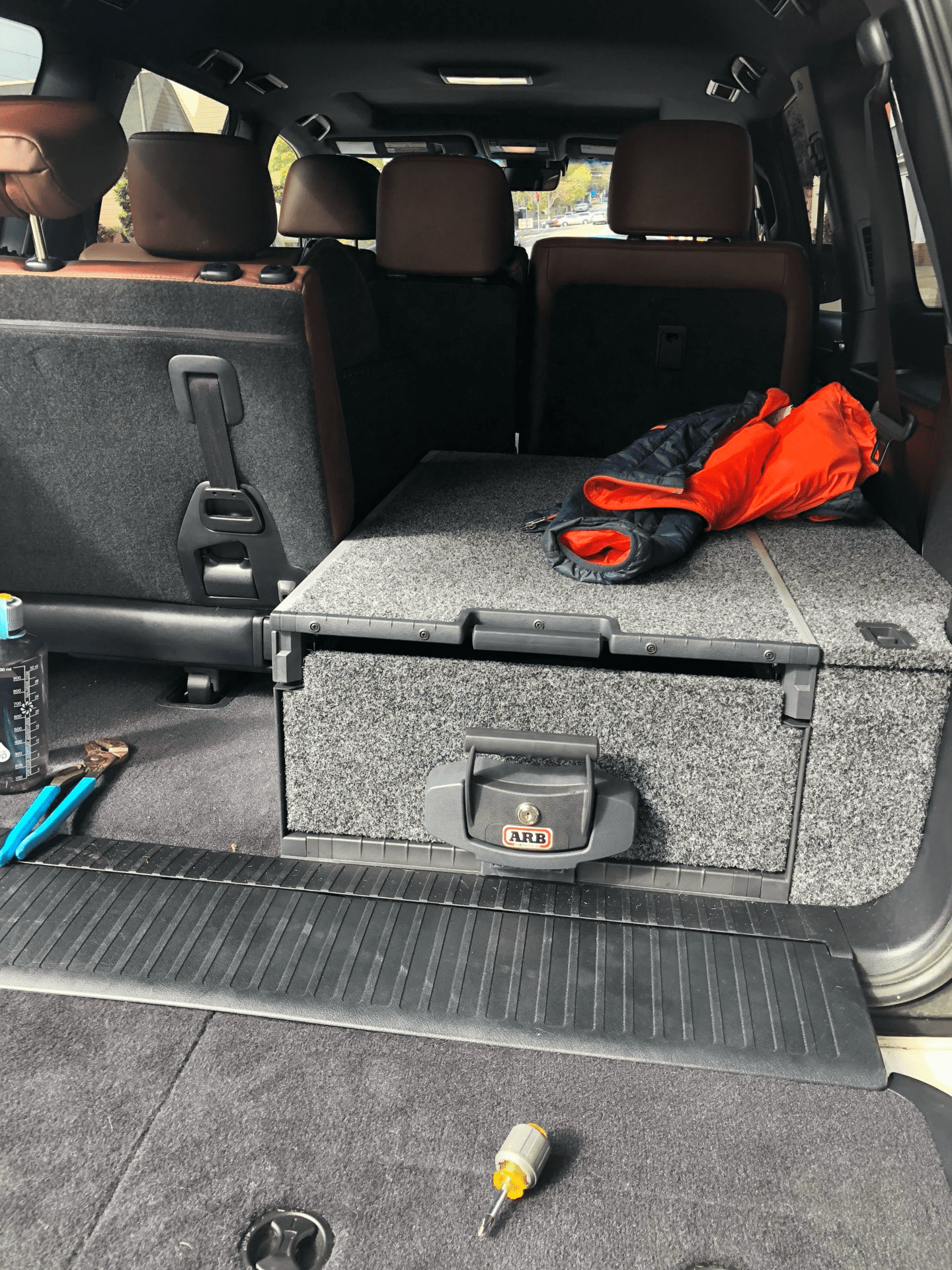

Do you need both 3rd row seats? Might be more options if you just need one occasionally. I'm hoping the single, low ARB drawer will fit with one seat in. That way I can have a shallow drawer and fridge slide and one seat. I have not checked the measurements.

I sure the low ARB drawer would fit too, either side.

Yep. Great solution if you need just one extra seat. If you go standard height, can sleep on top of it with second row folded flat and a pad.
ARB has also come out with a medium height drawer. ARB RFH1045 I'm putting one of those in next for the fridge. Gives a bit more storage than their roller floor (RF1045) which will be great for stove/cooking stuff.

Nice find. What I did is similar in concept but allows for a larger fridge:

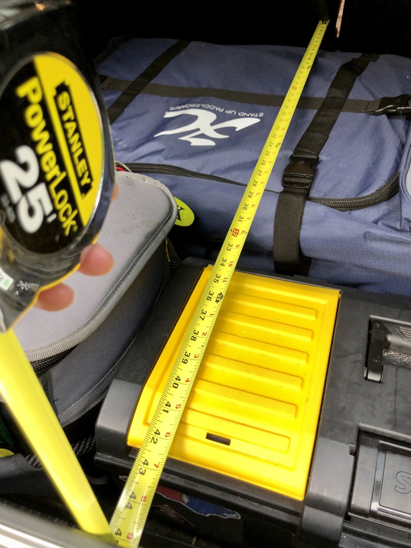

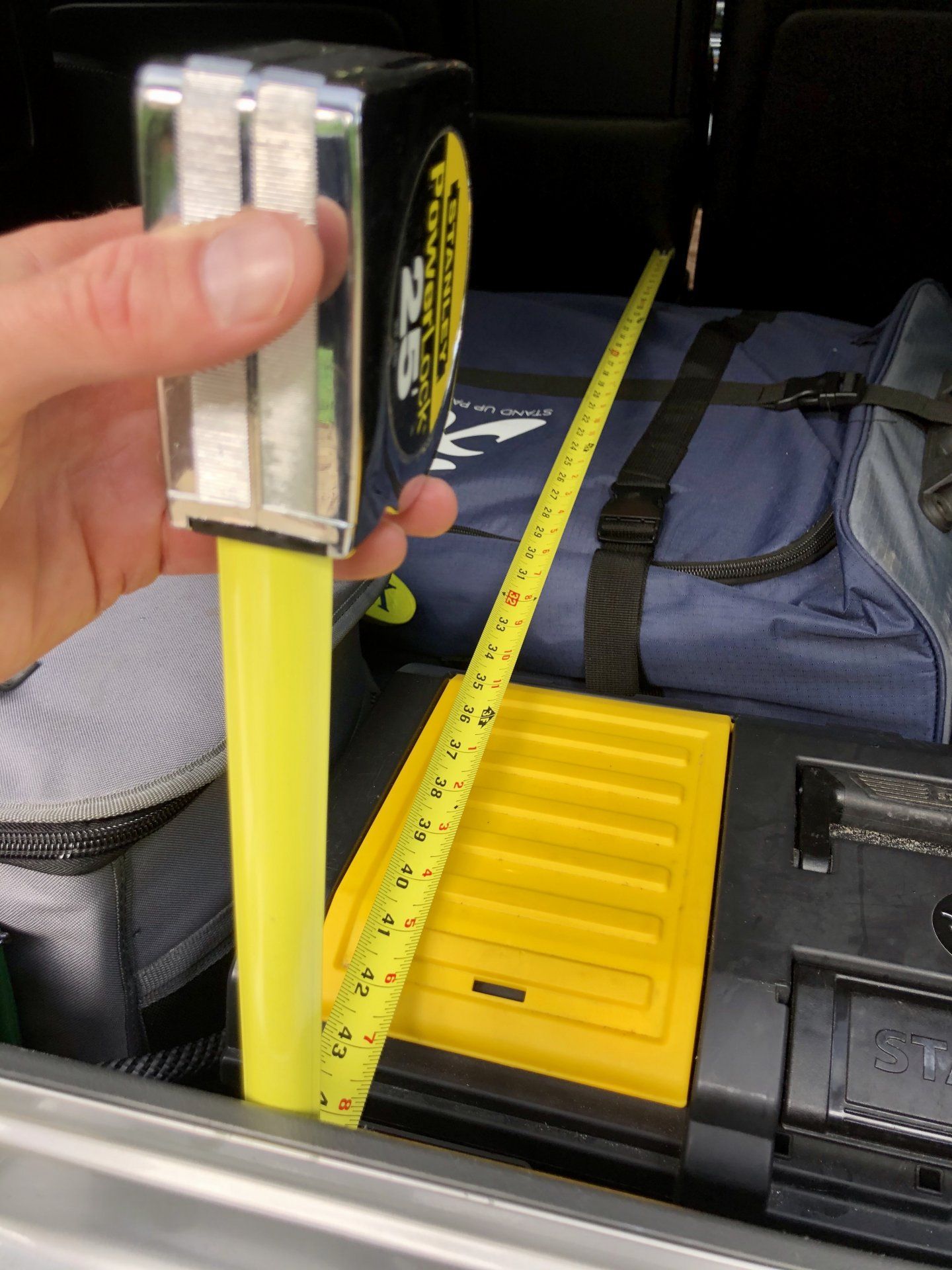

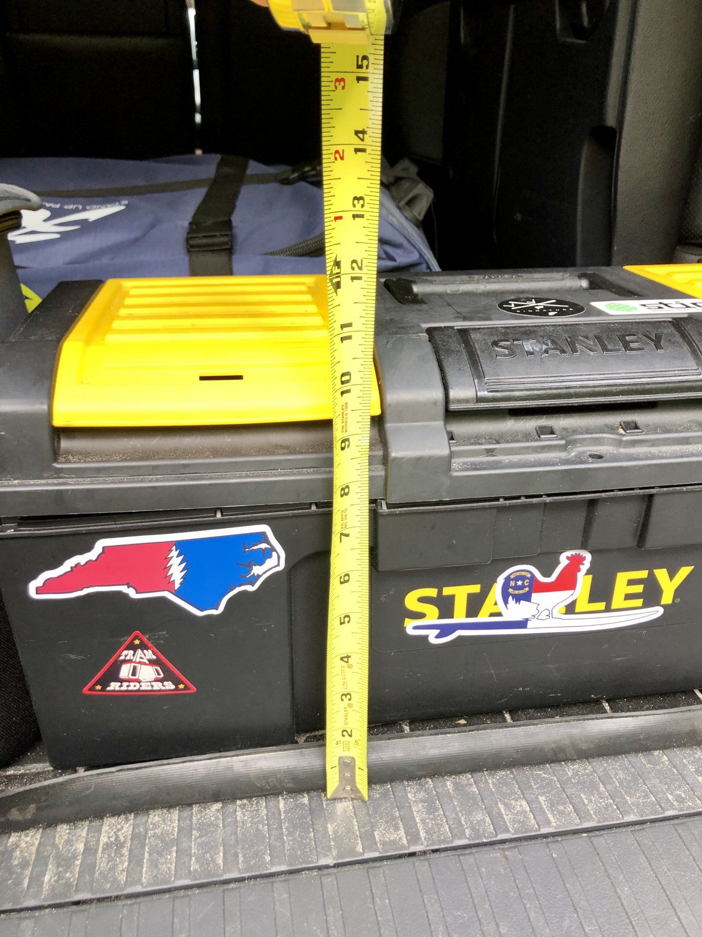

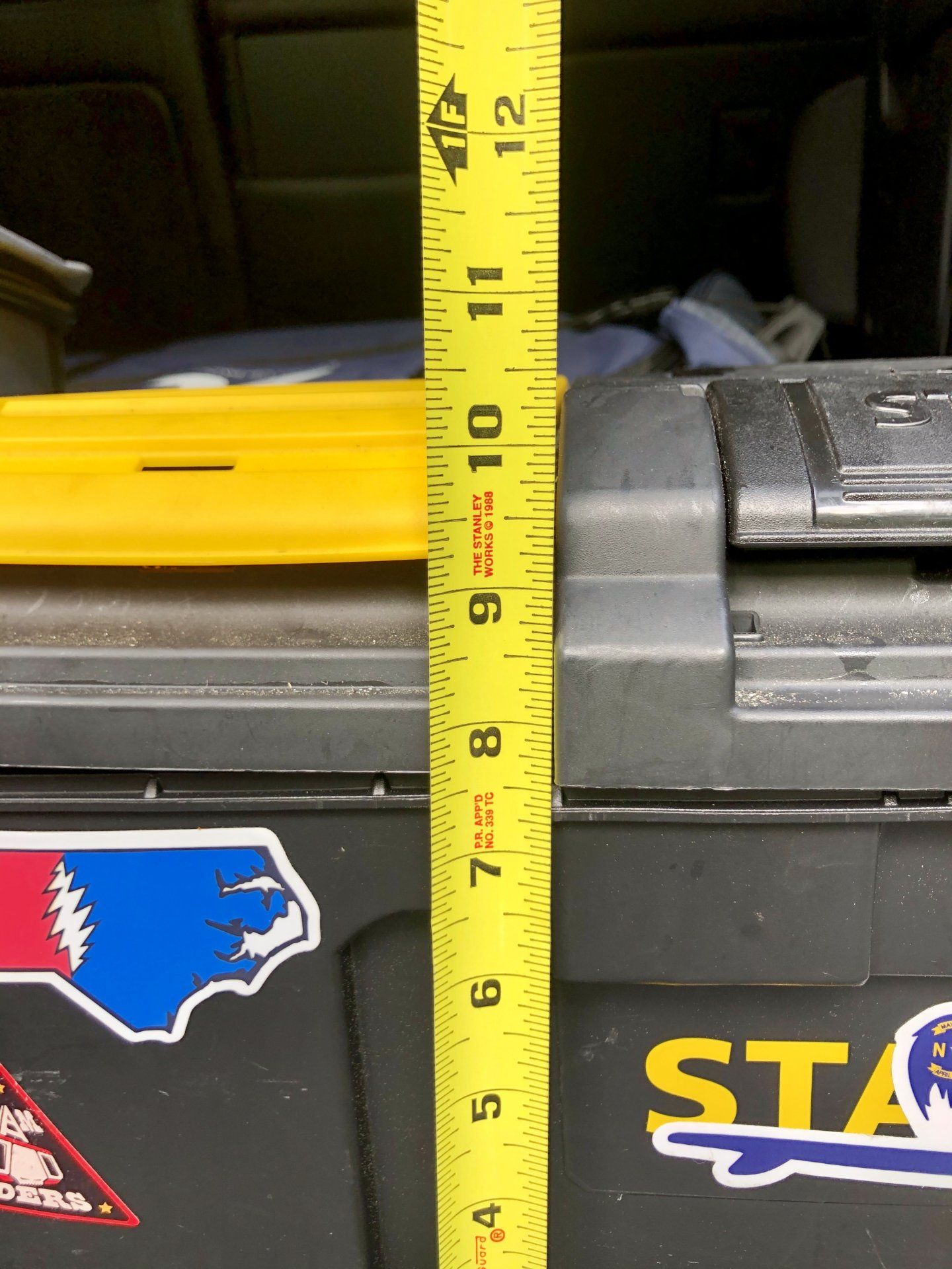

Curious on the dimensions, if you or someone has a moment, how far from the back of the closed tailgate to the rear seat at about 10.5" up from the floor?
I can measure it. Seat upright or reclined, in case it matters?
I think this is what you wanted. Was close to 45.5”. My toolbox was almost exactly 10.5” high.

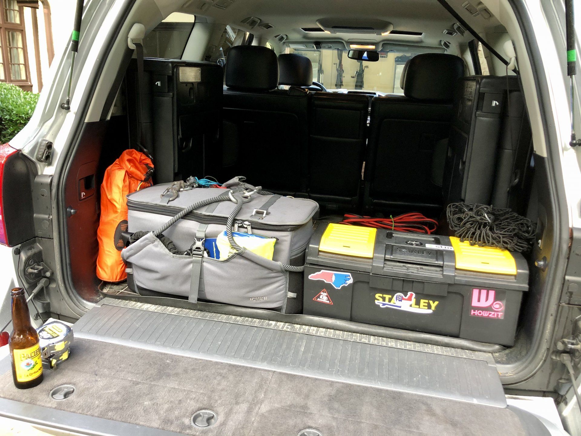

My current “system”. Holds my recovery gear, hose for the ARB compressor, tools, rack straps and surf gear, first aid, etc. Drawers would be awesome and clean. Plus a flat deck top would be better too. Thanks for all the info and help! Glad I’m on this site now.

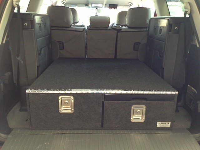

Drifta drawers a little more complicated to order, but man... the best drawers on earth if you ask me.
Look great! Thank you

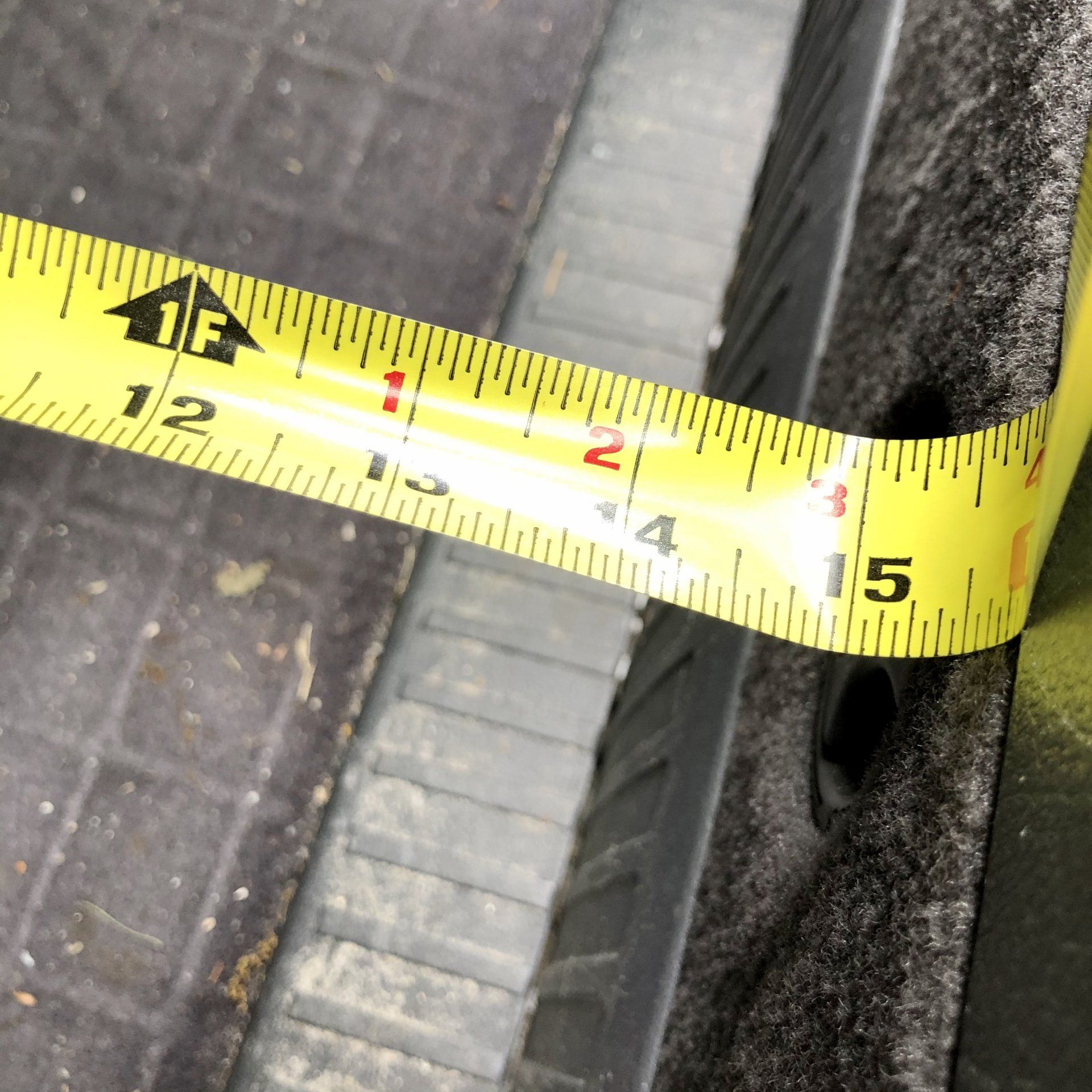

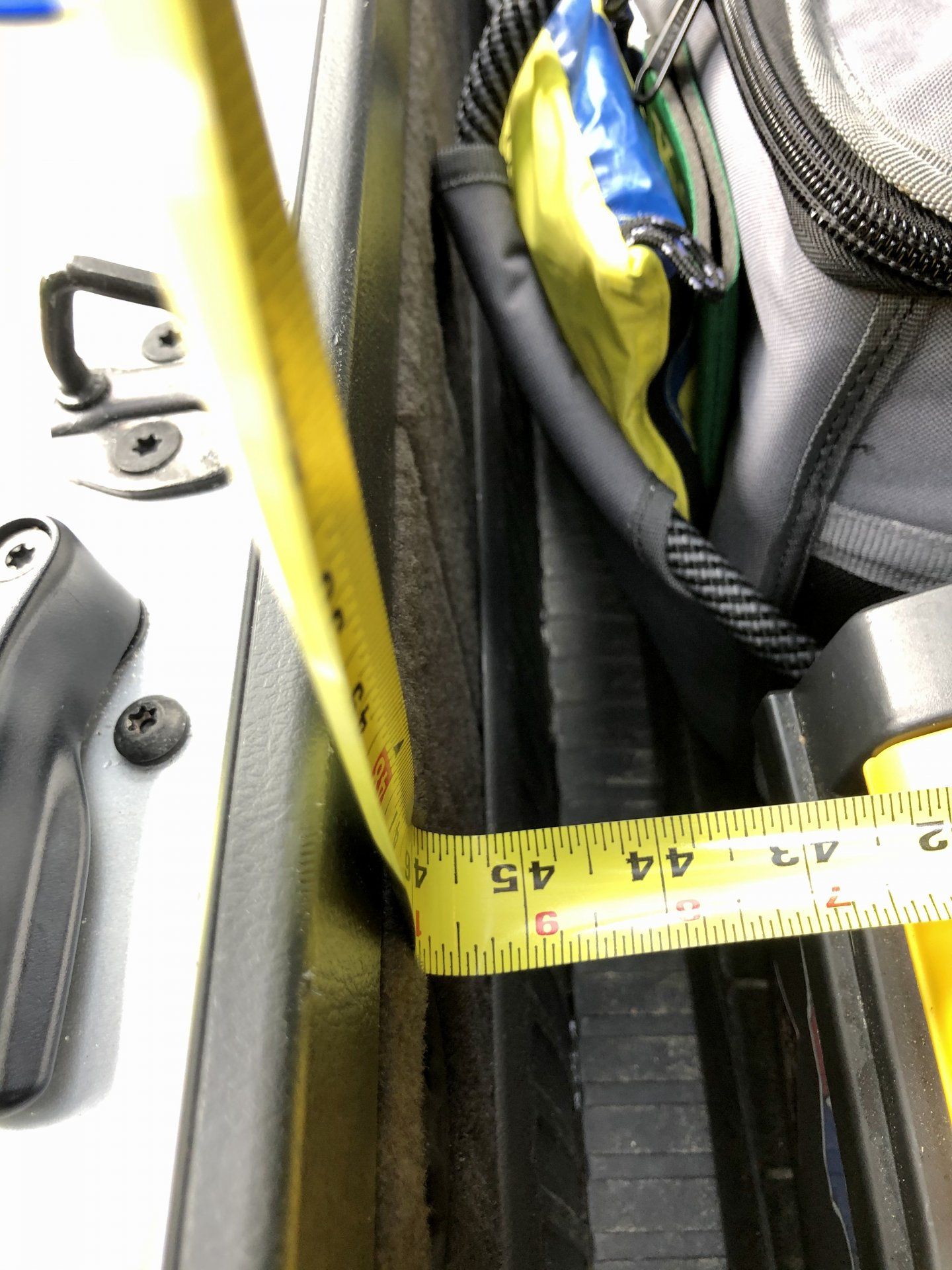

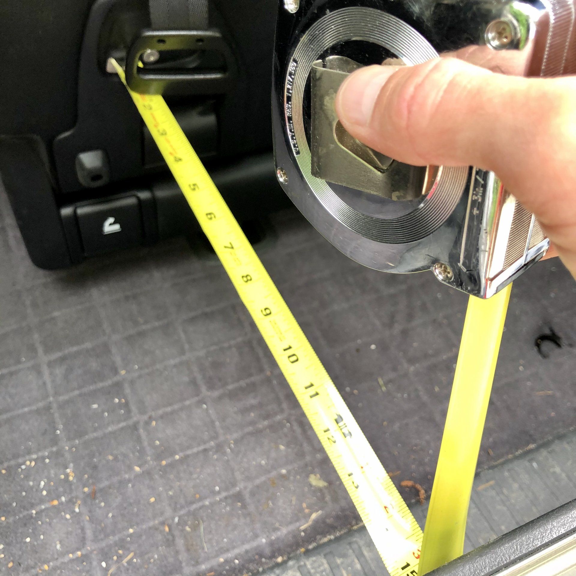

Hey, that's an awesome job measuring thank you, but unfortunately a lousy job on my part asking the question.... I'm good on dims for with no 3rd seat, Reef already growing in 200s there - was wondering from the back of the 3rd row seats to the tailgate- how tight is that???
Ha.. or maybe my bad understanding the question. I'll grab a few more measurements today
Not exact doing it by myself but about 15” to the tailgate with the 3rd row up at about 10.5”
