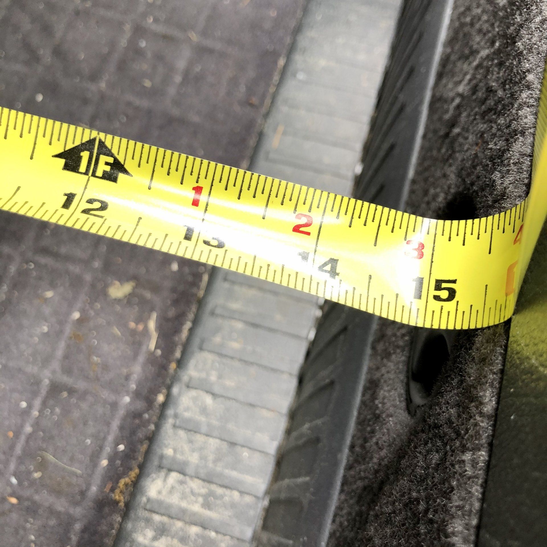

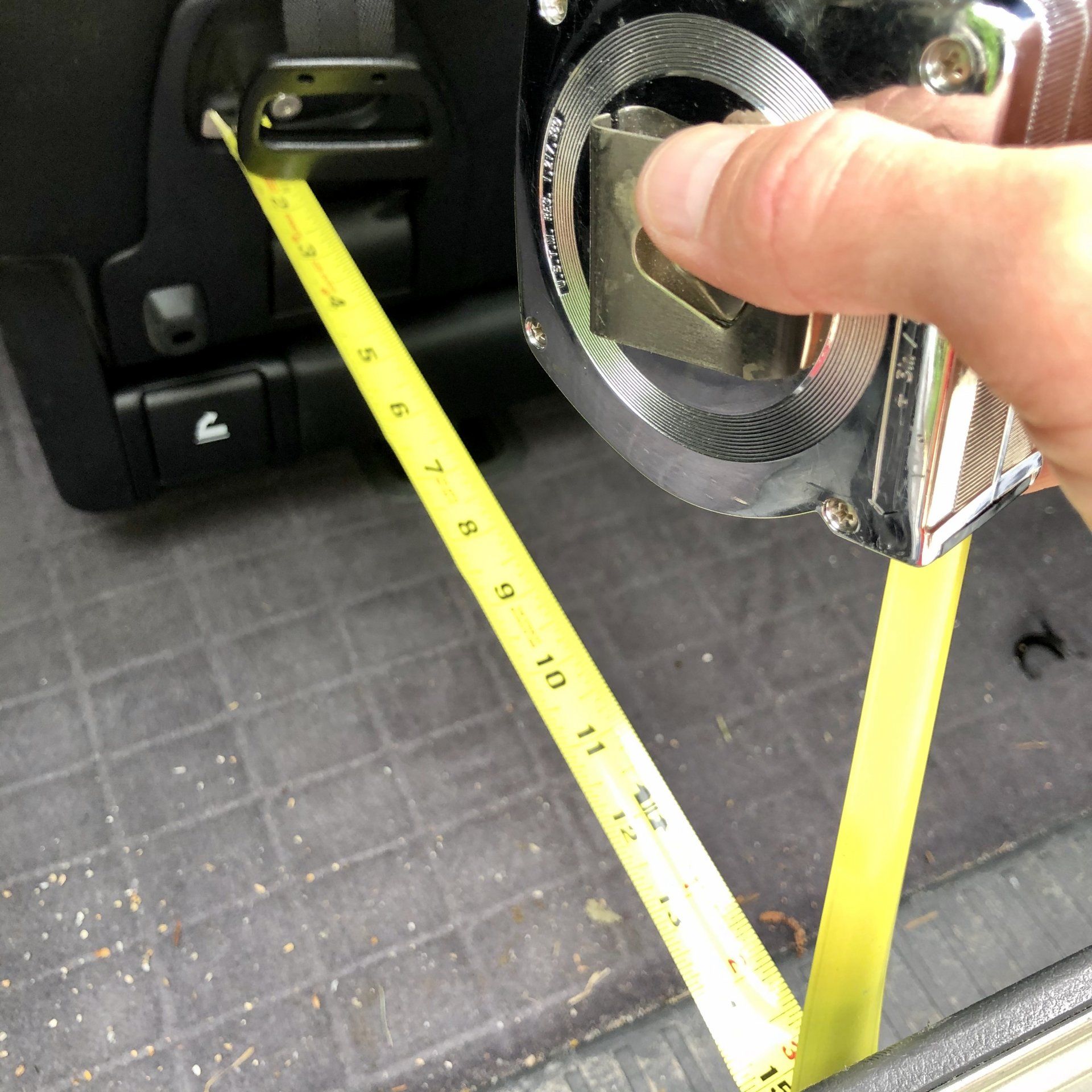

Not exact doing it by myself but about 15” to the tailgate with the 3rd row up at about 10.5”
Thanks for the measurement @Heel9094. That is even worse than I feared though, rules out another product I've been noodling on for Jeeps working here as well. Ah well can't solve all the world's storage conundrums ;)

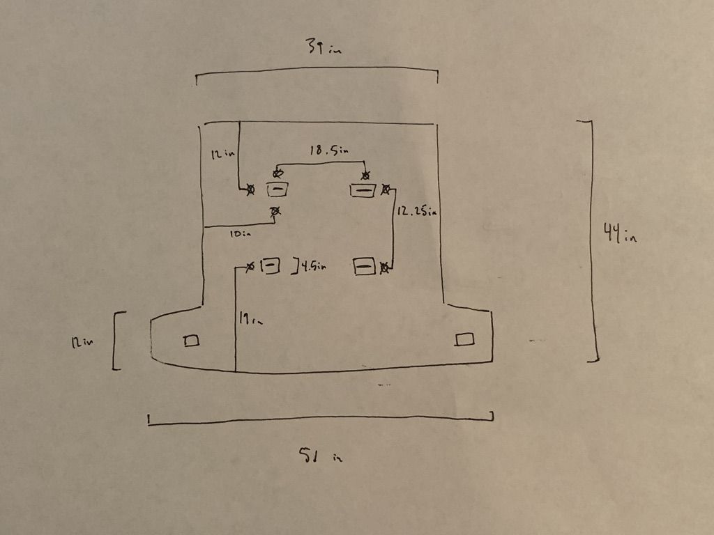

Hey @Heel9094 I'm sorry for the delay... no end in sight lately. I'm attaching a photo of the rough sketch I made of the workable space, and the two screenshots of what I ordered from TNUTZ.com and their lengths.
First, the area we can work with. I set the second row seats to the furthest back they could go, and reclined them slightly. Also, goes without saying, third row was collapsed and stowed in the upright position. Thank you for flying with us. They're not the most exact measurements, but they worked out pretty well for me (I'm a 2010 LX, so I'd assume the 09-15 LC's should be roughly the same dimensions. AMENDED: The measurements to the 4 mounting points for the base of the third row seats are made to center-center of the metal bar. Anything measured front to back is measured to the axis of the metal bar. Anything measured side-to-side is measured to the lateral midpoint of that metal bar.
Second, what I ordered. Below are the screenshots of my materials. I wish I had a good way of conveying the assembly. I am blessed with a pretty good visual memory, so unfortunately I'm garbage at passing along the assembly instructions. I'm the anti-IKEA. I will say that I wanted to maintain use of my grocery cargo net, so I left unused space between the front edge of the drawers/platform, and the tailgate. I know that my two 2x1 segments were cut to 36", and run front to back of the drawers. I believe that the 36.5" segments run side to side, with a further length-wise 1x1 segment butted up to that on either end, for an overall footprint measuring 36" x 38.5".

If you follow in my footsteps on the order, you might have to play a little Tetris to get things to fit together cleanly and as-intended, but what I'll say is that if you aim for that 36x38 footprint, you're going to be safe. I think I included details on the Target bins that I used as drawers in my original write-up posted above, but if not, I just remember they're the [61?] quart clear bins for $10 each.
