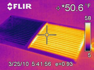

It is getting power to the connection? You’ve checked everything up to the glass?
Yeah it's getting power. It's the grid itself that's shot after years of stuff scraping against the lines and breaking the connections. I thinkI have maybe two lines that actually work on it now.
