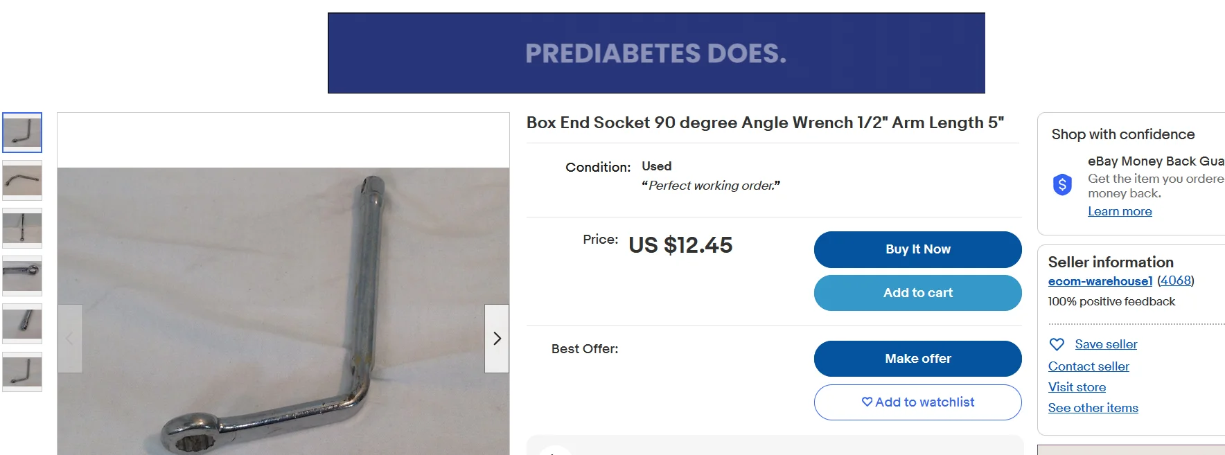

Drill a hole in the frame, next to the hole you want the nut over. Use a 90° open end wrench in that hole to hold the nut while you turn the bolt. Or use a crow's foot.
Something like this:
Or, you can use the same method to get a weldnut inside the frame, weld it from the underside. Not the preferred method of installing weldnuts, but it'll work.
These holes are all over the frame; the manufacturers call them tooling holes, because they're used to get tooling into the frame while it's being manufactured.

Thanks, I had no idea a tool like this existed. Finding a 19mm or 3/4" seems to be challenging but now I know what to look for.
