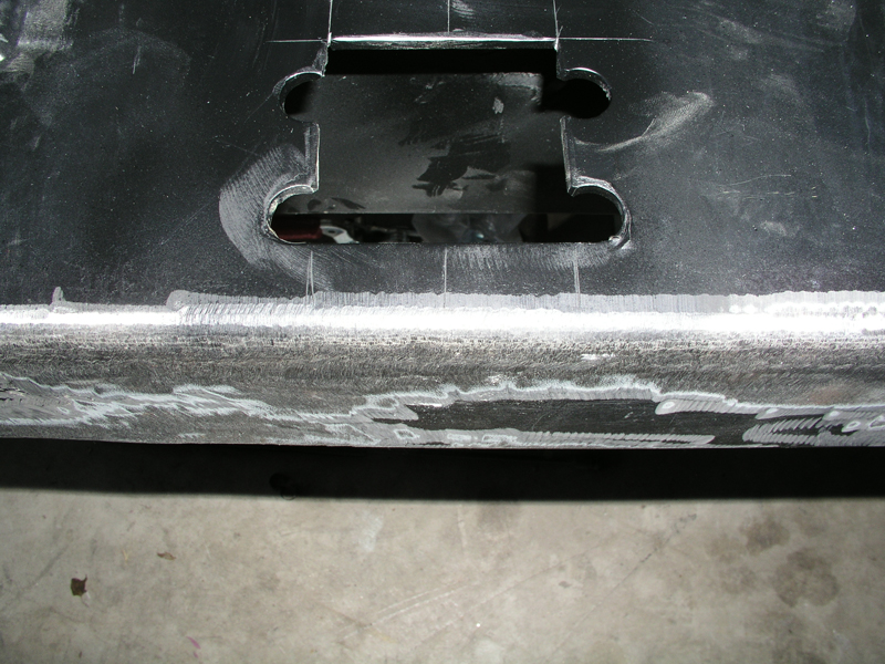

What you are doing now mounting the Draw-Tite is currently the safest way to do things. I think slee has the most stout and safe hitch out of all the aftermarket bumpers since his mounts to the frame with triangulated supports. But even Cristo doesn't recommend towing anything too heavy. Many of us believe that he is just covering his AR$E and that it is pleanty stout to tow a boat or a light trailer. But a triler and a vehicle would be pushing it IMHO.
I personally had my Hanna Bumper modified when I was refurbishing it to accept Slee's 2" hitch and plan to tow a light 18' travel trailer in the future so a plasma cutter to whatever bumper you choose and maybe chosse a bumper that maintains the rear cross member for additional strength.
