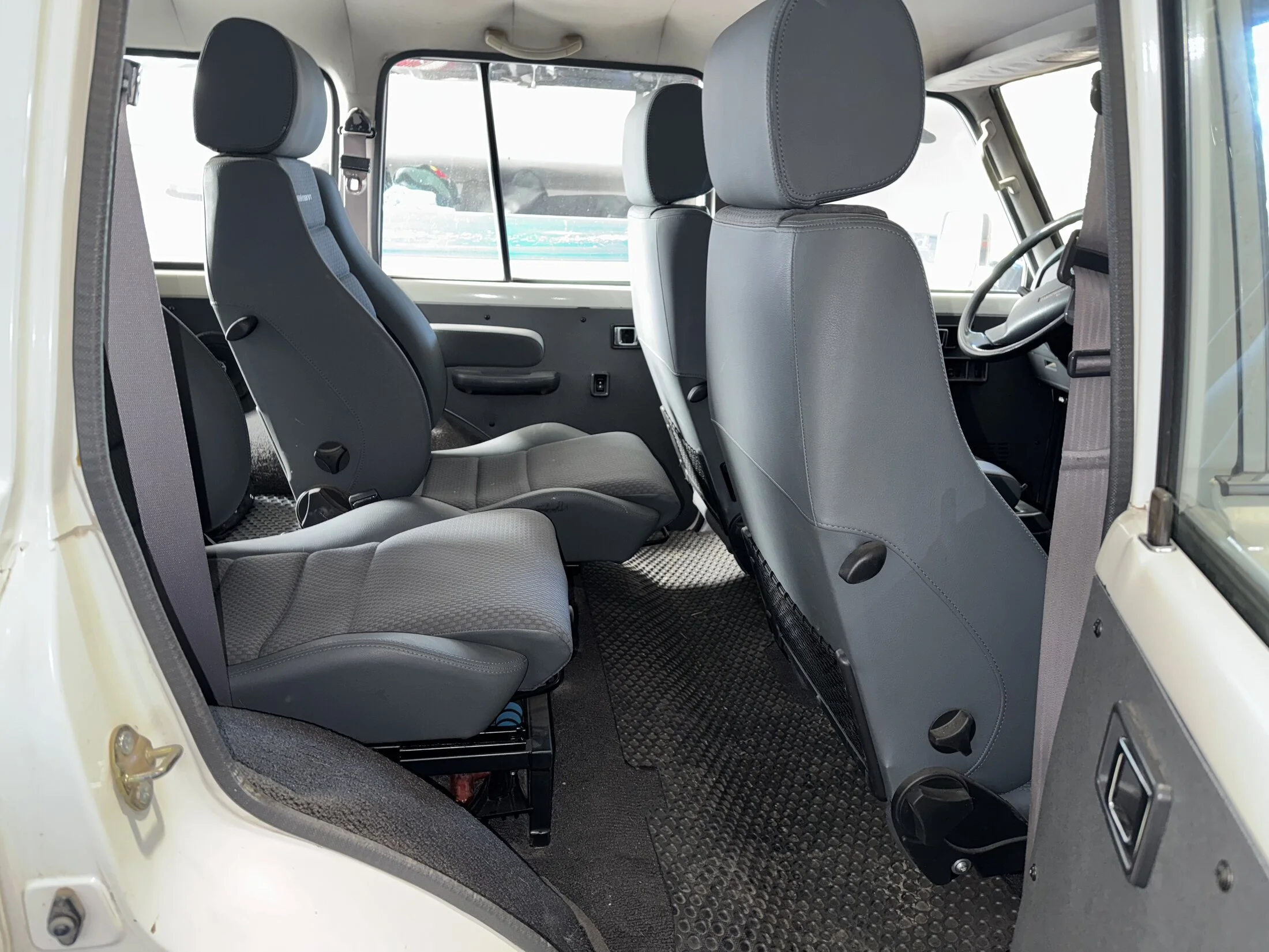

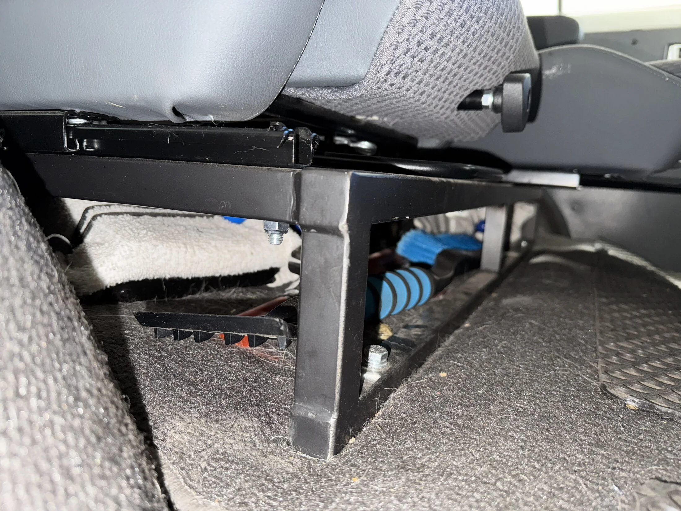

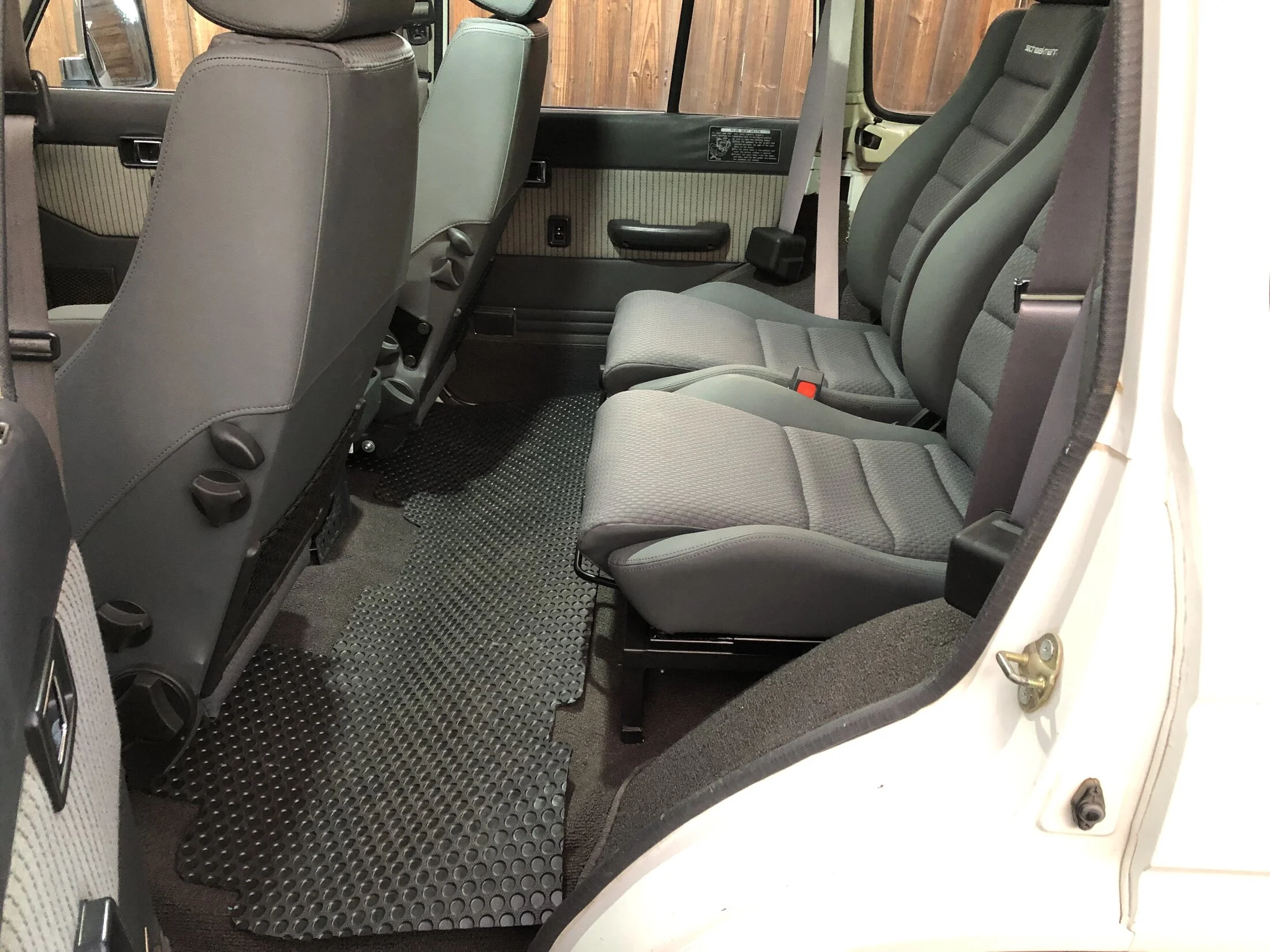

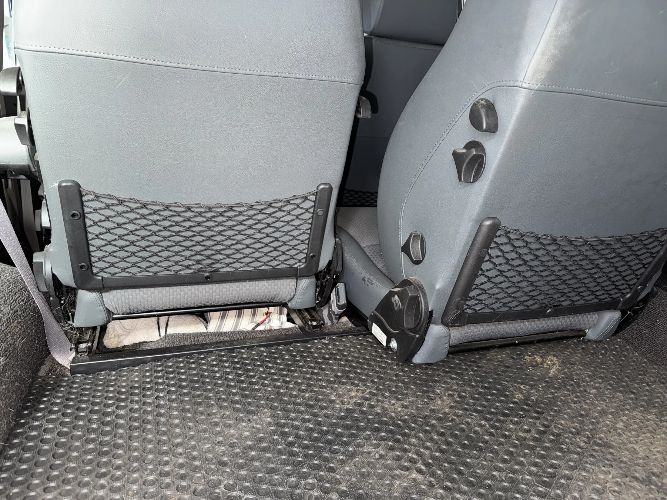

I used Vario XLs in front and regular Vario’s for the 2nd row. We fabricated a mounting frame out of 1” square stock, powder coated it and used Toby’s sliders.

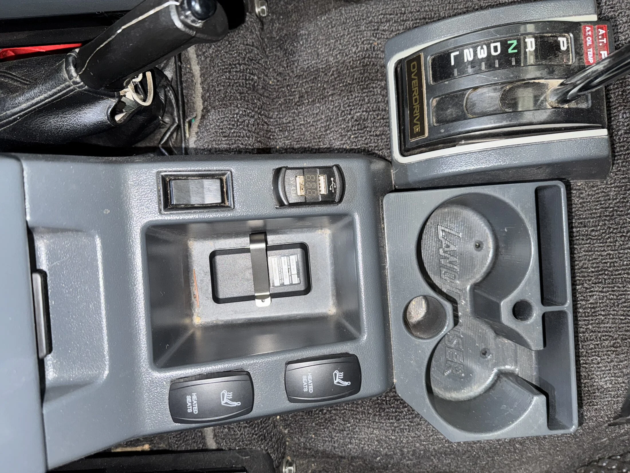

The sliders allow about 10” fore-aft travel. Usually, the seats are as far forward as possible to give the dogs the most room in the back. The seats are heated, which makes it comfy in the winter. Our kids always use the truck when they come over to ski.
