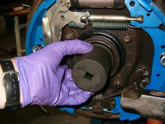

I used a socket the right size. I assume you are looking to drive in a rear semi-float bearing. No way you should ruin a set. They go right in with no freezing or other special issues. I think it was a Dana 60 hub socket that fit the best.

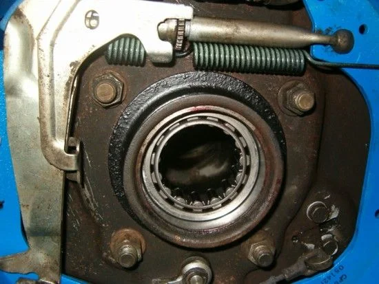

Saw this thread when I was searching for tips on installing the new bearing/race. So wanted to add to the thread for future references.
I was going to use the grind old bearing method but when I was at AutoZone to rent a slide hammer I noticed they had bearing driver set for rental too. Kind of like the Harbor Freight one. Worked great and it was free! So much easier then using brass drifts.
