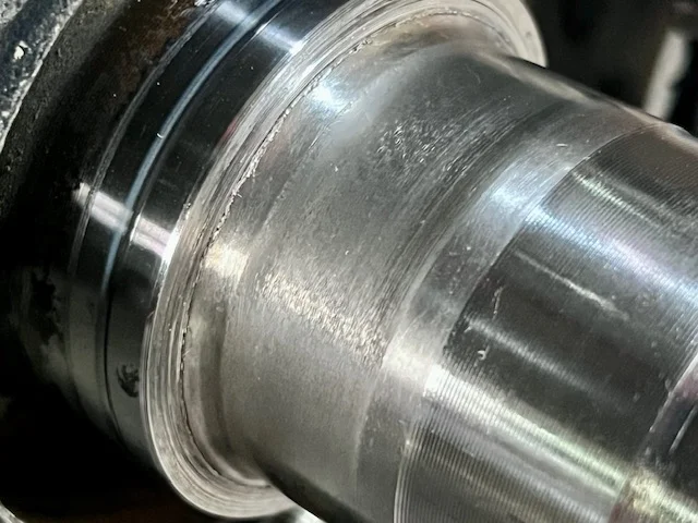

So one of my rear axle spindles got a bit damaged. Not enough preload I’m guessing. I can’t really feel the edge with my fingernail but …
What’s my best line of attack here? I know back the day we’d knock a few cuts in with a chisel to make sure the new bearing doesn’t spin.
Is there a better way?

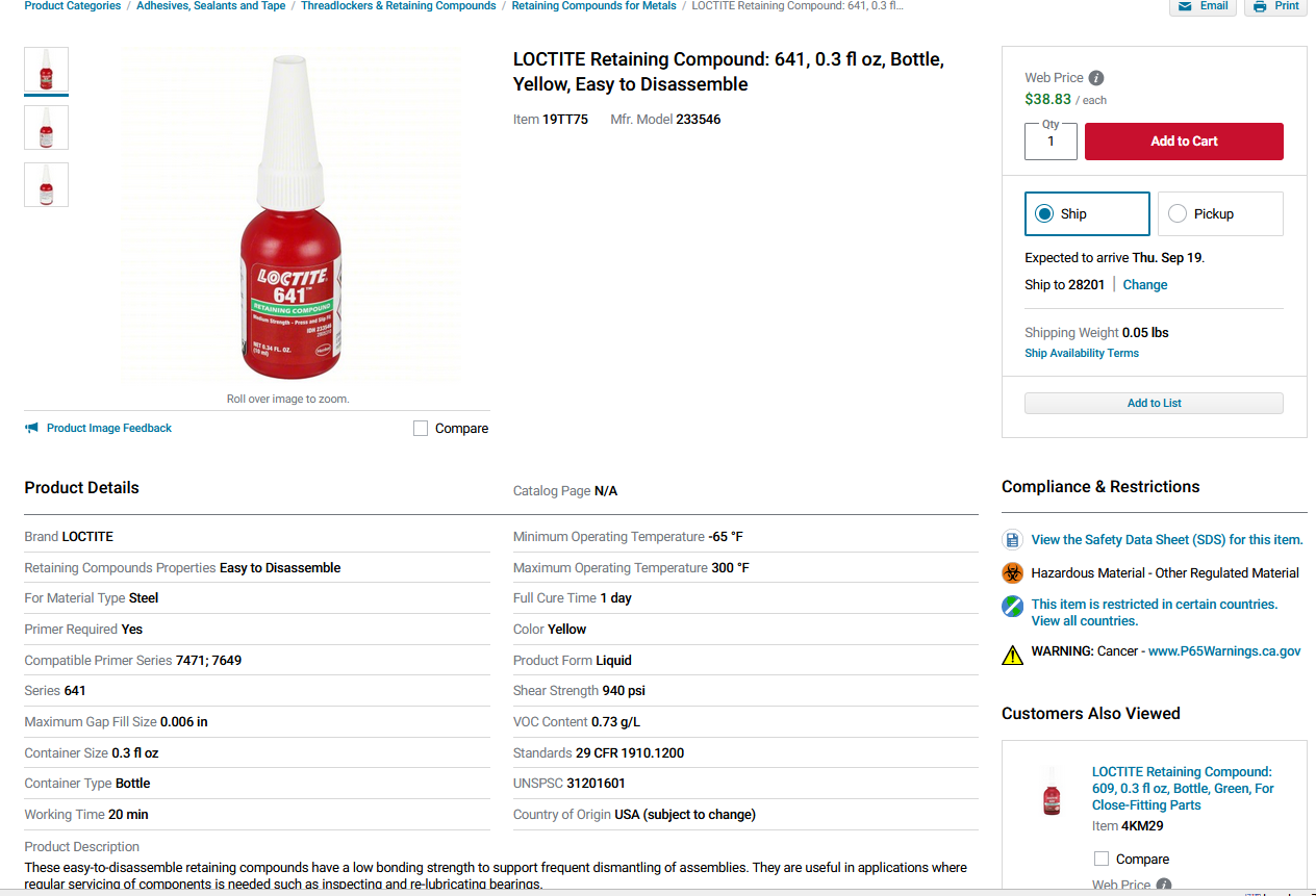

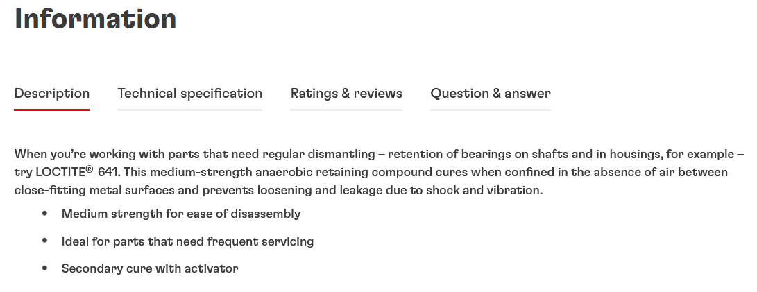

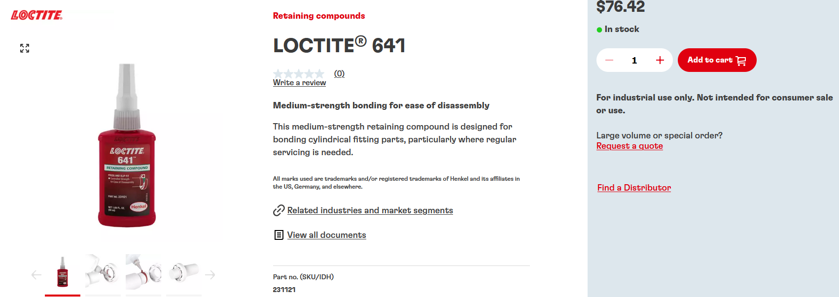

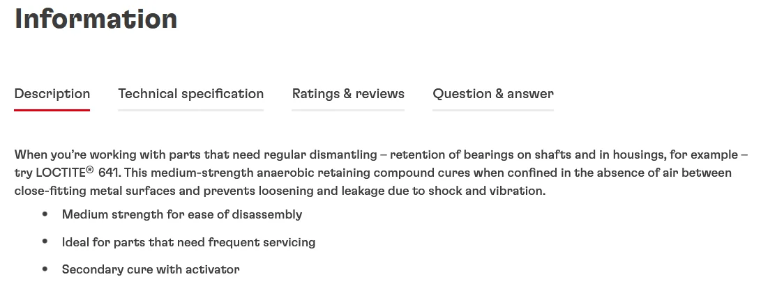

The rear bearing cone is a slip fit on the axle. The cup(s) is/are press fit into the hub. Personally, I'd Loctite 641 it in place, if I was really woried about it spinning, that way I could get it off. If you stake it, the axle is staked forever.
Grainger has it:
The problem with staking a bearing is that you absolutely have to get it seated and keep it that way, while you're staking it, or it'll be cocked when it's staked and won't run true. Then you'll have a worse problem than you had when it was just loose.
Grainger has it:
