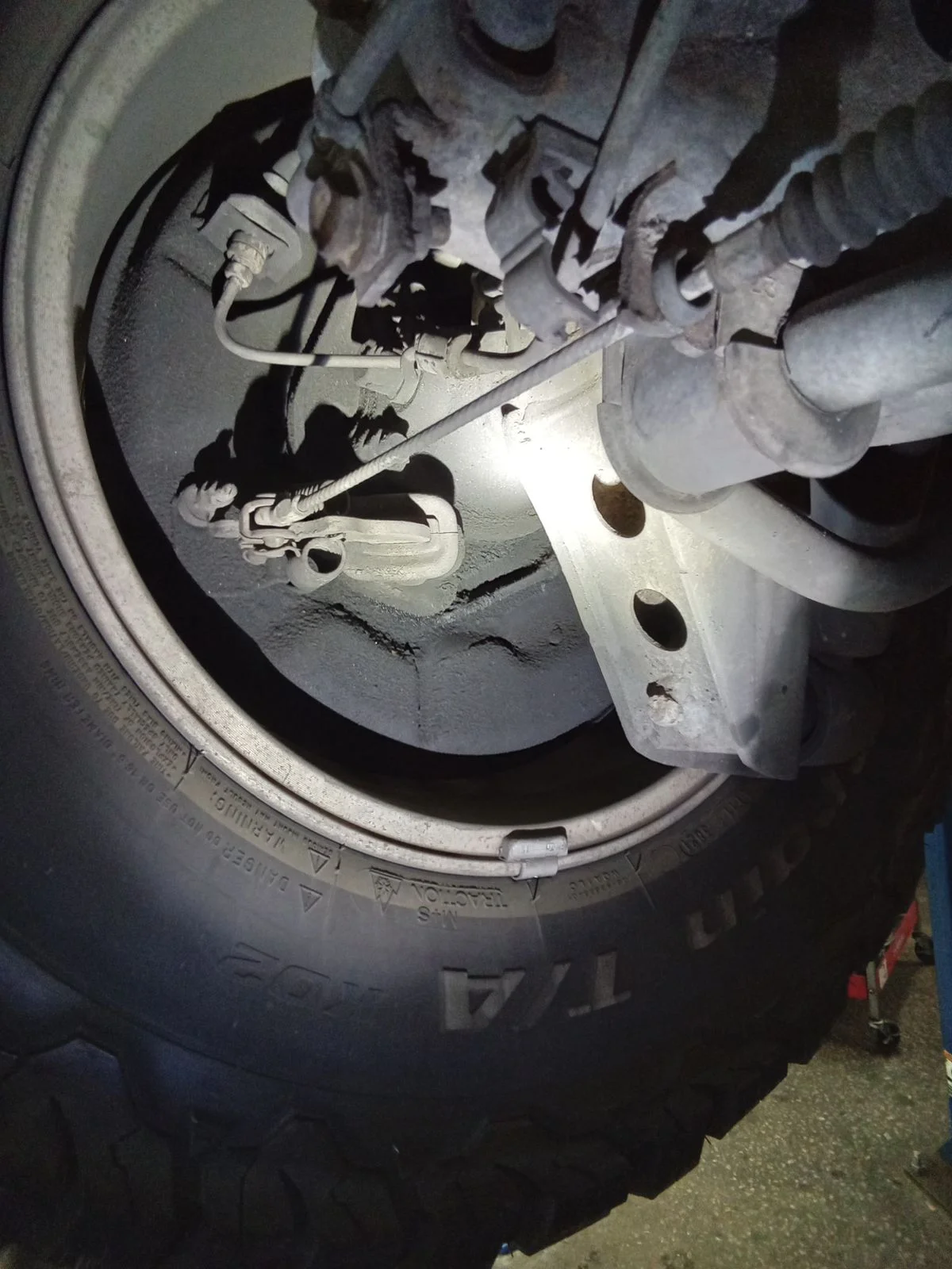

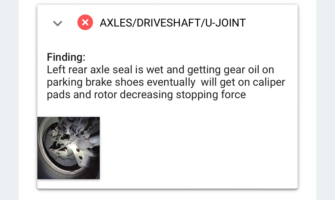

Wow that seems very involved I guess I get the cost now. Thanks for brining me up to speed! Obviously I know it’s extremely hard to tell over a photo but how bad do you think this leak is (with mechanic comments):
When you see actual drips, replace it. Dusty grime and weepiness is probably not an emergency. In all honesty, the leak has to get pretty bad to affect the disc brakes. It will compromise the parking drum brake before it gets to the actual disc rotor.
Got it thank you so much. Honestly I’ve just seen dusty grime residue and even the mechanic said it’s not urgent but will eventually need to be addressed. I’ve never once seen actual oil dripping!
Compared to how mine looked (in the original post), your looks fine, just keep an eye on it
