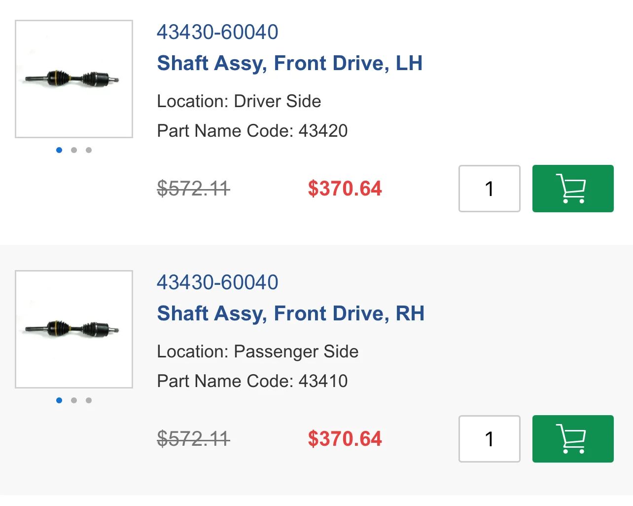

I’m not sure what the deal is now but Toyota used to sell new and reman axles. The reman’s were PN 43430-60040-84. Seems they don’t sell those anymore. I haven’t heard of dealers selling reman’s as new but I admittedly don’t spend as much time looking at the 100 series forum as mine hasn’t needed axles yet, just a reboot.
Decatur is one of if not the cheapest sources for parts I’ve found in the US. Free shipping too on most big dollar orders.

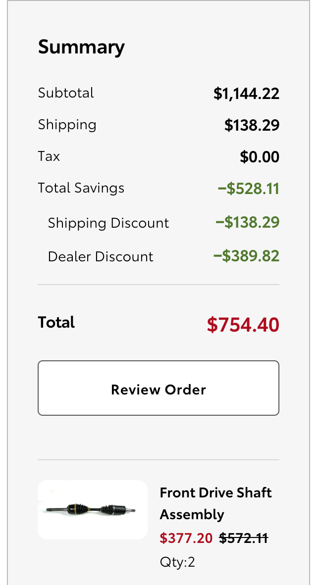

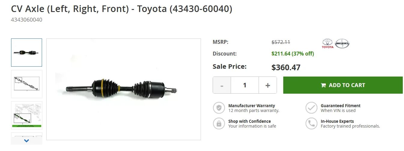

This is the right picture, but that doesn't mean it's the part they're selling:
I just don't believe it's OEM, for the price.

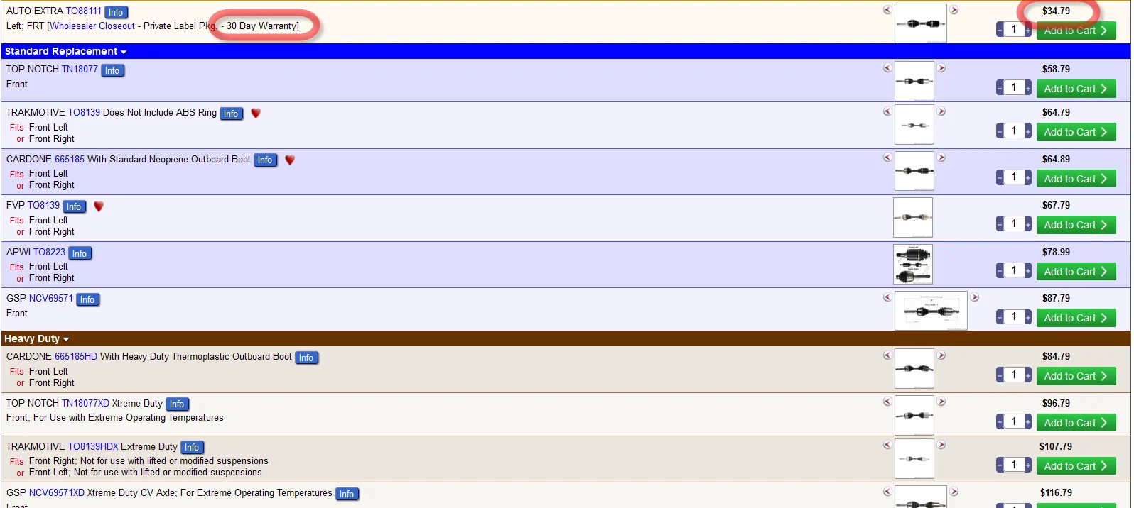

This just in, from the FWIW department:
If you're looking for a trail spare (or two), Rock Auto has just the thing!
...and they even come with w/ a 30-day warranty!
From what I can tell, the difference between the "standard duty" and "heavy duty" is the neoprene boot on the HD models; makes me wonder what they're using for a boot on the others 🤔

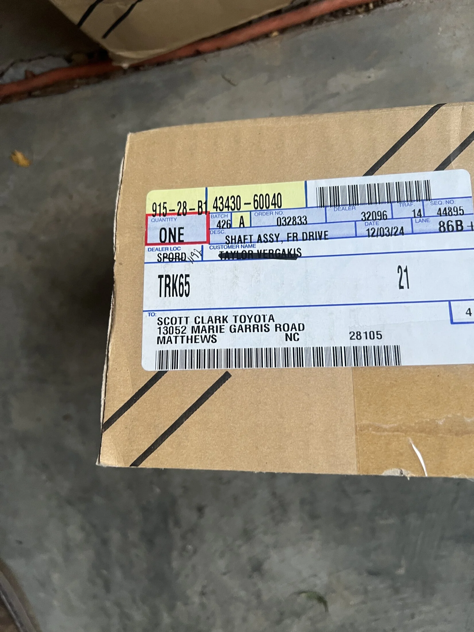

From my experience, the new Toyota CV's are boxed in the typical red and white boxes with legitimate Toyota part number labels. What is inside are new Cardone axles. Maybe @OGBeno can confirm this for us?

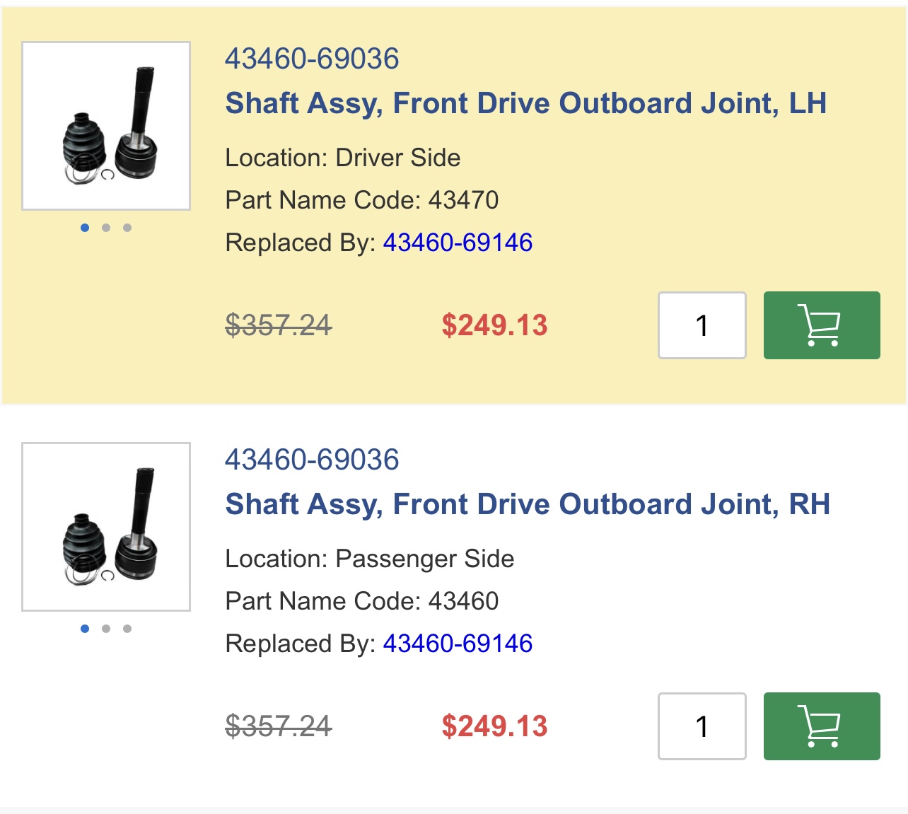

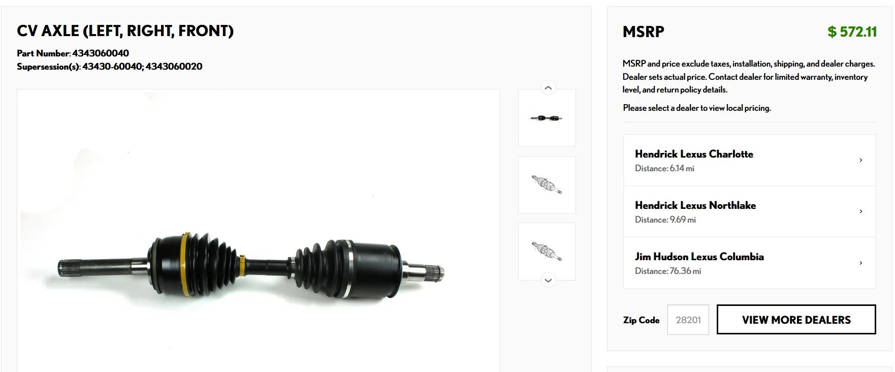

Even Lexus retail is cheaper than the cheapest I could find direct from Japan:

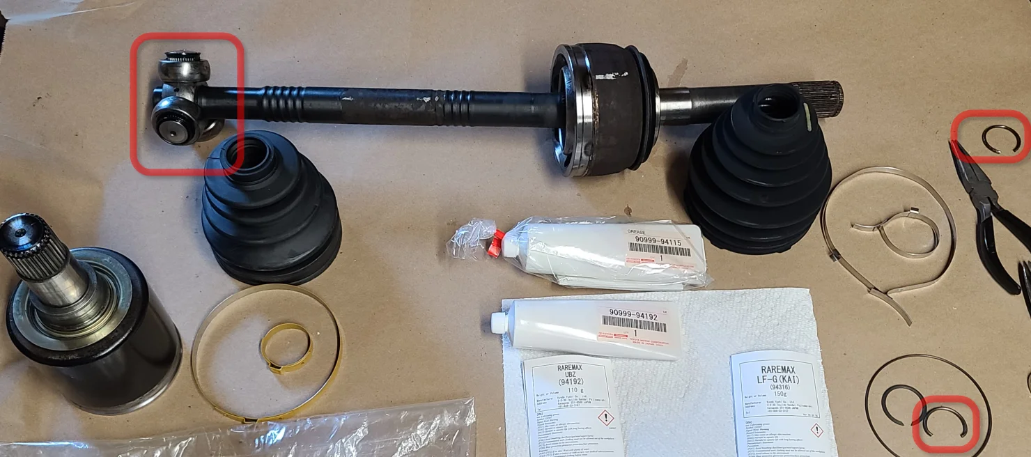

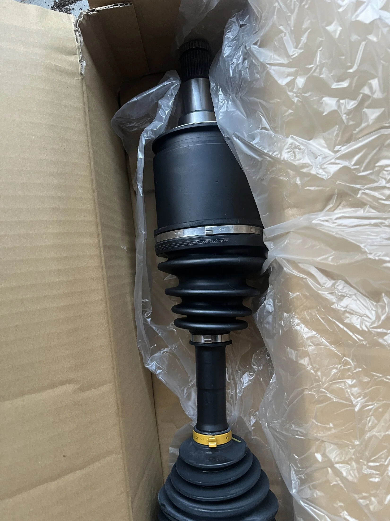

Just so everyone is aware of the problem, here's what the fake joint looks like:
Without removing the boot, you can "see" the axle is a Cardone by pulling on the outer shaft. The inner three lobed needle bearing joint will slide out of the housing, because Cardone left the inner snap ring (wire) out when they redesigned the axle for the aftermarket. That isn't a big deal, IMO, but the size of the joint is, again IMO.
The inner joint should look just like the outer: similar to an 80 series birfield with a double cage and 12-mm balls.
Also, to add insult to injury, they replaced the inner (differential) retaining ring (lower right) with one they found on the floor somewhere (upper right). This damn thing will not release no matter how much you pound on it. You can see the difference between the retaining ring Toyota designed, with the large gap) and the one Cardone chose (with nearly no gap at all). The closer the ends of the wire are, the harder it is to get them to separate under load. Cardone wins the prize for "a cheaper engineered alternative" by using a commercial off-the-shelf retaining ring, instead of the design Toyota came up with, intended to aid in service.
Of course, Cardone never has to remove one of their axles, so it's of no concern to them.

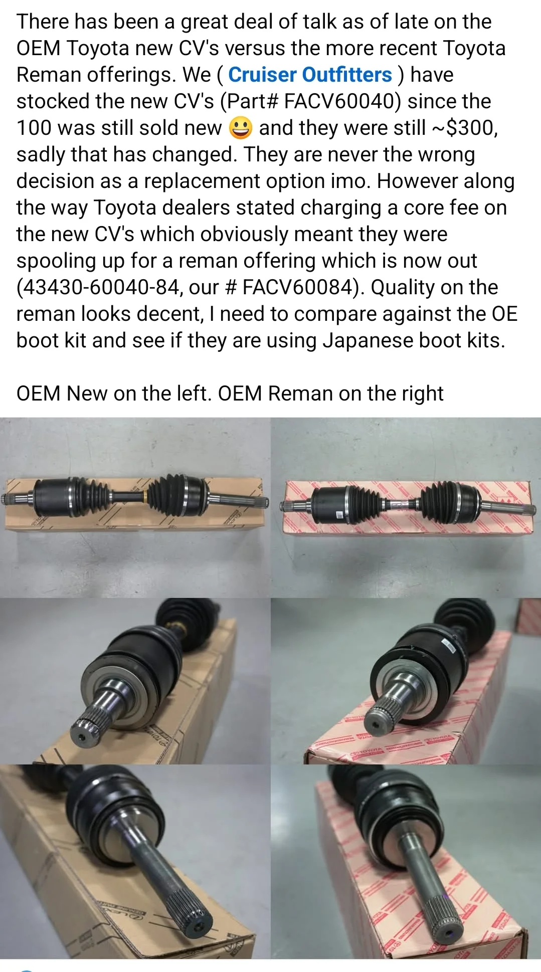

Toyota was offering reman 100 CV's recently, part# 43430-60040-84. They were not amazing quality imo and the boots were not even their own Japanese kits. Decent budget option but the full new unit is far superior.
They are charging a core on the 43430-60040 at some dealer networks so I suspect remans may be coming again.
Here's a screenshot of ab old post of mine about the remans

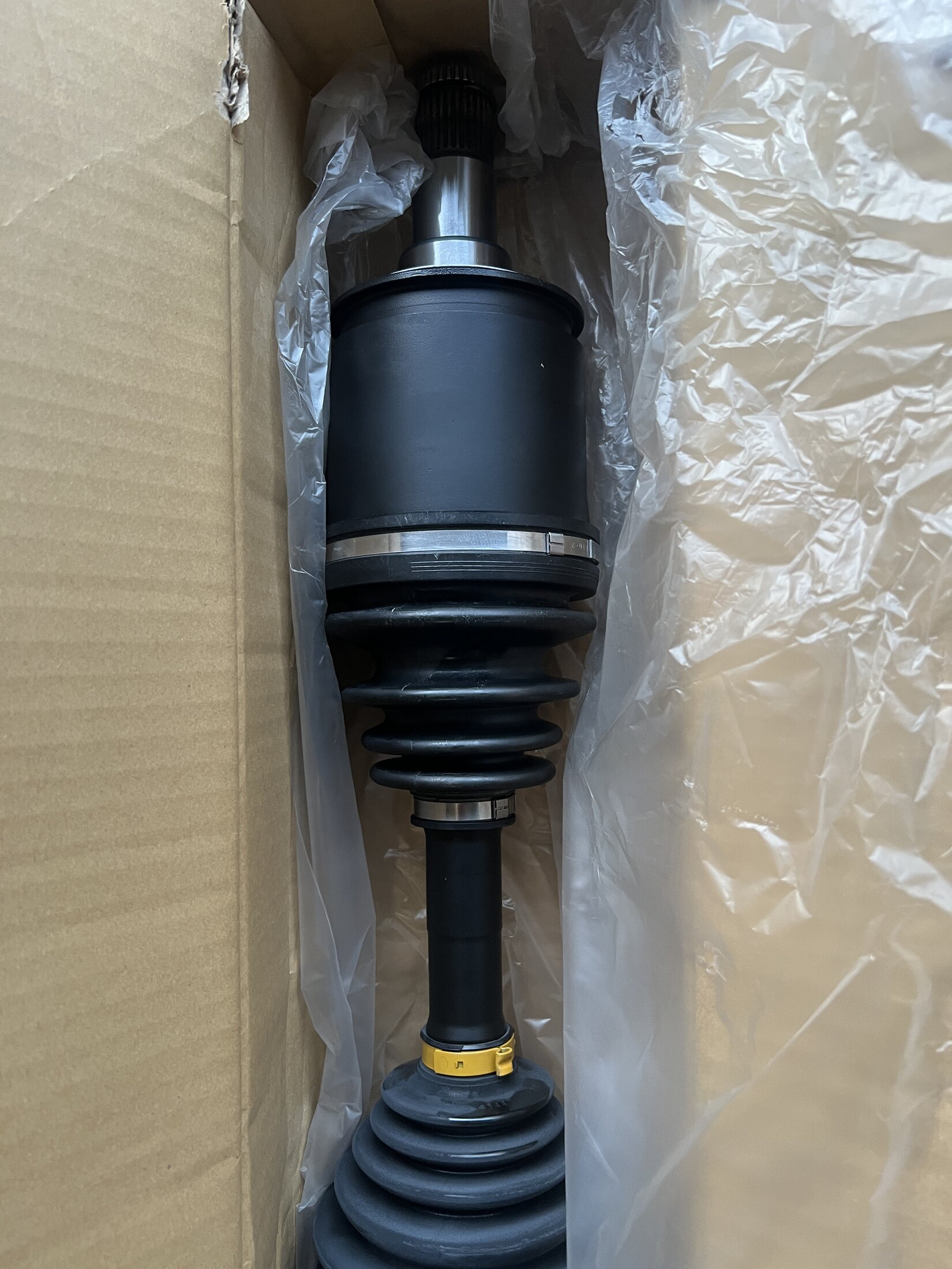

Based on the information that has been sussed out in this thread, it looks like I was mistaken. The CV I have in the box is the reman'd unit from Toyota (which is a Cardone and came in a Toyota box with red printing). I purchased it as a trail spare. I compared it with a Cardone CV purchased on Amazon by a friend of mine for $30 less and it was identical in every way, down to the part number etched on the shaft. It's good to know that new Toyota CV's are available.
