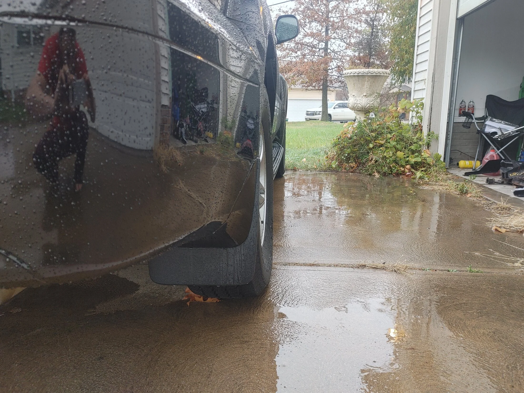

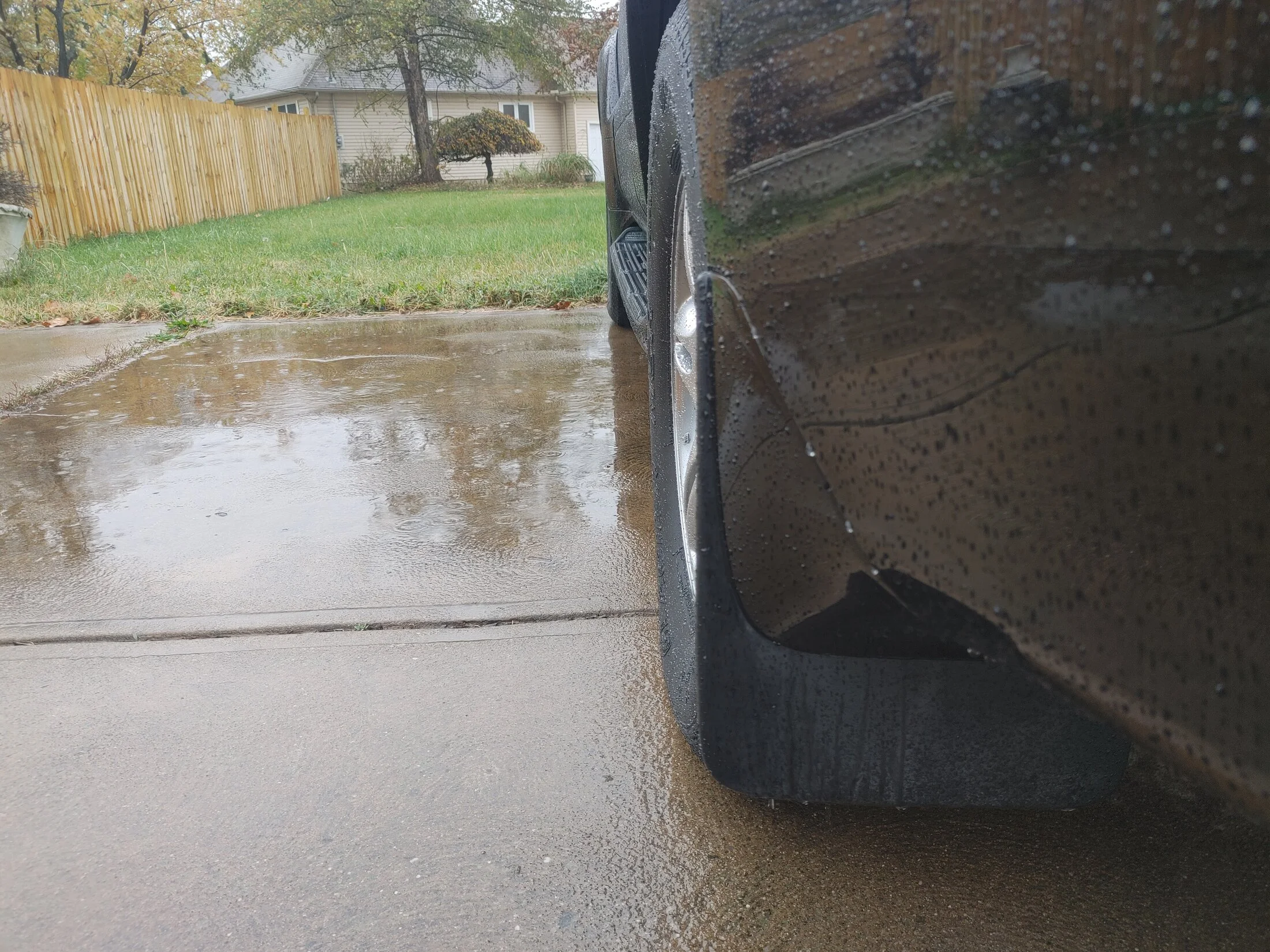

At 200,000mi my rears are definitely sagging into some camber.
View attachment 3769493View attachment 3769496
The dude in the daily thread last week was me so this is the same vehicle. I think it would be interesting to compare, in my case, paying someone $40 every 5k miles to rotate and balance, to not spending that money and have to replace my tires earlier. Would the decrease in tire life cost more or less then all the rotations? I would guess the rotations would cost more but not by a massive margin.
