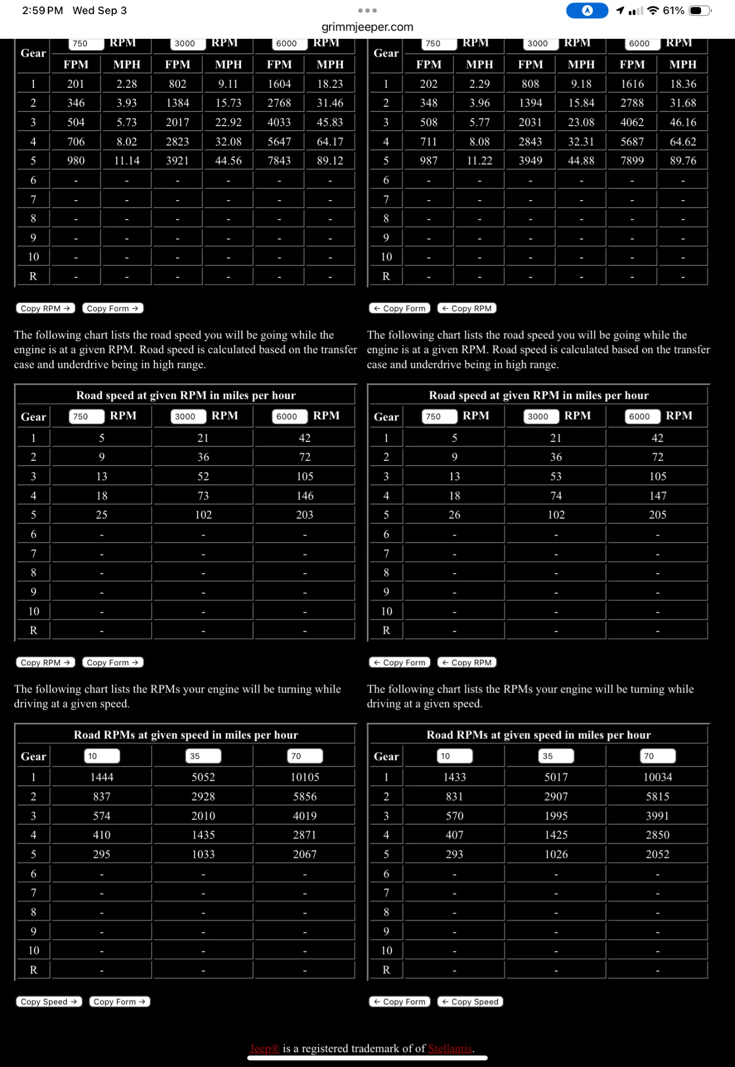

I want to, though I feel 4.56 is way over geared.( 4.10 is actually perfect for 34's and I've never felt I was under powered) per Gear Ratio Calculator - https://www.grimmjeeper.com/gears.html (pics are from there) .64 mph high at 80 with 4.10 on 34's vs 3.73 on stock.
