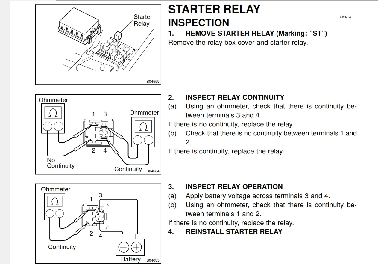

sorry I didn't see this earlier. I don't believe in coincidences. at least not without investigation. Did the battery move when you fit the pole? Remove batt terminals, ensure clean, re-tighten. O'reillys will test the battery for free on the spot. With the starter under the intake, you are hosed there. Without the right place / tools it's a tough job in the hotel parking lot. Neutral start safety switch jogged a bit? Honestly this does not sound like a battery. The starter relay is easy to rule in or out with a cheap parts store meter. You might get lucky - it's an easy fix. See below.
