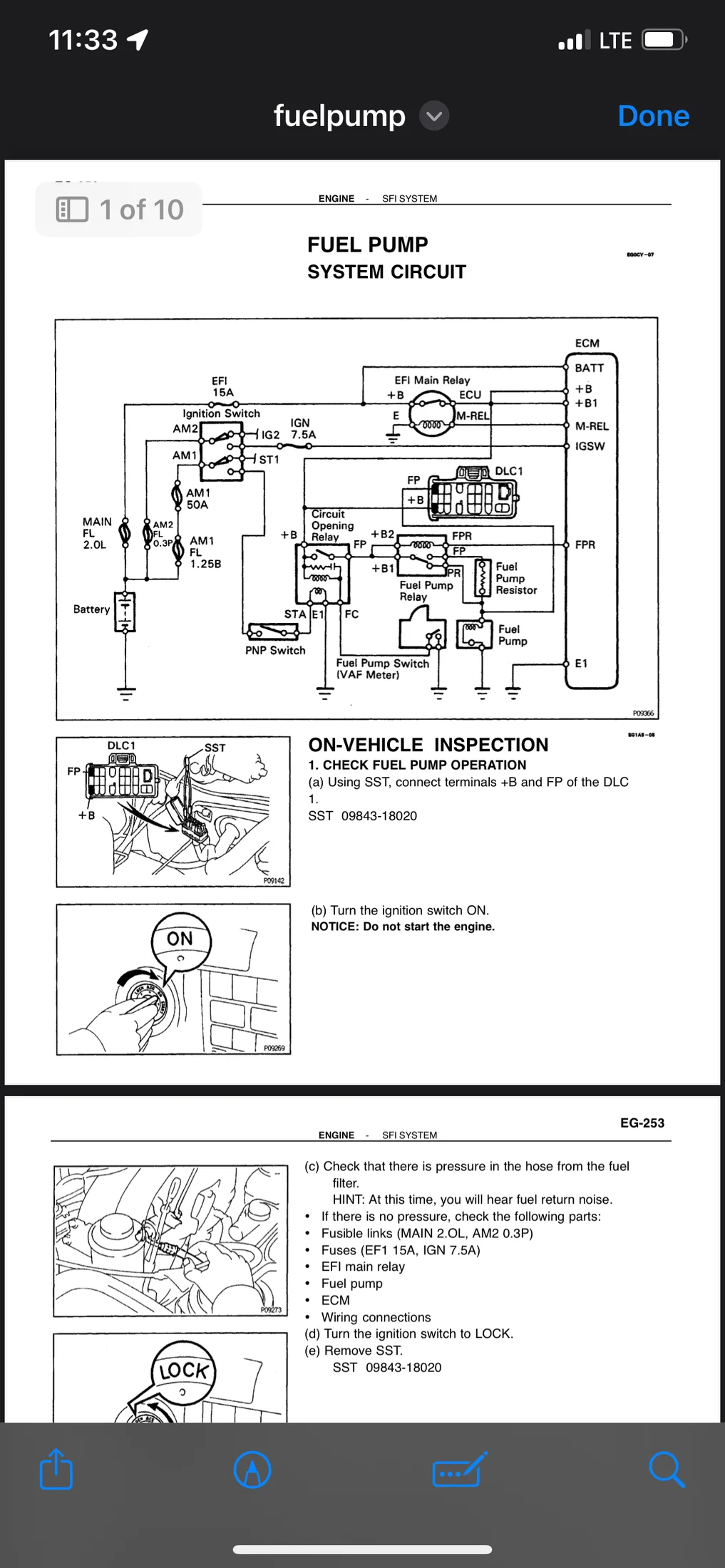

Update. Fuel pump seems to be ok. I got a meter and had no voltage at the pump. I also found that there’s no voltage at the B+ terminal in the datalink connector. This explains why, assuming the fuel pump is ok, the paper clip method didn’t work. I jumped the Fuel pump pin directly and the engine started but stalled and wouldn’t stay running. After looking at the diagram, I realized that B+ from the data link connector comes from the main EFI relay. I jumped the B+ and viola! It starts and runs. I figured at this point the the relay is bad but I tried bypassing the relay and it won’t run. Diagnosis ongoing.

Have you tested your fusible link? COR circuit opening relay? Checks the wires goimg
Into the ECM make Sure none are rubbing. Also check any grounds in the fuel system.
