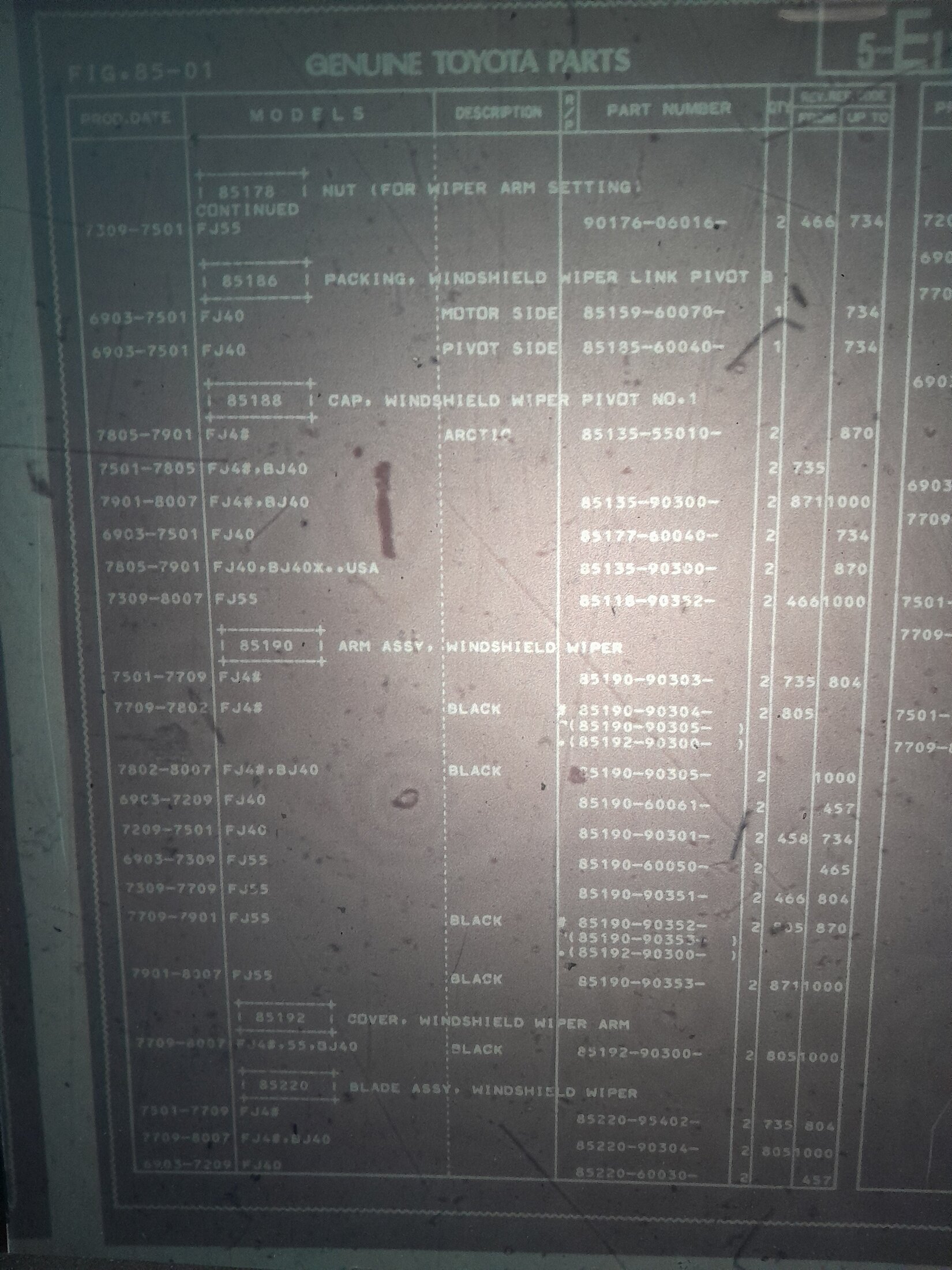

9/72 - 12/74 use a specific arm. P/N 85190-90301. Obviously long NLA.

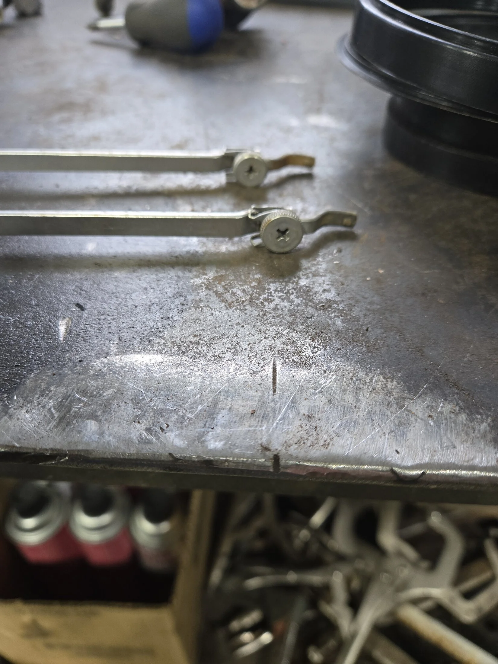

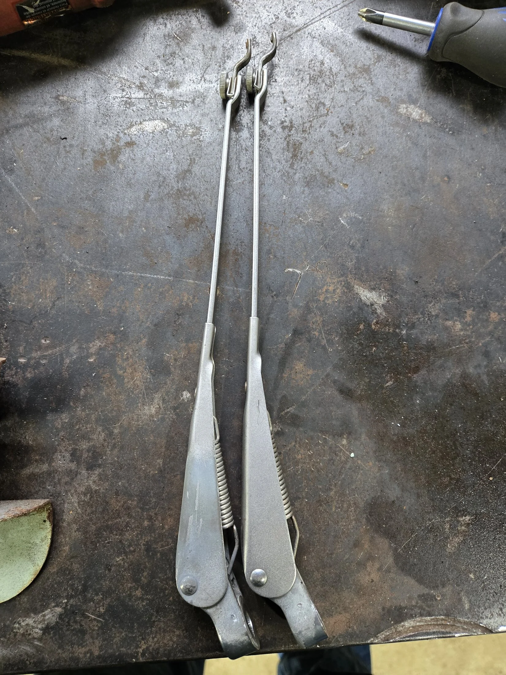

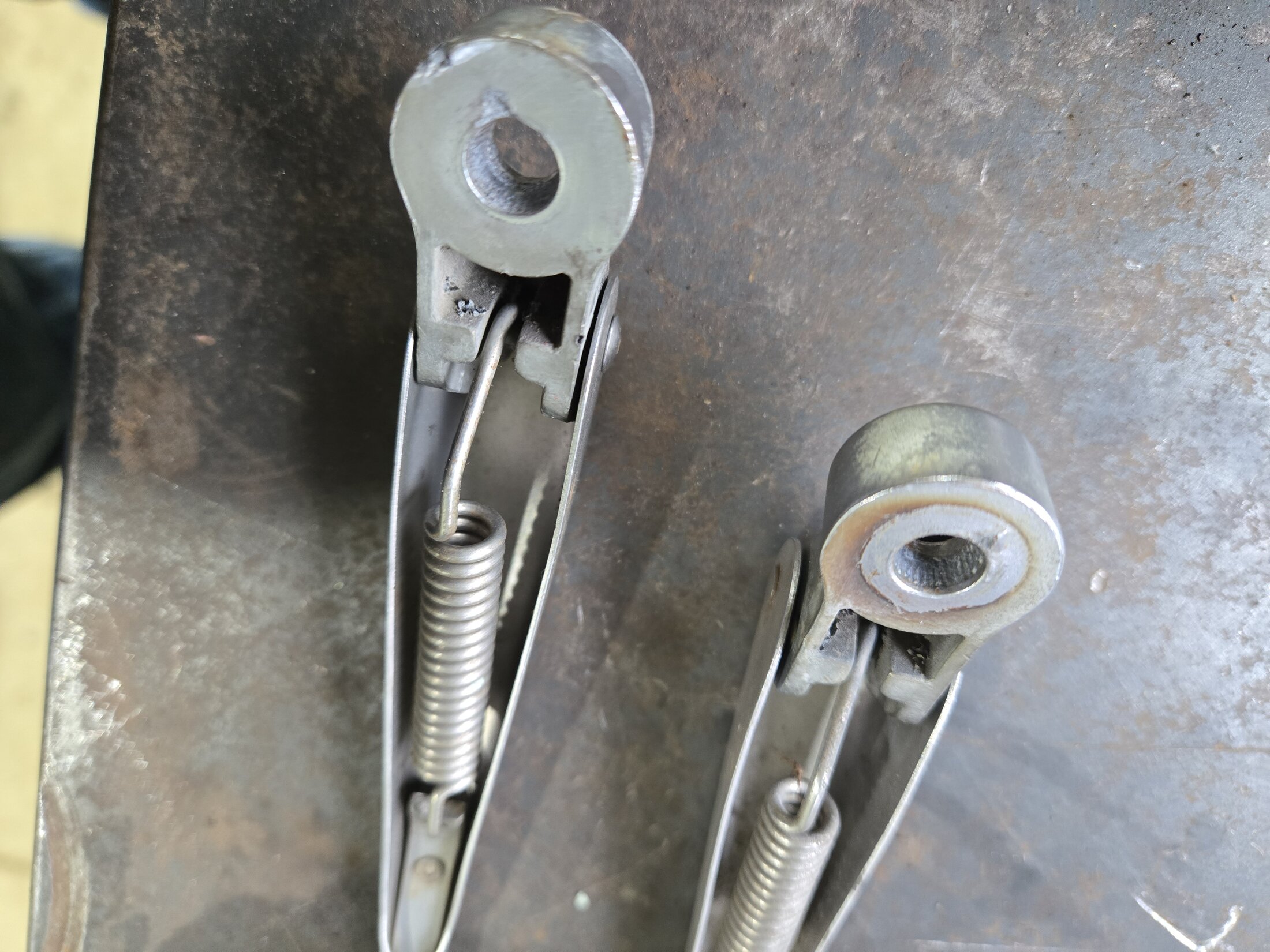

I've got a couple if you're looking for some OEM ones. No blades, just the arms.
Pics
Mine don’t have that big screw on the end.
I think those are the ones that ran thru 1972.

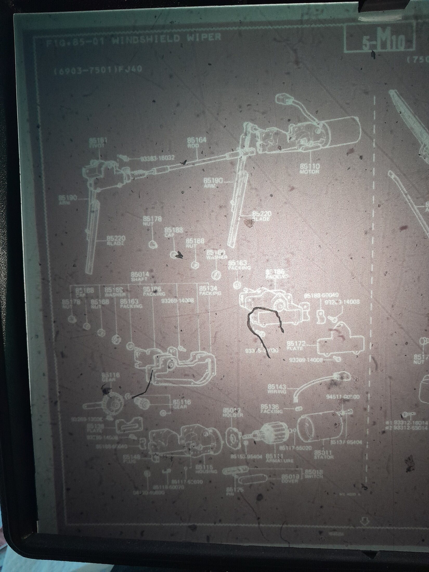

My apologies for the pic quality, but maybe this will help. See part I'D as 85190, "arm assy, windshield wiper". As others have said, I would get in touch with some of the vendors on here or place an ad in the classified section.
They look great. I now know that those are what mine came with is it had one of the wiper arm nuts on one of the shafts. I also have a can of that OEM color. How much and how do I pay you?

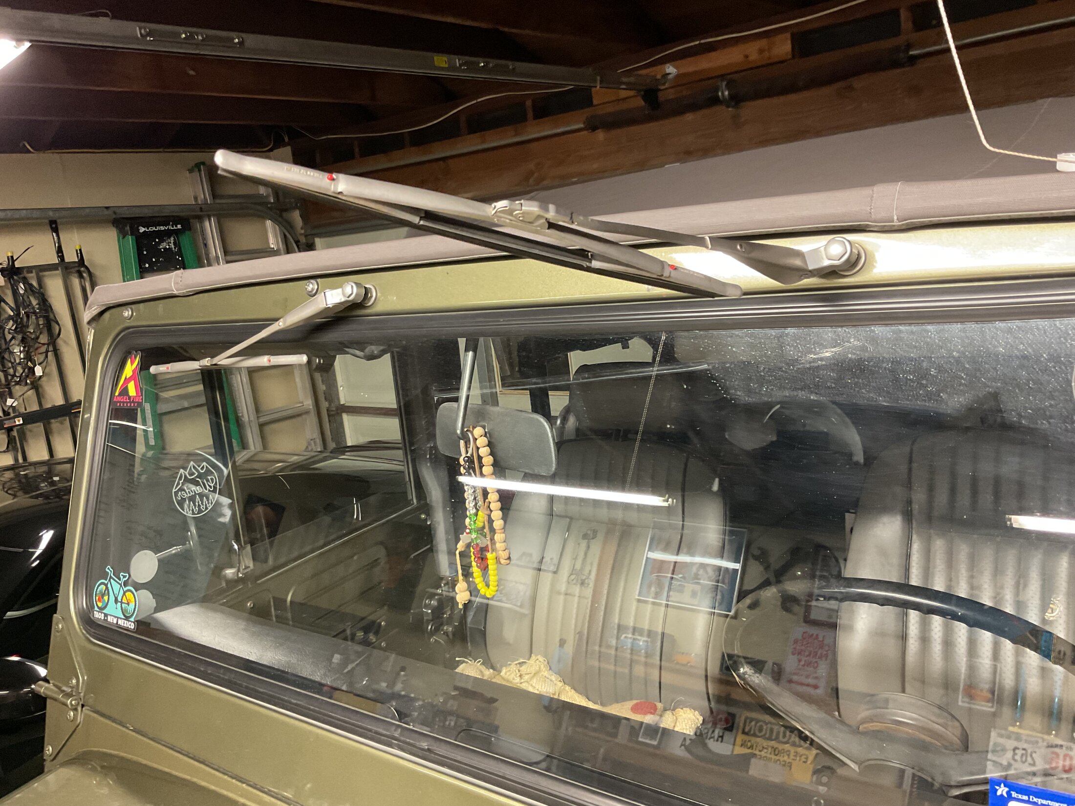

Yes, these are my original 1974 wipers.
