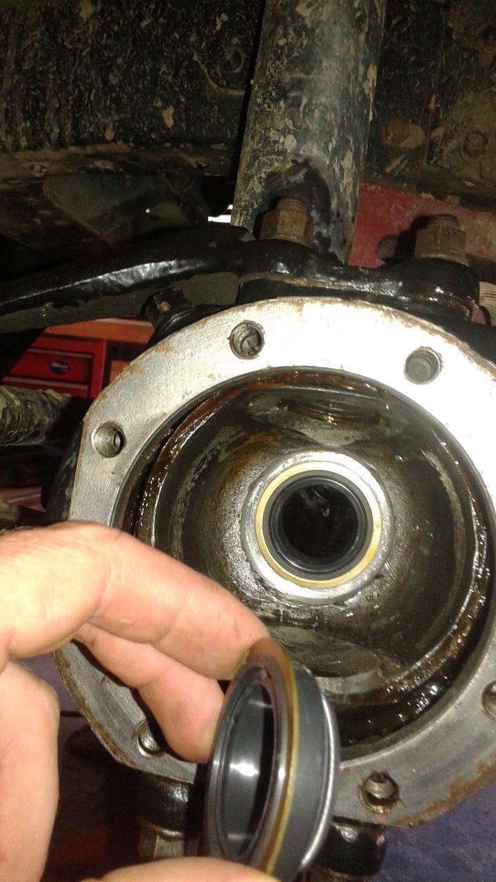

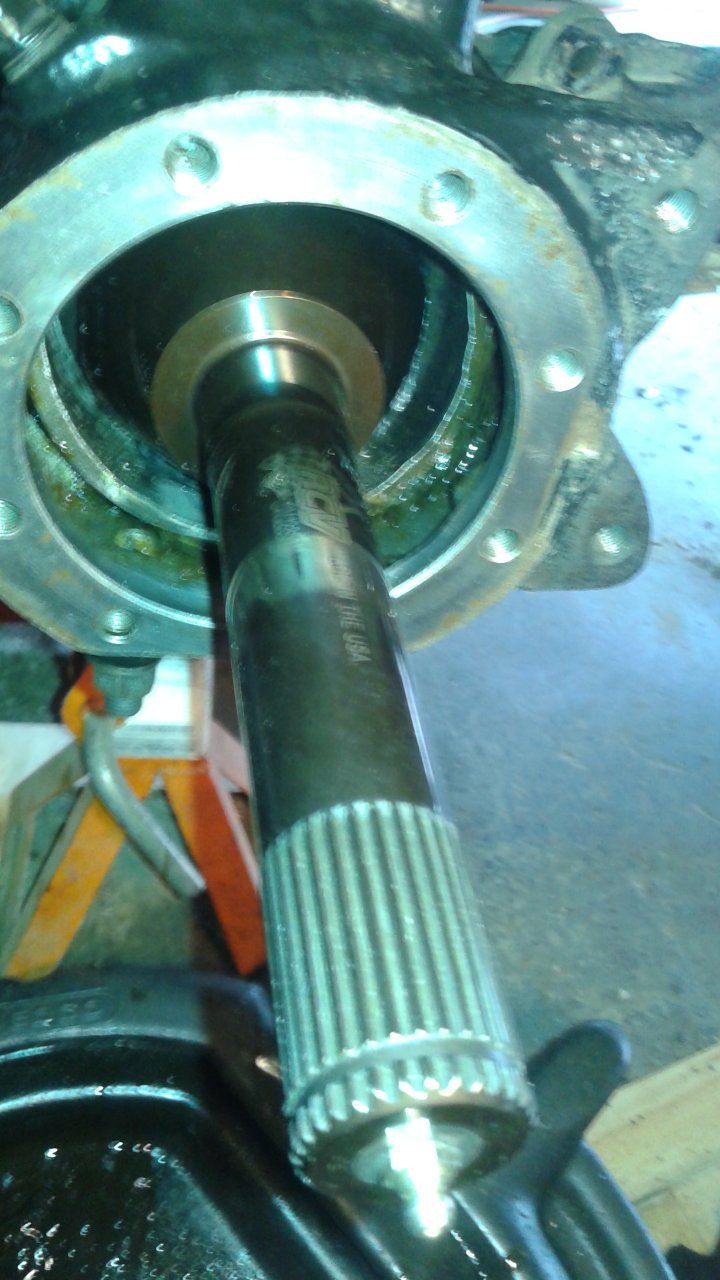

im now a happy man , poor but happy :beer:
