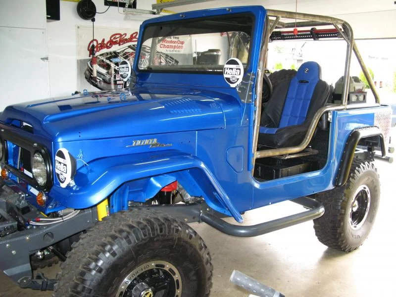

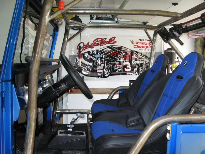

I am looking to put in a full roll cage from Metal Tech and mounting the seats to it like the ones shown in the picture above. I will do a little more research on the Corbeau seats before I make a final purchase. My FJ is a 73. Will the gas tank be an issue if I have to lower the seats a little?
i did the blue one took out the tank. the seats sat to high for me felt like i was looking over the windshield. could not lower them with the tank in. happier now
