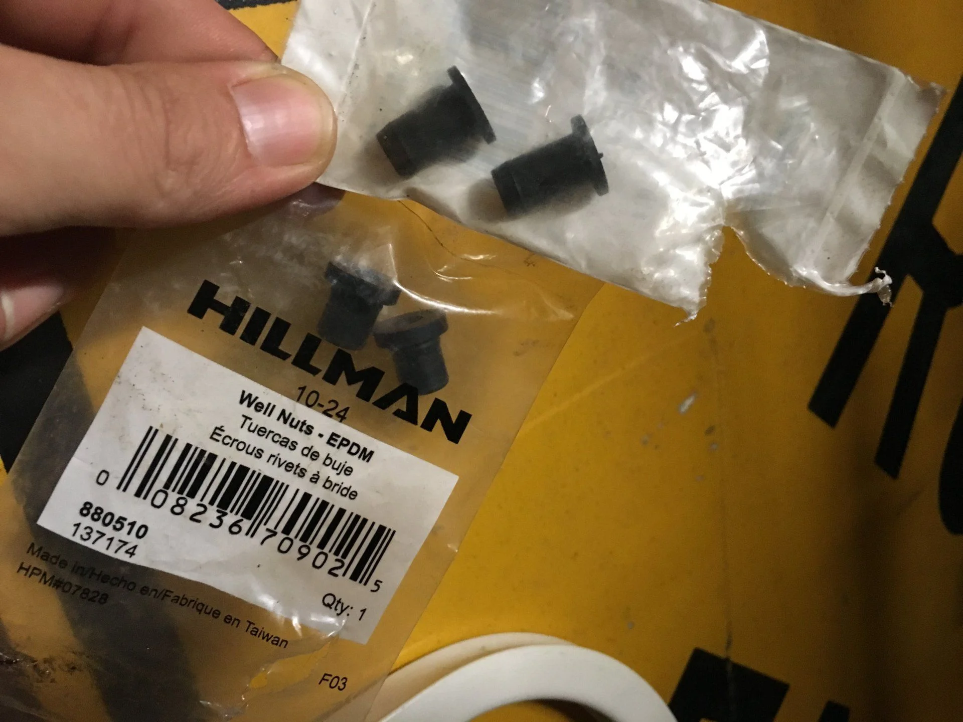

I have several sizes and mfg’s in the cabinet but its likely 10/24. the hillman brand are listed as epdm and look nicer and thicker than the Crown Bolt inc. ones. They are also shorter which comes into play with the sunroof. I *think* i used the hillman #137174 (might be a depot #) but not sure.
The other i have is 8/32 but it looks to be too small. Remember to size your bolt to be just long enough to grab the first thread or two. It will pull the rest up but too long and you have sunroof issues.
So the shorter one does miss the sunroof? Or is it a problem to remove and replace if it is the wrong size? I welded some of these shut on a friends truck and a little weld rod stuck in too far and kept the sunroof from closing once opened. Easy fix without the liner out but I don’t want to run into that problem with my new truck. I plan on keeping the liner in on this one. I got really lucky I guess with my first truck when i silicon bronze welded my holes shut without removing the liner. I have since learned I almost burned my truck to a crisp. I am bolting these new ones but want to use the right size for the sunroof. Also, if I drill out the nuts from the outside, is there a chance they could get into the sunroof mechanism or just rattle around in there or do they just quietly go away??
