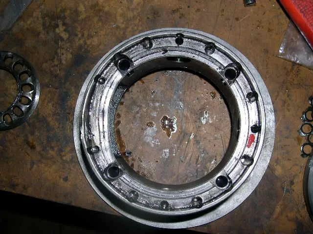

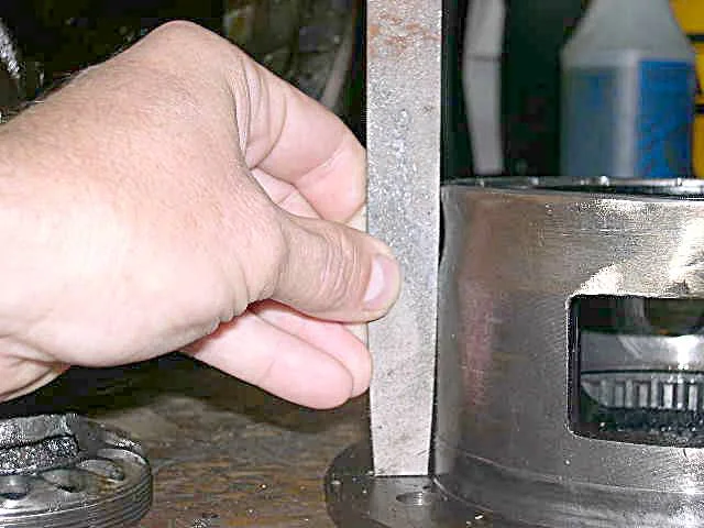

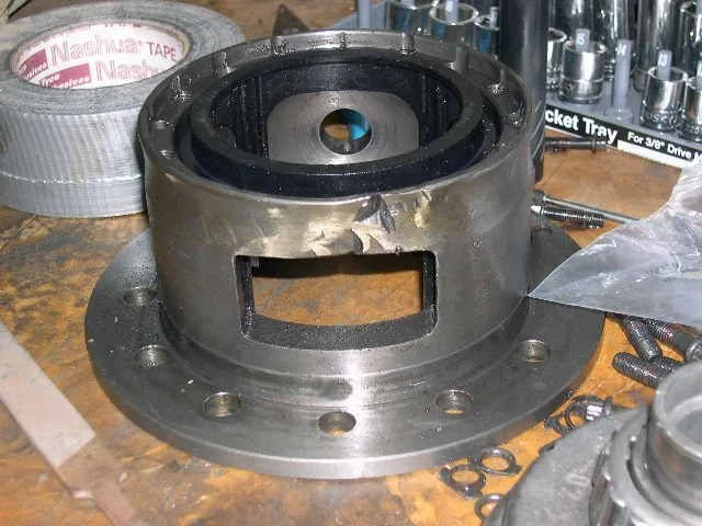

I've got all of the parts to rebuild the locker - which I buggered up in Moab. I'm going to send a pair of rear axles to Performance Cryo. And then put it all back together - hopefully until winter 05...
Here's the old ARB case...
attachment.php
attachment.php
attachment.php
If you look at 9:00 on the last picture you can see wehre the case is out of round...

I am replacing the diff case, the cross pin and all of the o-rings and seals. It is still much cheaper than a new locker. Tim Lund @ ARB USA really came through for me. And I am now much more knowledgeable about ARB Lockers. Between this and the field repair school that you held in South Dakota - I'm in pretty good shape!
