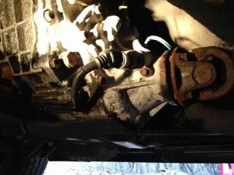

One other thing the original poster mentioned was no VC (viscous coupler). Is your truck somehow not full-time 4wd? All USA FJs and FZJs came with a VC, Which facilitates the full time 4WD. Some have been removed to install a part time system. This would be the only rarity I would identify, if it were factory. The only other reason not to have a VC is simply if it seized and is always active. (Not good in full time 4WD).
She is full time 4wd. I was having problems previously with the center differential not unlocking. Driving was not pleasant. I traced it down to a faulty center diff actuator. Found one in pristine condition from a junkyard for under $100. Lucky.
Anyway back when all of that started I thought it could have been a seized VC but beno and others said no based on my transfer case. See below.
FJ80's don't have VC's.
