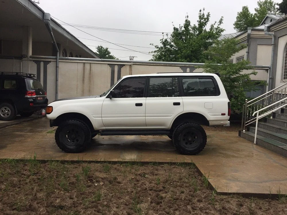

My whole LC is raptor lined. I really like it. Very easy to clean and easy DYI paint. I like the spray gun over the spray. My LC is a daily driver, and some overlanding. I don't crawl so not sure about dents but the paint is pretty tough
