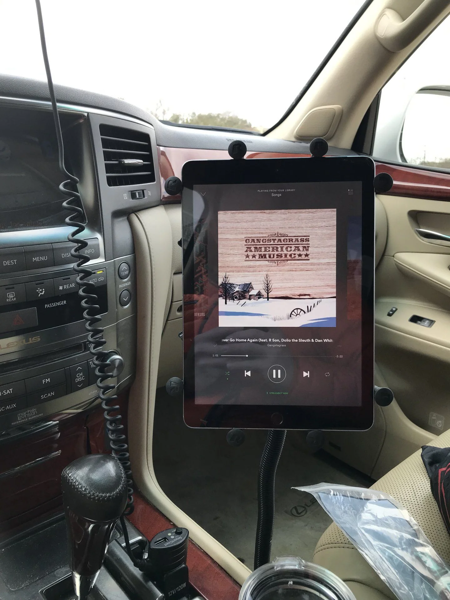

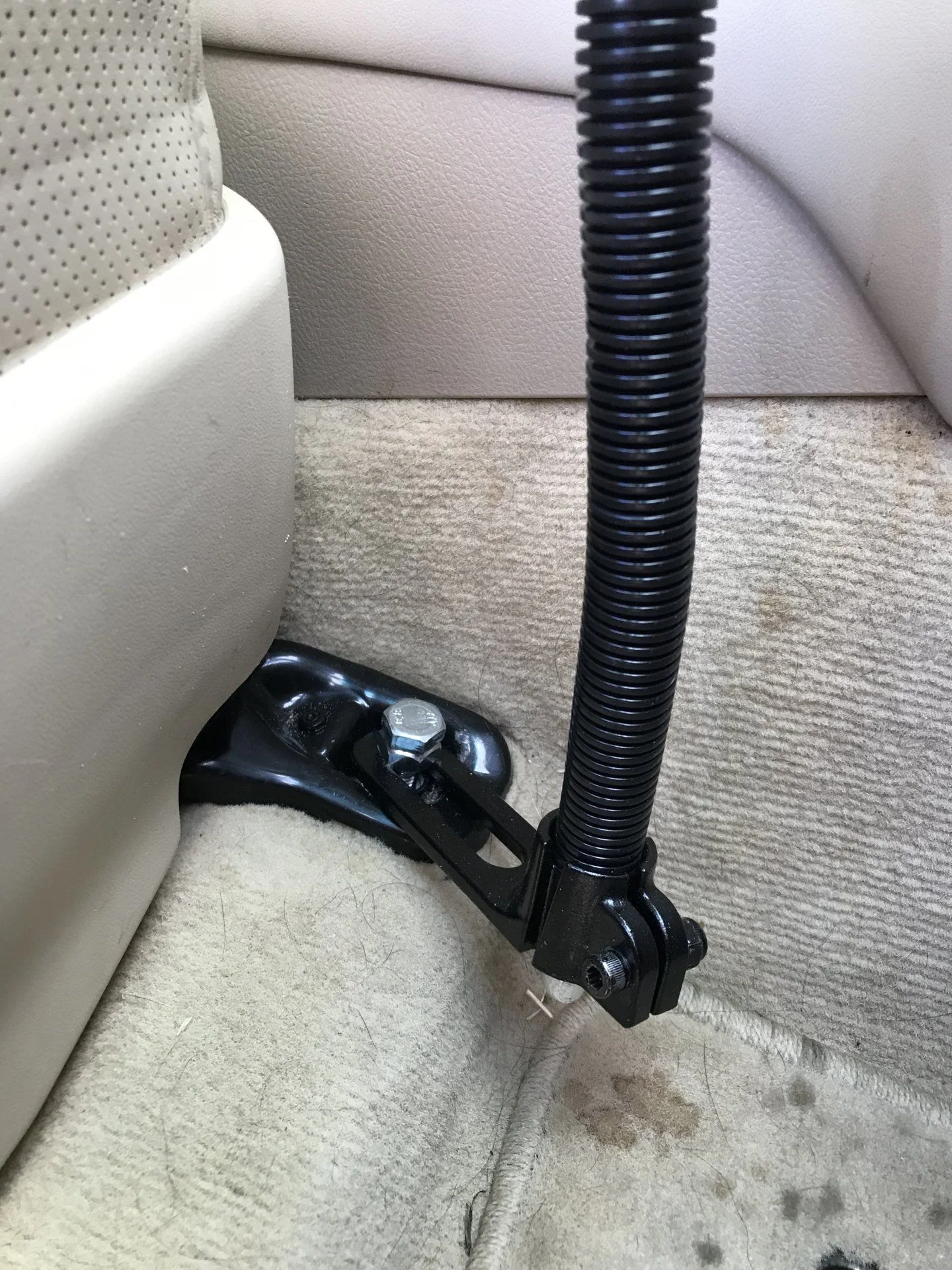

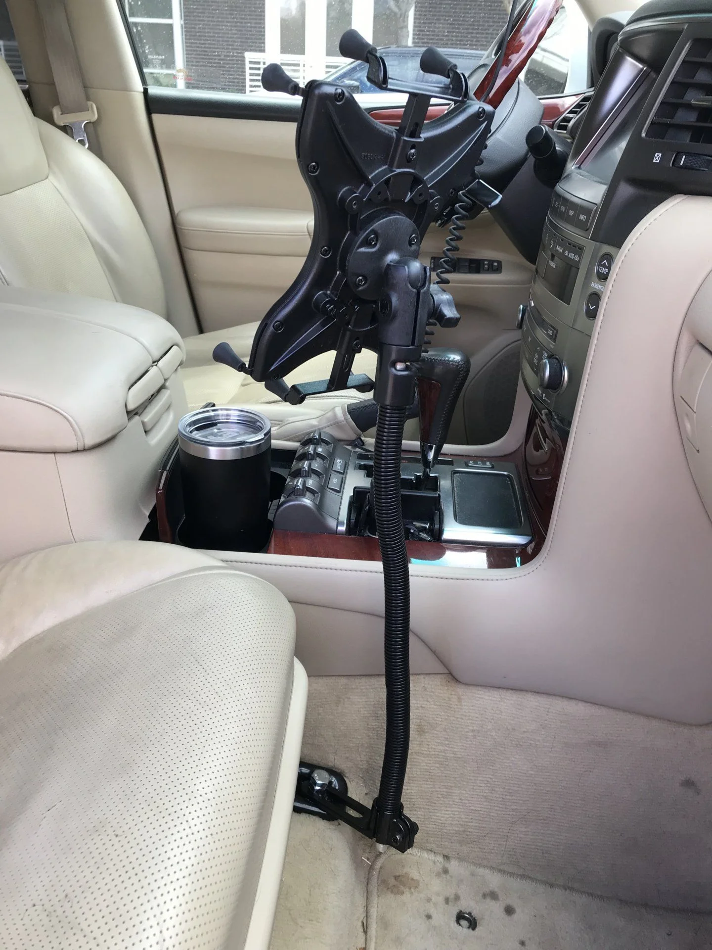

Can you post a photo from your rig? I’m curious what it looks like and where it attaches. That link is just the arm, what other pieces do you need?
As soon as I get to the truck I'll post one. You'll need a longer bolt (quick and cheap trip to the hardware store) and the Ipad cradle. Those two pieces are all you need beyond allen keys and a wrench to assemble.

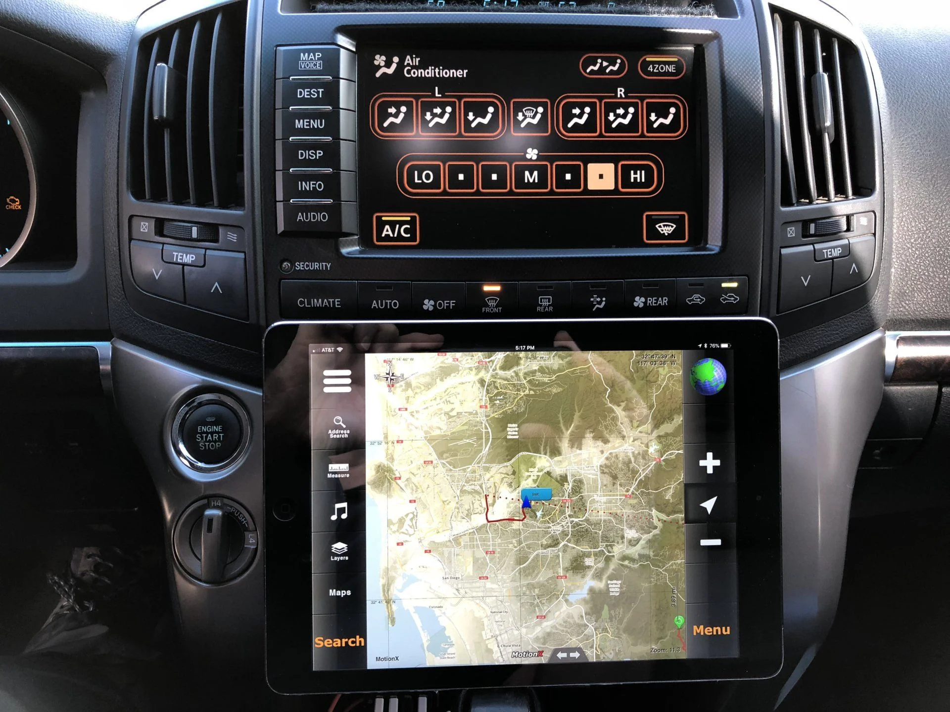

I stuck a couple magnetic mounts on my dash -- Markuson turned me on to them. The two mounts held my iPad secure even while going up and down Imogene.
Ya, if you have the early version of the 200 dash, four magnets mount an iPad over the CD player area (which I never use) and it is 100% movement-free.

Movement of the tablet is minimal Offroad. The flexible arm is an alloy that does a good on of staying put but flexible enough for ideal placemwnt
perfecto....yes I think that is the one I have seen before and was thinking of. Thanks.....
I have this same mount on my 100. Worked well but shook too much off road. I added a c-clamp to secure the arm into center console, effectively cutting in half the unsupported distance of the arm. Now it works great. Another nice benefit is that if you don't completely tighten the bracket at the arm but rather leave it pretty snug, you can rotate the bracket and Ipad b/w passenger and driver.

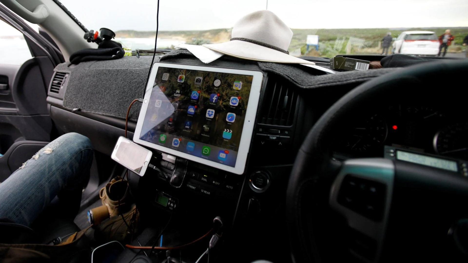

No mount needed. Ipad cover shoved under the dash mat. Couple of bulldog clips used when offroad. Runs HEMA maps, Netflix, View attachment 1883632
Similar to what I did before I switched to this using magnets:
Zero movement, and only blocks my unused CD player.
