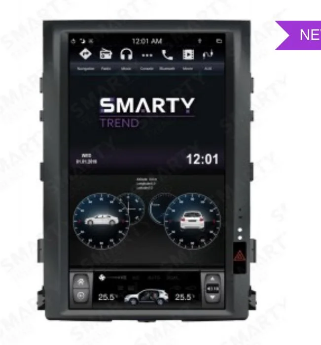

through and there is an added bonus to have waited. Earlier it was a 4K transfer case on my Mercedes GL320 CDI which was bad enough until I took 20ft fall off of scaffolding to which I am still recouperating. On a more positive the Smarty-Trend unit that I had planned to purchase after all my research has a new upgraded model The new model has an upgraded chip, memory and operating system. I was also surprised to see they have added a Apple Car Play module on the page that the LC modes are listed. I am very excited to place my order next week. Need the last of my Birthday money on Nov 16
Toyota Land Cruiser 200 2008-2015 High and Low End (Tesla style) Android Car Stereo Navigation In-Dash Head Unit
Toyota Land Cruiser 200 2008-2015 Android In-Dash Car Stereo DVD... - SMARTY Trend™ Company
They still the older model so I will be reaching out to them if they have had and experience with differences in the upgrade.

So I contacted Smarty Trends with quilestions about there new models. They are called ultra vertical and touted to be more ergonomic to use. They directed me to this page on there aight and as fate would have it all models of the Landcruiser are included in the new ultra vertical model with an updated chip and operating system. SMARTY Trend Evolution - New Ultra-Vertical Screens! - Info-blog, news and video reviews about Android In-Dash Car Head Units
Take a look and see what you all think. I will be placing my order this week and doing an unboxing for everyone. Don’t expect the full produced unboxings like you see on YouTube who try to make a living out of it. I will be purchasing a appleplay dongle/ canbus reader and a parking brake bypass. The only thing I think will be an issue will be the rear DVD. But that is another animal to tackle late in the game.
Let us know how it goes. There's a whole list of things I'd like to see and I suspect XM, rear DVD, windshield de-icer, and some other features will all be lacking unfortunately. Still it might be "good enough" for most uses.

The one thing that concerns me from SMARTY's website is that it says Android cold-boot takes 20-25 seconds. Is that on every engine start? If so that means you need to sit there 20+ seconds before the backup camera will work...
