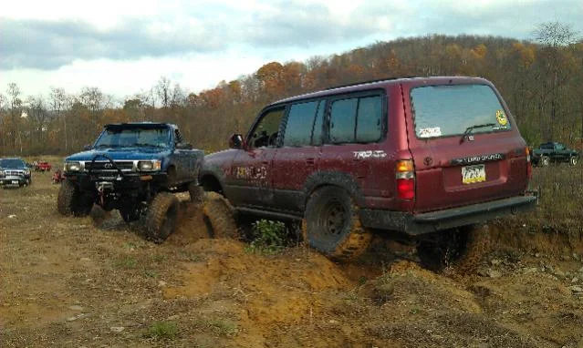

I run Slee's 4inch lift and love it.. Im adding a 1in spacer up front to level it out also.
315s will fit under a factory height 80. in most cases. IMPO the 2.5-3" lift looks great with 315s any taller and its time to go to a 37"

I run OME J's front and rear with a 1" spacer in the front and 35x12.50x15s with a 3.5" bs wheel and 1" wheel spacers, works great!, no rubbing and no bump stop extentions either.
This is on a 95, so anyone that tells you you can't run 15's on these trucks are flat out wrong.

None at all, just extended brake lines, slee cc plates, drop brackets for the rear swaybar, took the front off, and that's it.
I do have a heavy rig, about 6500# and a lot of weight over the front, winch, duel batteries, bumper, sliders, etc.
But also have a rear bumper and drawers full of tools in the rear, it sits 100% level, no stink bug here lol.
