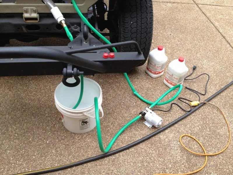

When I opened the drain block it was crudded up pretty bad. Took a while to break through. The old radiator had some previous damage (looks like the fan blade must have broken off at some point). I wonder if the PO dumped some radiator stop leak in there. Anyways I was thinking of running something through the block before installing the new radiator, water pump, and thermostat. Maybe use the pump system below to clean it out. Any suggestions on what to run through it (water, vinegar, muriatic acid)?

Any kind of weak acid will help get out deposited minerals from running tap water in the past. Acetic acid (vinegar) is very weak; if you use that, get the 7% acidity cleaning vinegar available at Wal-mart and elsewhere and run it straight (undiluted). If you use muriatic acid, be sure to dilute it to a safe level. Let your recirculating system run with the weak acid solution for many hours for best effect.

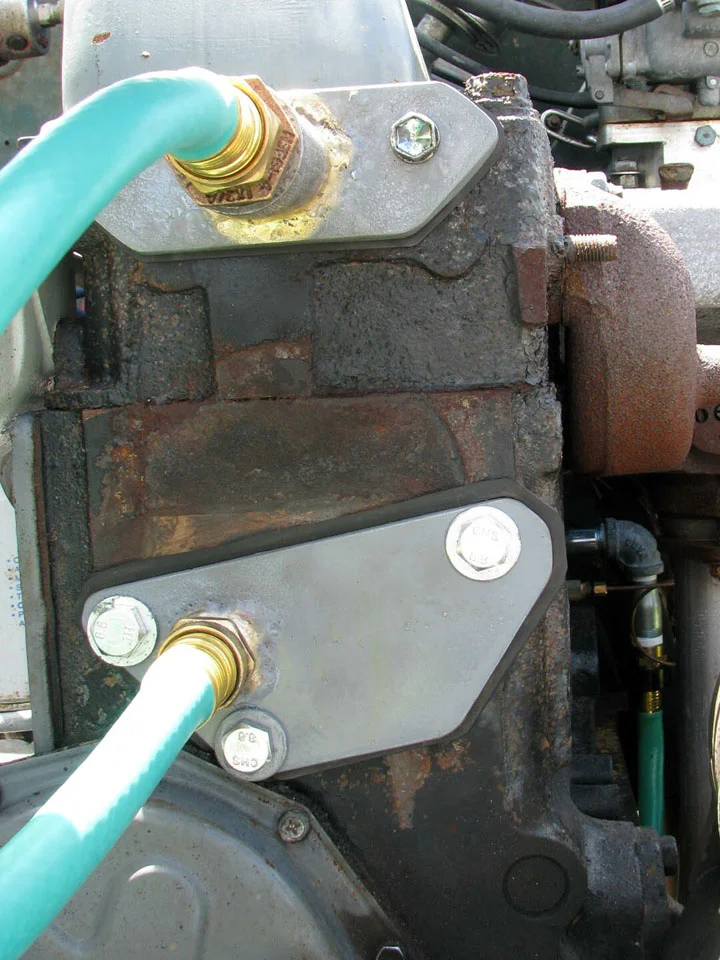

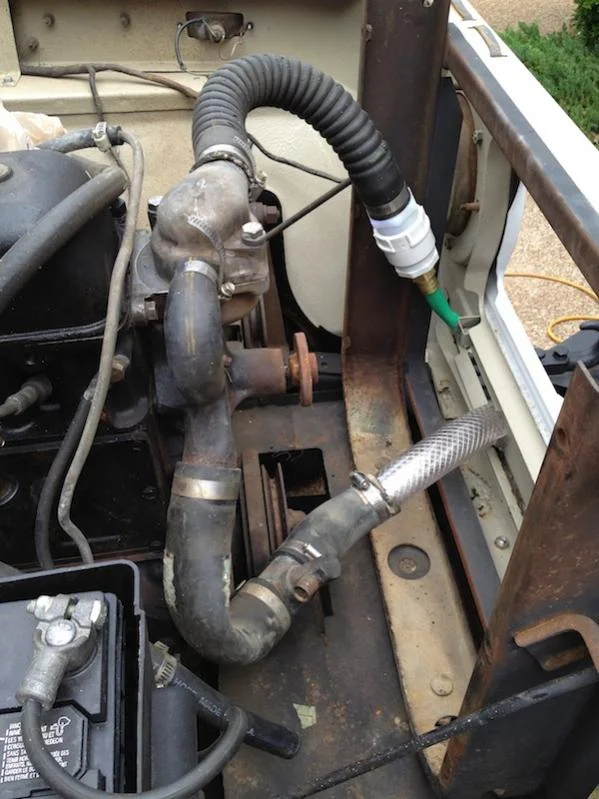

If you can fab up some fittings so you can remove the water pump and T-stat housing. You will get better velocity with the flush and not damage those items with the acid. Velocity does help. And with those items removed, you can get a peek inside to see what shape the cooling jacket is in.
