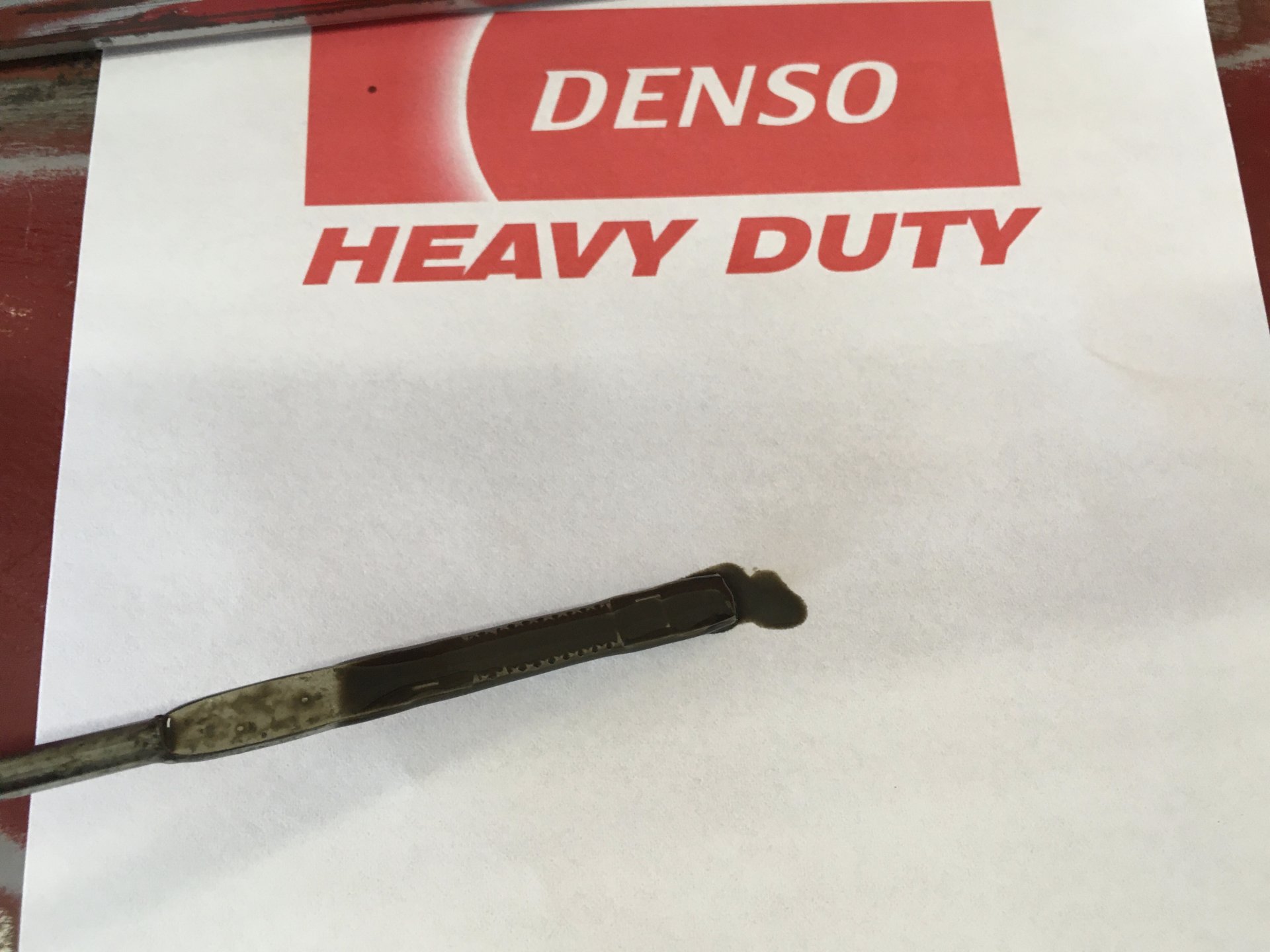

Oil was at/below the L on the dipstick, but after run and coolant dump a couple of days ago it looks like the overflow coolant added itself to the oil after cooldown vacuum. Hadn’t seen this before.

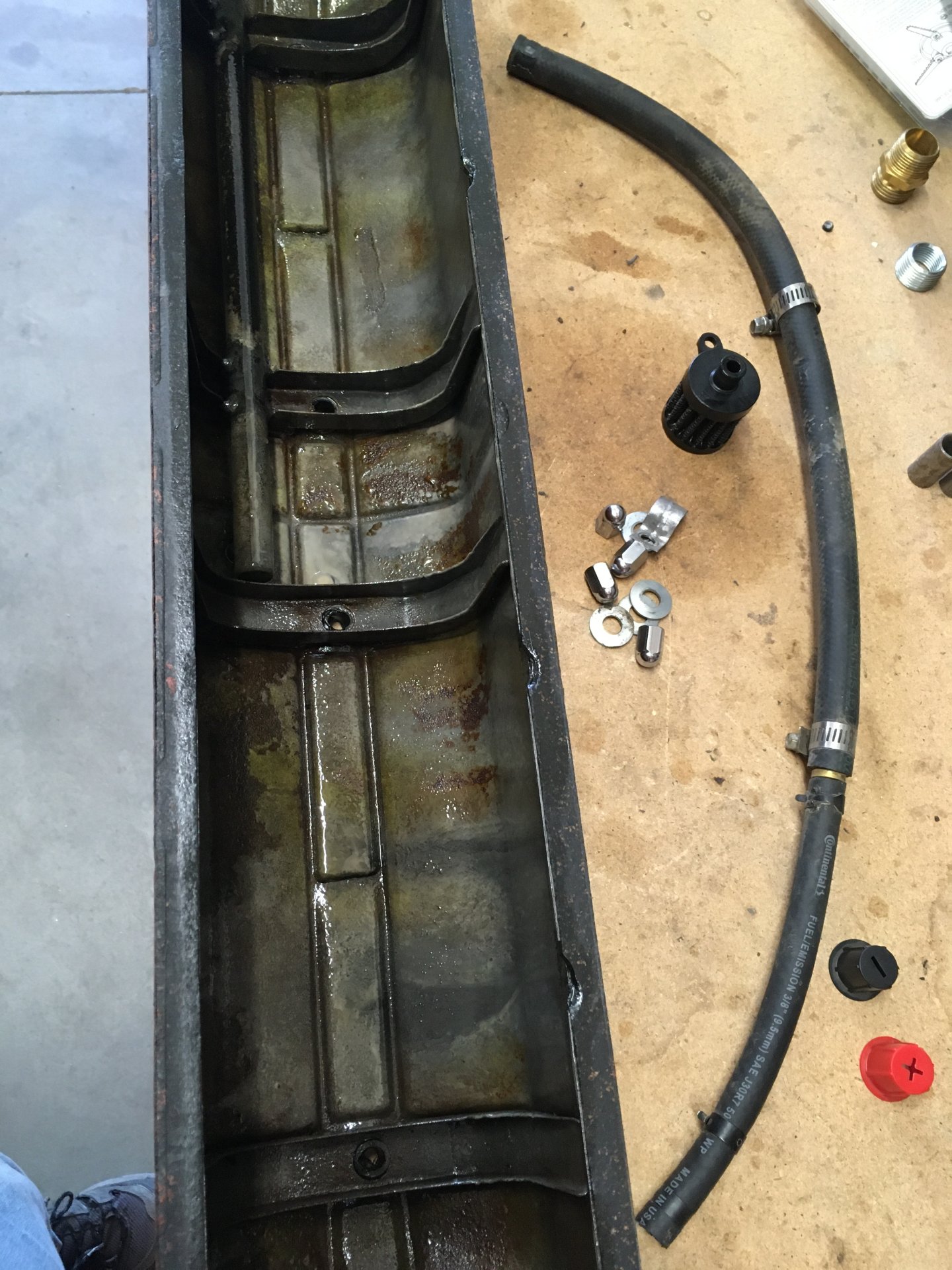

Some mildshake residue on the valve cover, I saw this the last time i pulled it (but there was no coolant in the oil then).

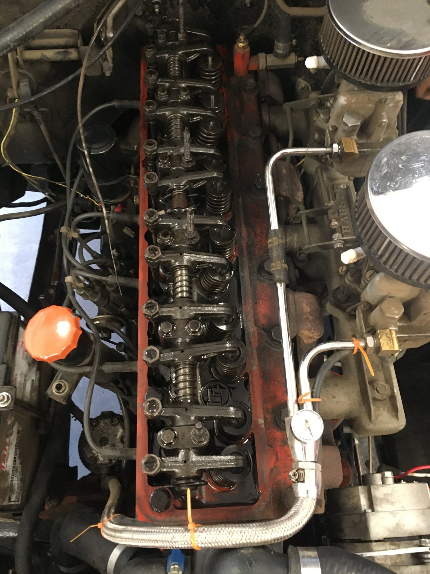

Rockers are all getting oil, a little bit of milkshake thickness to it in places.

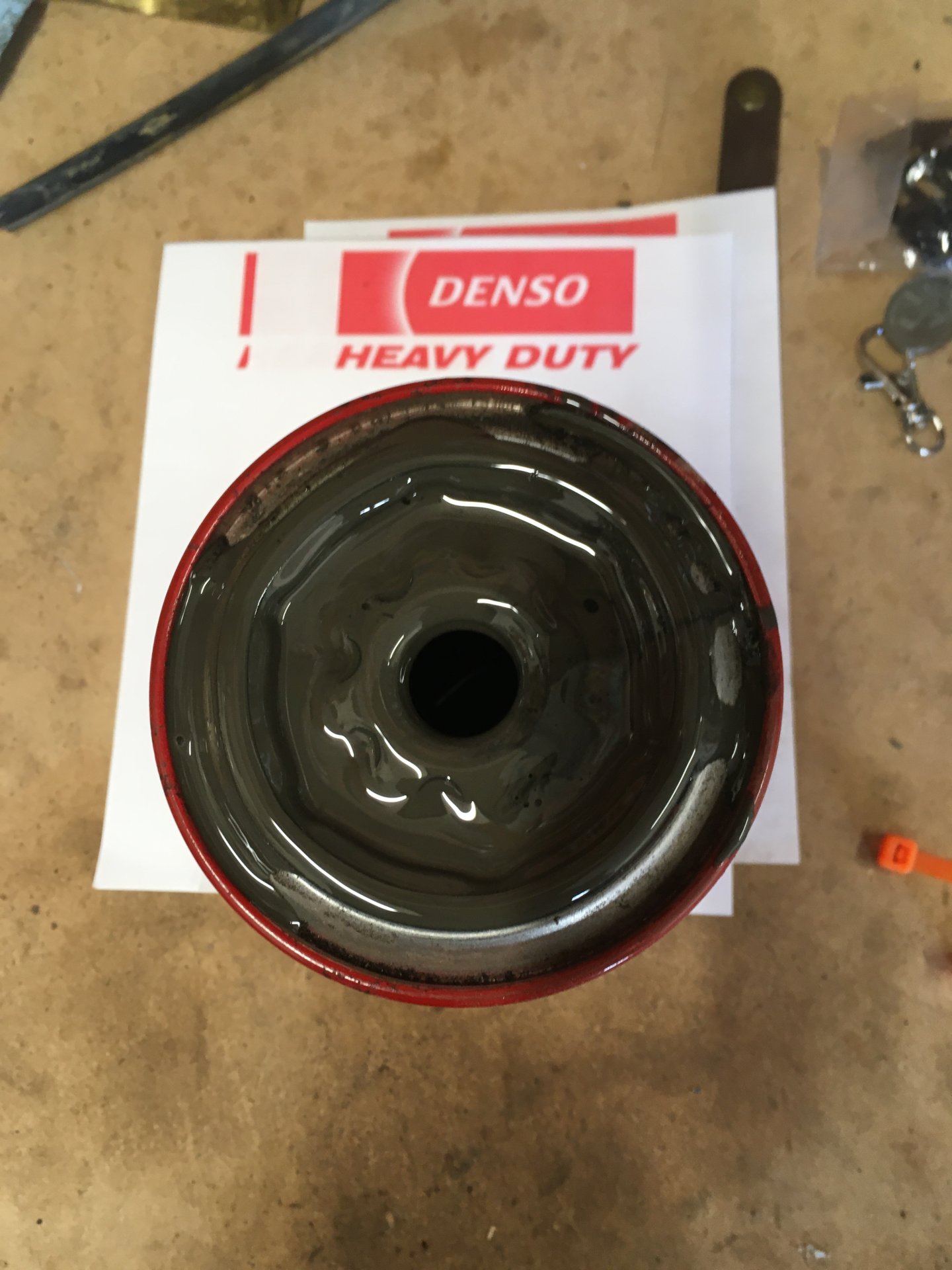

First thing out when the oil drain plug was pulled was coolant, then oil (no pics of that enjoyment). Oil filter was full to the brim with wonderful chocolate milkshake, Yumm!
