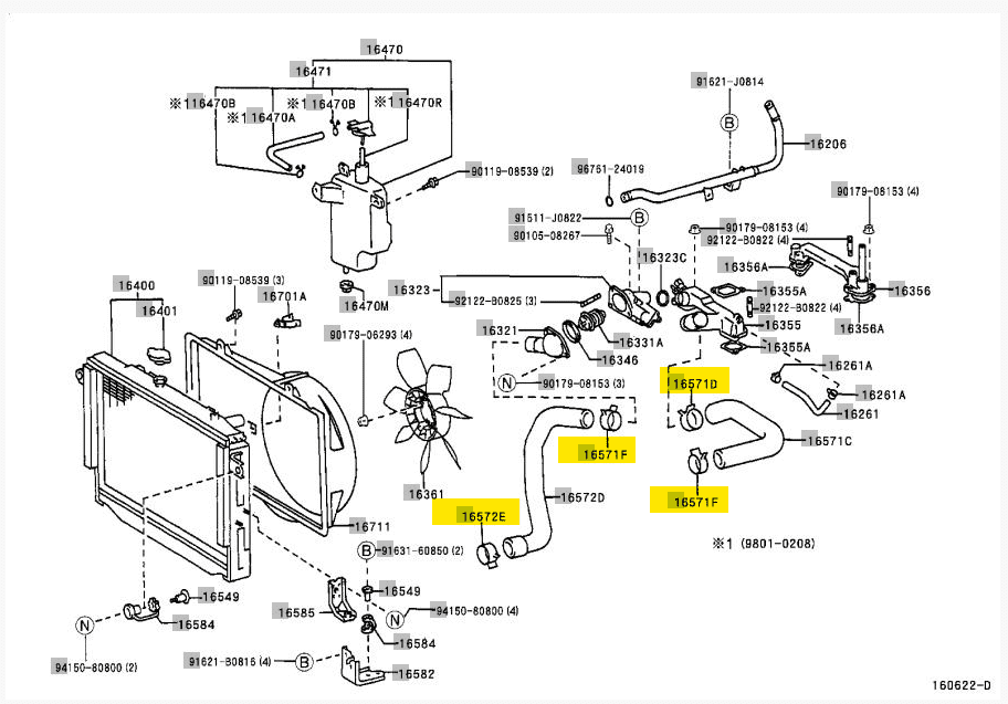

So I am in the same dilemma. I bought the clamps from Wits End. They recommended two medium and two large, but don't say which goes where.
You say the top clamp is slightly smaller than the bottom clamp on the lower radiator hose. @2001LC also says the same thing...that the lower radiator hose has two different size ends.
Maybe I am misunderstanding things, but I thought the LOWER RADIATOR HOSE was the long one that goes to the bottom of the radiator from the thermostat assembly, and the UPPER RADIATOR HOSE was the short one that comes off the radiator at the top?
To further confuse things, according to the parts diagram, they show 16572A is to be used at both ends of the long hose, and 16571A is to be used at both ends of the short hose.

I was looking at a Toyota parts page earlier, but I managed to find a Lexus diagram and these are the parts referenced. The thing is, I ordered two of the larger clamps and two of the smaller clamps. It looks like from the part numbers on this diagram that I need to use the same smaller clamp on all the hose ends except the lower one on the long hose, as that one uses the larger clamp. Can someone confirm this? Hopefully this can help people looking this stuff up. I am just weird and anal about stuff and want to use the new OEM clamps because they are designed for the vehicle.
9046743002 LONG HOSE LOWER, LARGE CLAMP (16572E)
9046641008 LONG HOSE UPPER, SMALL CLAMP (16571F)
9046641008 SHORT HOSE RADIATOR SIDE, SMALL CLAMP (1657D)
9046641008 SHORT HOSE INLET SIDE, SMALL CLAMP (16571F)

Ok, so I replaced all four clamps using the following parts on my 99 LX
9046641008 x3 (upper radiator hose, both ends, plus lower radiator hose, top end)
9046743002 x1 (lower radiator hose, bottom end
Bought two of each per recommendation on Wits End for $25 I think. Since I needed three of the smaller clamps I went to the dealer to pick one more up and it was $10 by itself!! I wish I wasn't in a hurry!
What threw me off was that if you look at any stock picture of an LX engine bay that hasn't had any cooling work done, all the (small) upper hose clamps are silver. When you buy the small clamp now it's black. The bigger clamp that attaches to the lower radiator hose bottom is now silver.
Bottom line, they worked and no leaks. I feel better with the spring tensioned clamps vs the screw-on type that were on there before even though both are probably fine.
These are the correct number of clamps, as mentioned. Just ordered myself from partsouq.com
